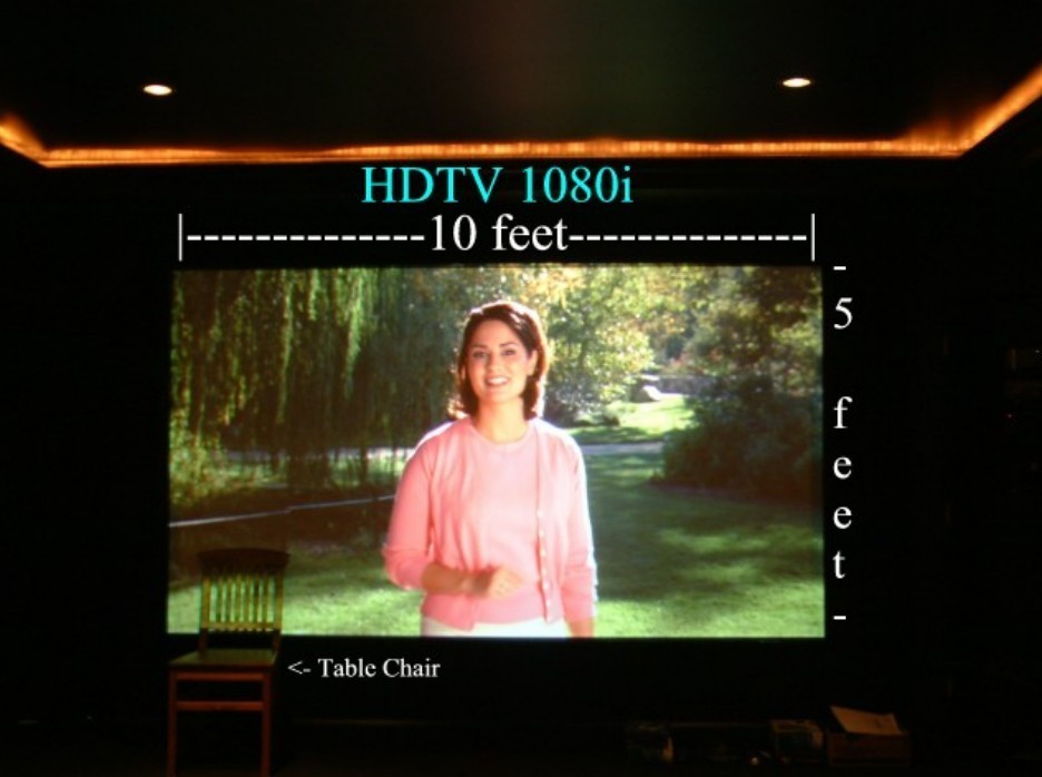

I hope you are right, but the seller did put this pic in his auction.
However, that pic does look very familiar.
I swear I have seen it some where years ago.
Maybe he just grabbed it from the internet?
