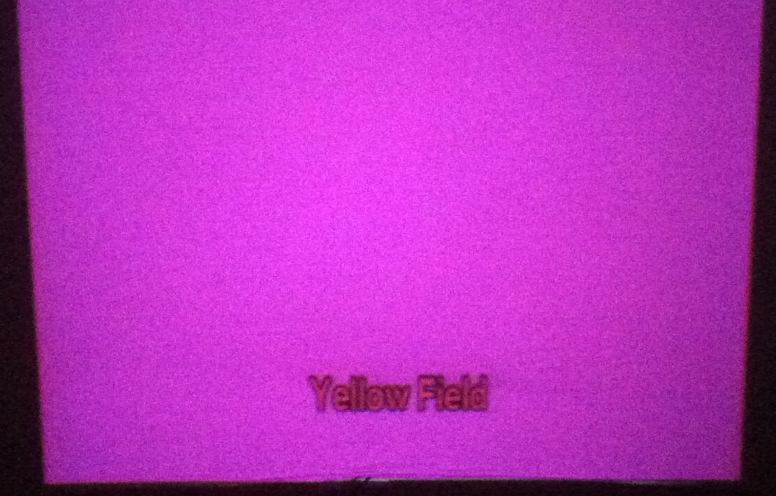

Could it be possible that I have one of my color wires not plugged into the right input on the back of the pj even tho they are going to the same letters off the back of the processor? All of my greens are blue and all my blues are green an yellow is magenta. That is the colors off my laptop running into the processor through a VGA cord to port 5 if that helps.

Posted: Fri Feb 15, 2013 5:04 am    Post subject:
As you can see its supposed to be yellow. If the picture is bad I will try adding more tomorrow. I have to shrink it on my phone. Do not have my sync cable from work with me

Posted: Fri Feb 15, 2013 5:17 am    Post subject:
Yep very possible. Try switching them around. Maybe the cable was made wrong

Posted: Sat Feb 16, 2013 3:00 am    Post subject:
I feel stupid now. My green and blue cables were switched around backward.
Now my next problem is my HDMI to VGA vonverter does no produce any images to the projector. I plugged it into my LCD projector and it works there, my hdmi cable works from my laptop to my tv so the cord works. My processor is set to negative sync and works on all other video sources. What could my problem be now
