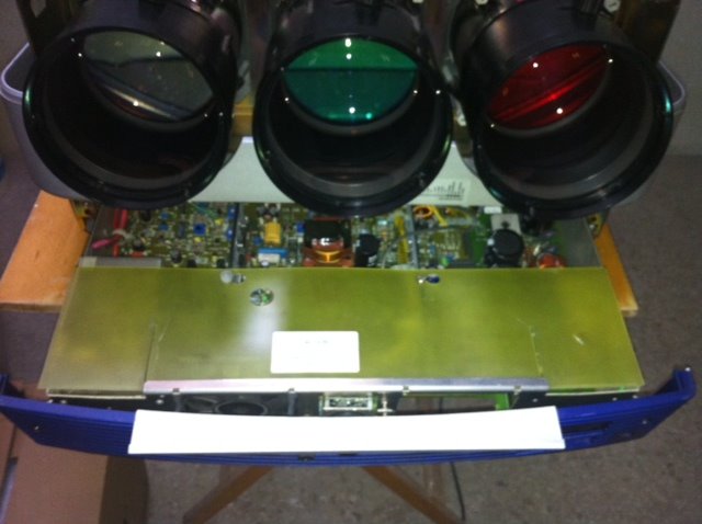

I think this 708 with p16 tubes is the most underrated projector out there...I am watching this ES focus setup, and I am not the least bit concerned with a lack of sharpness. Color filtered lenses bring this projector quite easily on par with something like a NEC PG (and likely superior). And the small Barco chassis is a real +...but I have a couple of questions..
1. the p16 tubes in a 708, are they found in other projectors? THat is to say, could I swap one in from some other Barco chassis or is this not possible?
2, Would a 708 with toshiba tubes be totally incompatible with this one in terms of other boards?
3. If the major flaw with these Barco's is arcing..is there anything that can be done which might prevent an arc? Any type of shielding or preventative measure that can be taken?
I can't believe I bought this projector for 45 dollars...clean tubes and color filtered lenses. It is decidedly not LC, but I am not feeling like I am missing that all that much. I am genuinely pleased with the pic. I have owned 2 of these in the past and they weren't even close to the pic I get out of this one..it just goes to show that you can't really blanket a projector model as better than a different model. This is a better pic than some NEC's I've had.

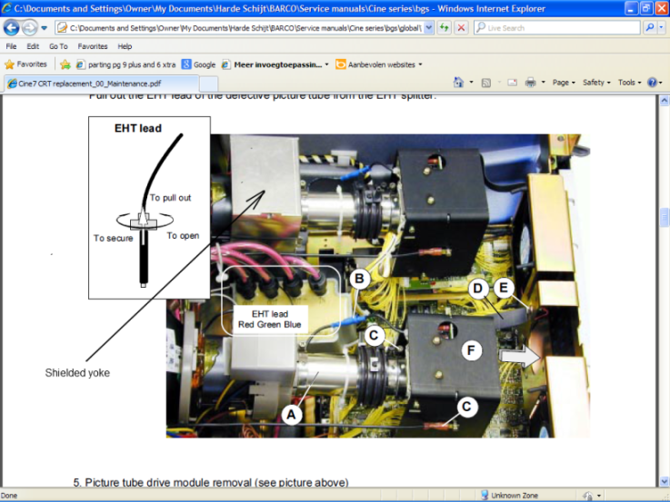

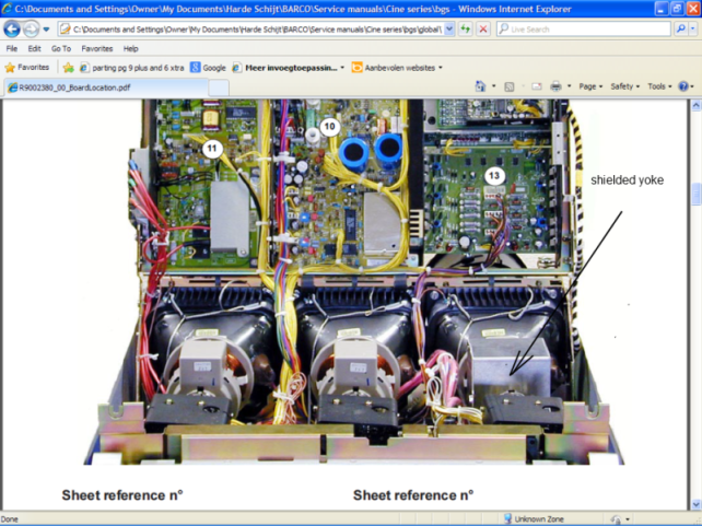

3. Yes, it is. The best thing to do is shielding the deflection yoke of the blue tube. This is in close proximity with the HV splitter and that's no so healthy. On Cine 7 ( in fact a later BD708 ), Barco did it with a metal cage and for good reasons, i think. Look at the pics.
 Filesize:  477.21 KB
 Viewed:  8682 Time(s)

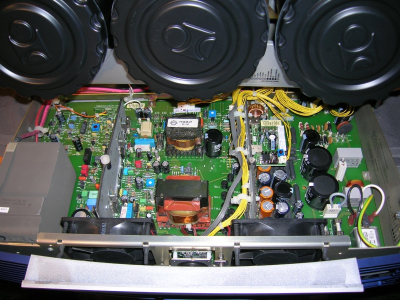

benareeno wrote:
I notice a large yellow plastic sheet came with the projector, and I'm not certain where it goes...maybe it's some form of shielding.
Yes, that shielding sheet comes on top of the SMPS/HV section. If you open the tray you'll be able to see the fixation bolts.
P16 tubes from RP machines won't fit. Most of those machines use LC tubes. It means that the glycol is also used to cool the phosphor. AC tubes are cooled by a thin chamber ( cooling fluid between phosphor and a glass front plate ).
So if you strip a LC tube and use it as AC, it will implode before you'll be able to watch 20 min. of video, due to lack of cooling.
 Filesize:  220.55 KB
 Viewed:  8572 Time(s)

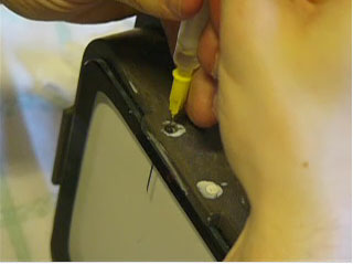

I think he's just saying that a non liquid cooled tube will implode. That's not quite true. Long ago, VDC sent me an XG tube that they forgot to fill, and I didn't catch it. Was wondering for 45 minutes why there were green halos around everything. I pulled the tube, and saw that the fill screws were missing. THe tube didn't implode, but I did get phosphor burn within the 45 minutes that I was playing around with the set and tube. They replaced it under warranty.

benareeno wrote:
I notice a large yellow plastic sheet came with the projector, and I'm not certain where it goes...maybe it's some form of shielding, I'll have to see where it might fit.
I think that it fit as picture below.
 Filesize:  48.33 KB
 Viewed:  8464 Time(s)
Domenico (Barco fan!)

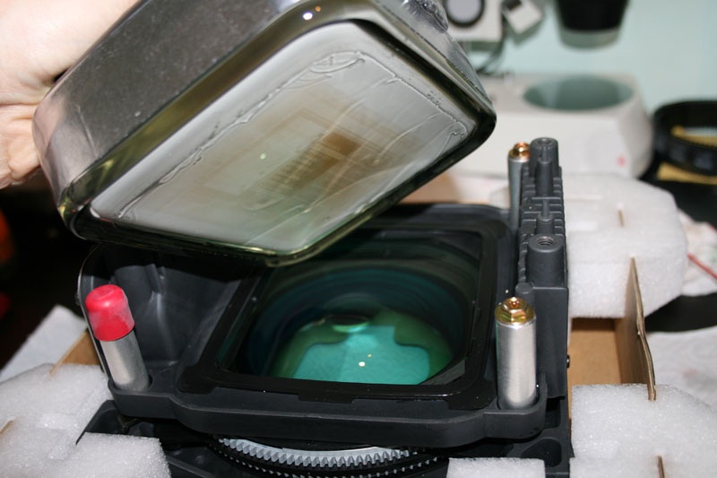

I think i am misunderstood here, i'll try to explain better.
It's not about the physical dimensions of the tubes here, nor the inner curvature of the phosphor. It has to do with the very different ways of cooling.
Also, LC ( liquid coupling ) should not be confused with liquid cooling.
Because the excited phosphor becames hot from the electrons bombardment, the faceplate of the tube has to be cooled.
Tubes designed for air coupled projectors have a double glass faceplate which is filled with cooling glycol, like in first pic.
The ones designed for liquid coupling machines does not have that because they are anyway cooled by the liquid coupling
glycol ( trapped between the crt and the C element ), like in second pic.
Most of the retro projectors are equipped with liquid coupled tubes and short trow lenses. You can't swap the entire tube with the liquid coupling chamber because it won't fit in a air coupled machine and even than, your long trow front projection lenses becames useless.
You can however strip the tube from the liquid chamber ( third pic. ) and put it in a air cupeled projector but you'll end up with tubes without cooling, and that's no so clever. Even if they won't implode or crack, after watching a movie they will be cooked brown, like Curt said.
So the TS can not put the P16's tubes from a retro projector in his 708.
 Filesize:  90.78 KB
 Viewed:  8453 Time(s)
