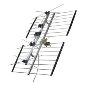

Posted: Wed Jan 30, 2013 4:32 am    Post subject:
This is the one I'm using. I have it up in my window:
http://www.solidsignal.com/pview.asp?mc=03&p=4221-HD&d=Channel-Master-4221HD-4bay-HDTVUHF-TV-Antenna-&c=TV%20Antennas&sku=
