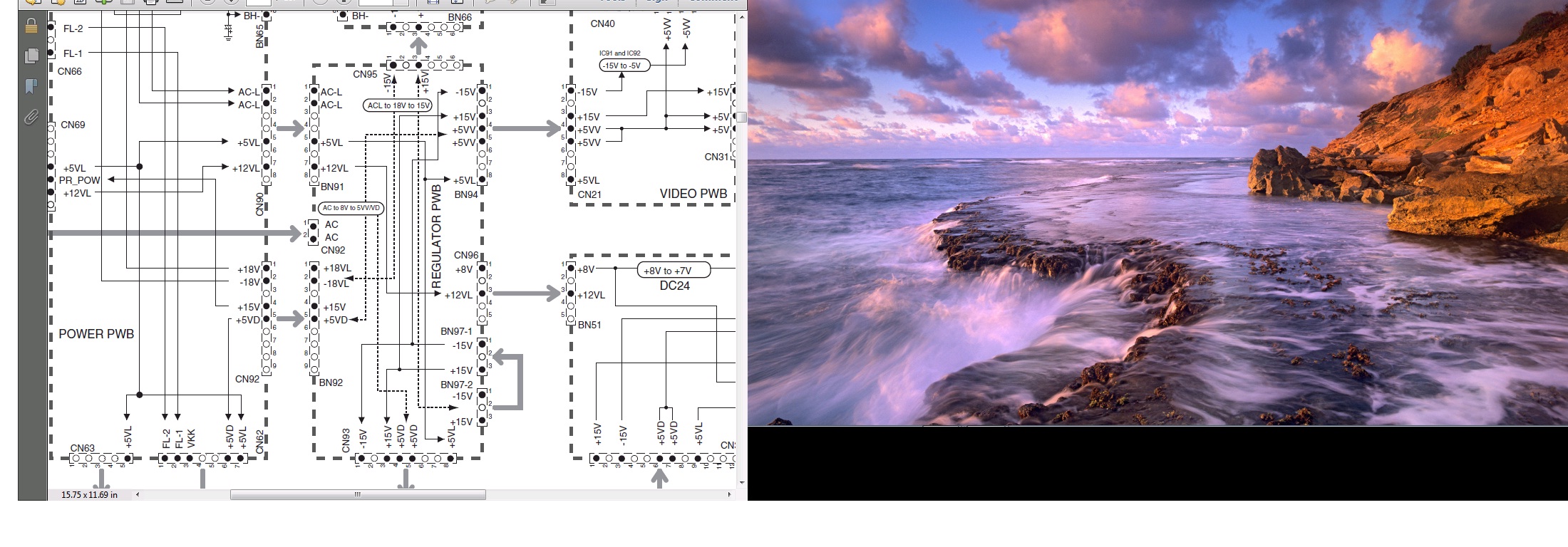

Alright, I recently had an AVR with a scrambled display which I also fist thought the worse but it ended up just being a shorted voltage line in a complete different location. So the first place to start is to test the supply voltages coming out of the regulator board. I have attached a picture. I'm in a hurry so just did a quick screenshot so disregard my desktop image, lol. Do your best to test all those output voltages and let me know what you have or don't have. I have to run out for a few hours so I'll check in when i get back.

Measured as best I could, though didn't always pay attention to + or- voltages. Surprised to see so many variances. FWIW, the amp section seems to work on at least 4 of the channels (FR, FL, RR, RL) with an external preamp attached.
Here's the results:
Marantz SR7002 Regulator Board
CN93 – OK
CN92 - not checked
BN92 – Pin1=20.7V , s/b +18V
Pin2=21.2V, s/b-18V
Pin8=4.7, s/b 0V
BN91 Pin7=0V, s/b +12
CN95 Pin4=4.8V, s/b 0V
Pin5=4.8V, s/b 0V
BN94 Pins 4, 5= 0.82Veach, s/b +5V
CN96 Pin3=0V, s/b+12
BN97 1,2 OK
Thanks again!
Posted: Mon Jan 07, 2013 10:36 pm    Post subject:
There are some pin numbers in your post that make no sense and some missing. I made a chart for you to just fill in the blanks. Make sure you check whether it's + or -. I need specifics.

Zerog
Joined: 05 Jan 2013
Posts: 35
Location: Southern California
Posted: Mon Jan 07, 2013 10:49 pm    Post subject:
Roger that - will repeat. The silk-screened board designations are very hard to read - would you happen to have a board diagram handy?

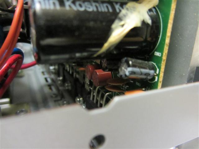

On that regulator board there are 2 fuses, F901 and F902. See if they are blown.

Thanks for the fast response. Obviously they're not glass fuses. Very difficult to see without a teardown. Would you happen to have a board diagram? That would help tremendously.

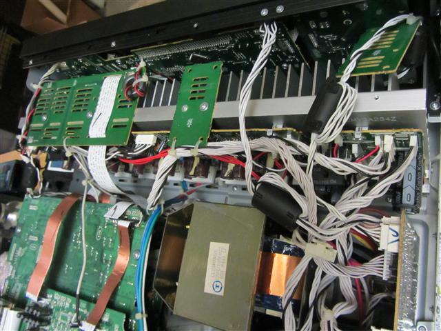

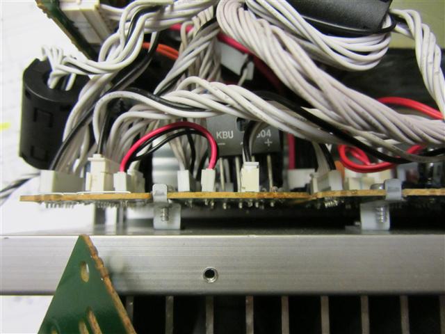

I see two small brown cylindrical shapes that say 5A 250V, so could be the fuses you mentioned. They appear to be soldered in. I was looking for a fusible resistor, too.
The board is attached with one screw but there are several transistors and/or regulators that attach it to the heat sink. Can this be tipped back just a little without cracking the trans/regs?

Ha, AVR's are almost never easy to work on. You just have to suck it up and remove what needs to be removed. Very Happy

Yep, that's them. I'm gonna see if I can just measure them without a major teardown. This is the appropriate time to wonder why they just didn't put an access plate on the bottom of the unit.

Posted: Tue Jan 08, 2013 3:20 am    Post subject:
OK...a medium teardown. Sure hope I get it all back together - those flat ribbon connectors that just push in can be challenging.
BTW...the fuses are good. I didn't unsolder them, but there's continuity across each one.
What's next?
