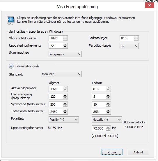

Here’s a blue print on who to do 72Hz. Thanks to Nashou66 for his knowledge I got it to work. No ringing with this either.

Here’s a blue print on who to do perfect 72Hz. See pic. Thanks to Nashou66 for his knowledge I got it to work. No ringing.
