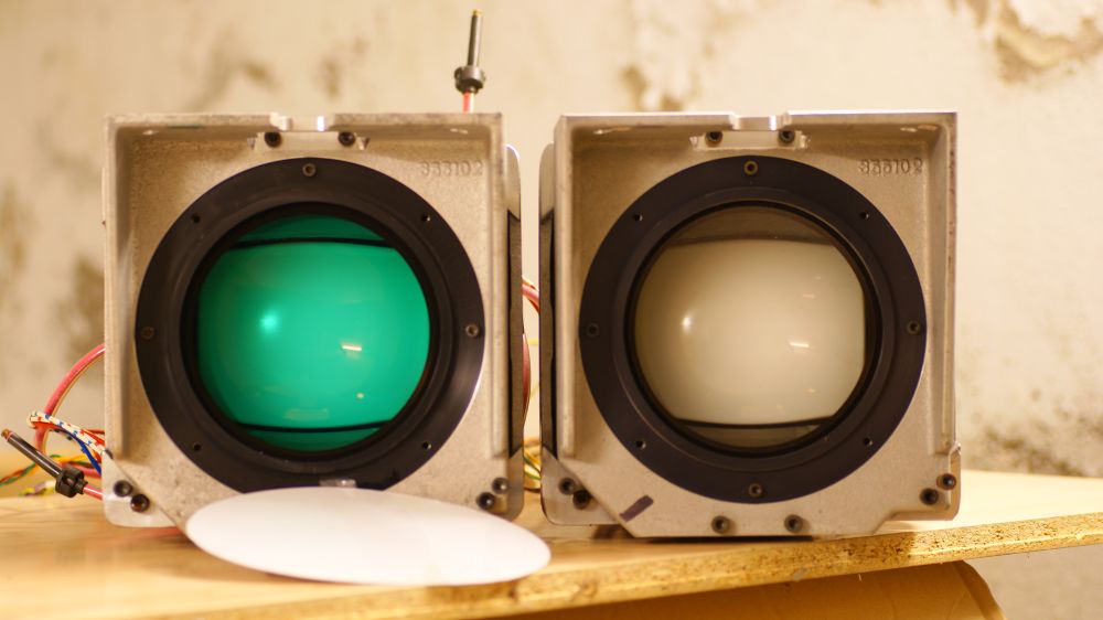

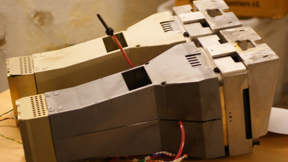

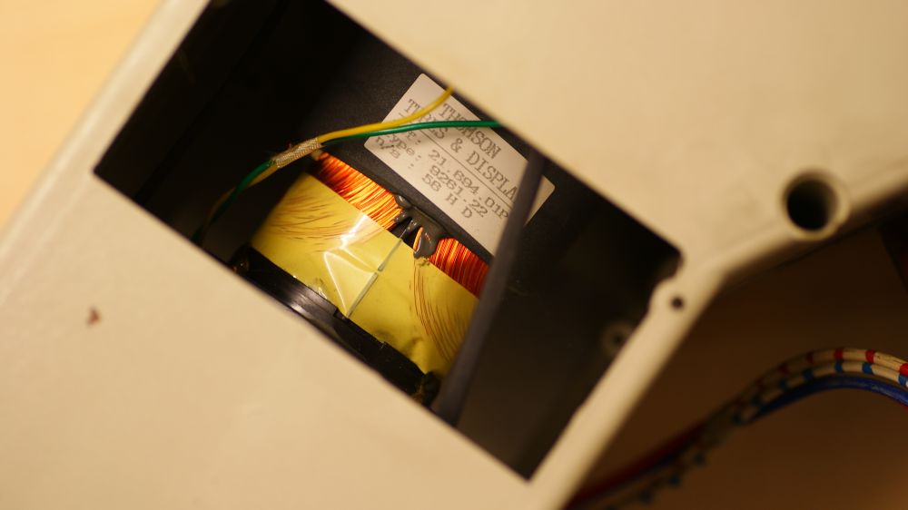

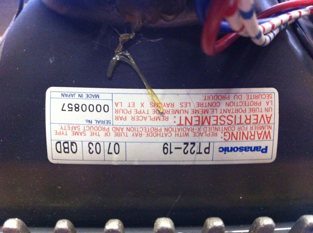

i think i just scored two tubes Very Happy
seller doesn't know anything about these, but i thought for 50€ i'll just take them.

Let's hope they are not victims of the heater voltage problem, however the chambers and the green C-element alone worth it Smile

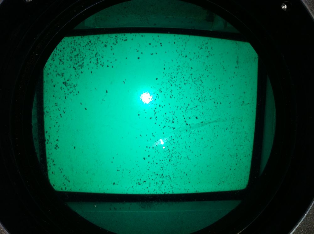

I do recommend taking a closer look at the bellows. It seems to me from the first picture, that the tube with the darker grey casing has some signs of corrosion. Its origin usually is leaking glycol corroding the bolts...

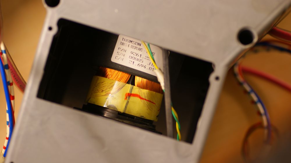

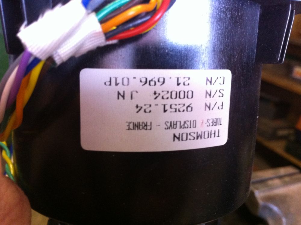

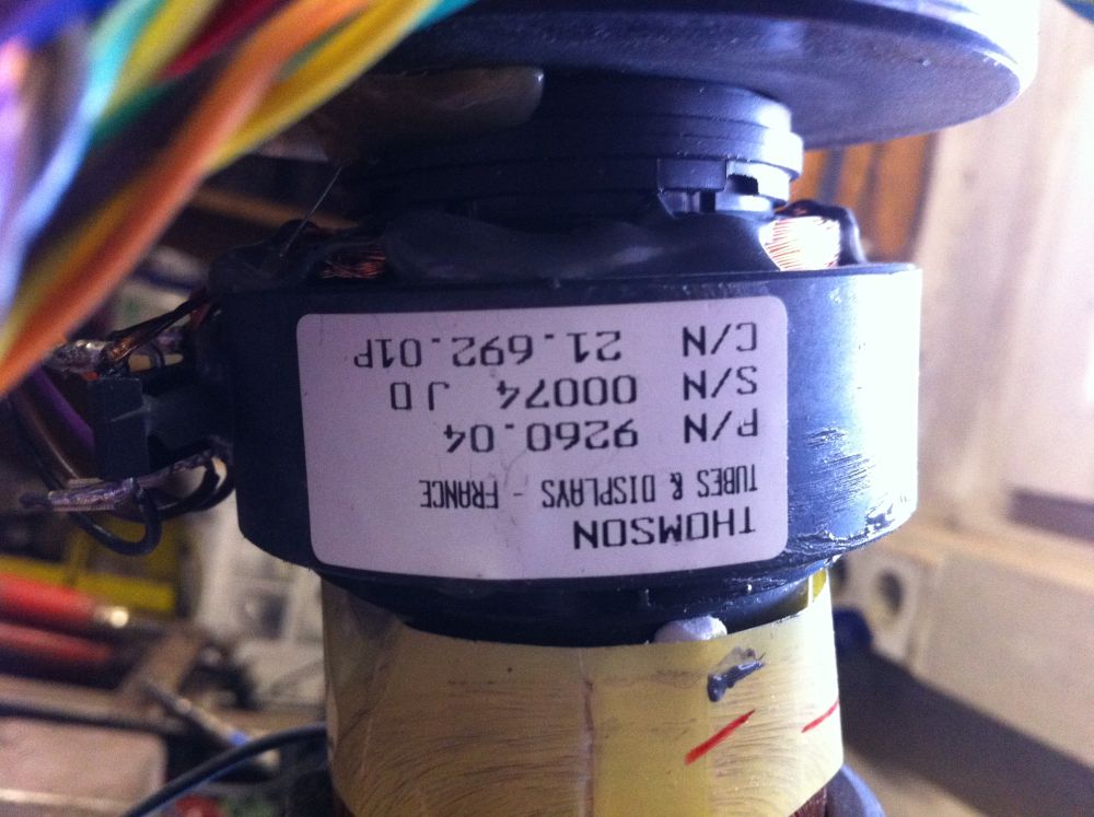

got the tubes today Smile
they both have slight corrosion on and in the housing and flakes in the glycol.
everything else looks pretty good !
i think they got pulled because of leaking from where the bellows join the housing.
as soon it gets a bit warmer, i'll put them in the projector and check how the emission is.
if i decide to keep them, i'll drain the glycol and disassemble everything to clean and paint the housing.
bellows still look good to me, they were just sweating a tiny bit. they should be alright once reseated properly.

You wont be able to save the bellows, and since they are sweating they will continue to sweat.
The Housing will have to be painted with Epoxy paint. allow at least one week to dry.
