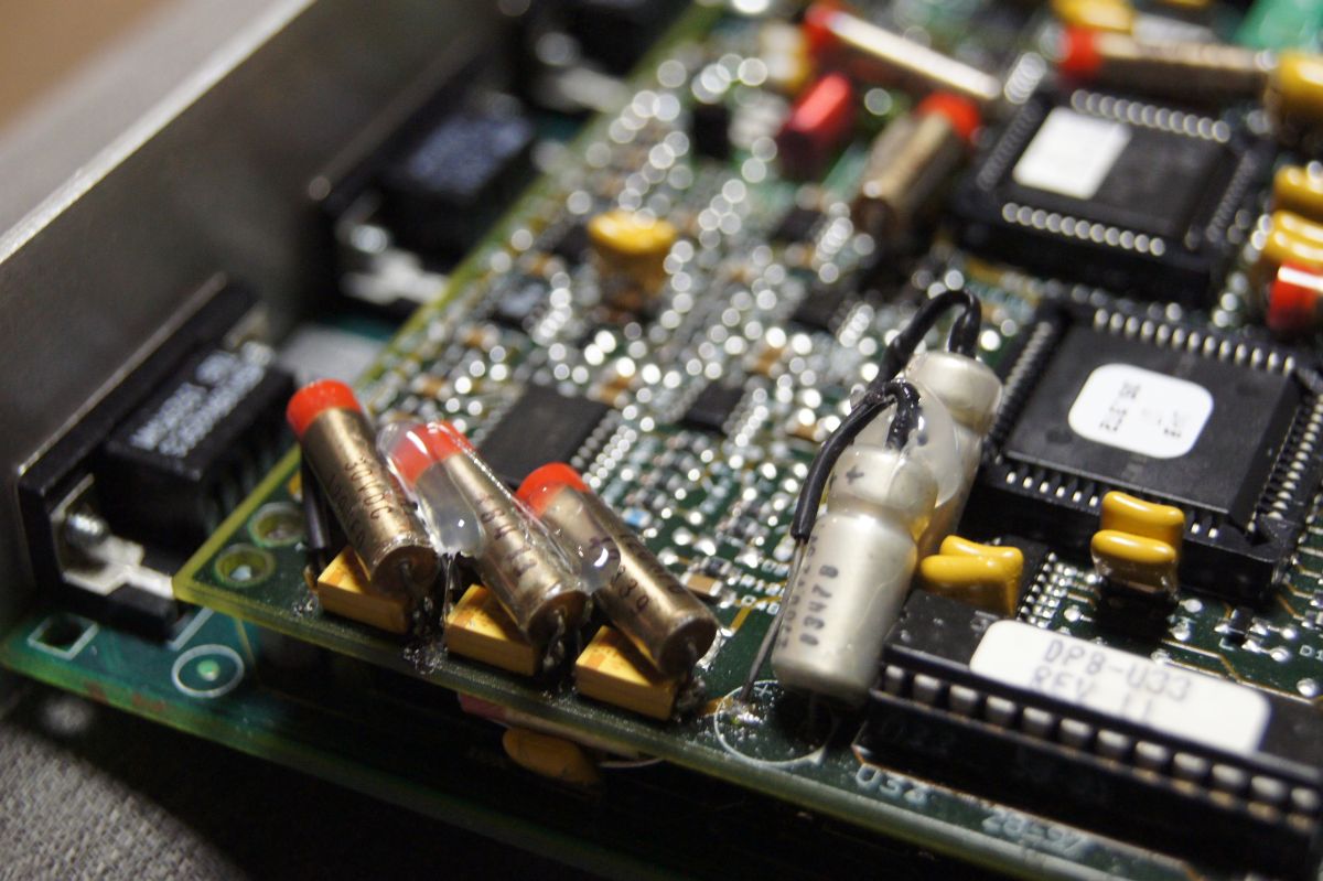

Motobias wrote:
thi is it:
http://www.ebay.de/itm/110975277570
it was advertised as a 9500lc and he sent me a mail because is asked about date, etc:
"Hallo,
Der Projektor ist von 97 bis 2000. Es ist ein Ultra - also erweitertes Fokusboard und hdm. Auch sie Software ist entsprechend.
Gruß"
"...projector is from production date range 1997-2000. i is an ultra - has extended focus board and hdm. software is according."
...well...what the hell is it now ?
LOL.. Its a piece of sh*t lol... But don't worry... YOU don't suck anymore.. Laughing
Sorry... But as Curt say.. Cap mods like that is worse than nothing..
Really hope you will get it up running, but prepare yourself shopping for a spare machine.

Posted: Mon Nov 26, 2012 11:46 pm    Post subject:

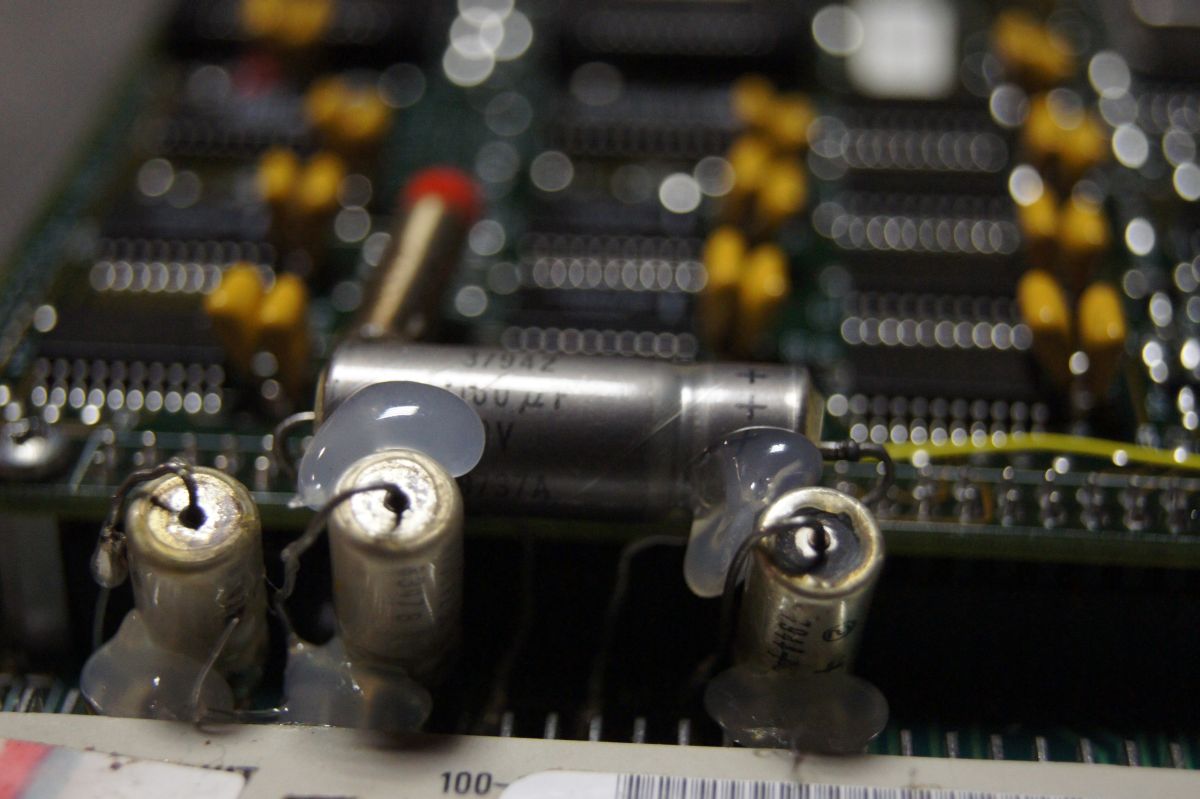

well if the caps were just all replaced by tantalum ones, that's ok Wink
tantalums have better specs than most other caps and do not fail that often.
the mods just look ugly and i'll make sure they are electrical safe...
the hot glue is my work, i just wanted them secured in place, so they won't short out against chassis ground or other components.
if i can't get lucky with it, first seller will have to live with the consequences and you guys can jump in queue for tubes or anything you think is worth having...
i forgot to mention that the set has high spec papst fans everywhere and is almost quiet but maintains a good airflow.

I thinkt he Marquee will be fine once you figure out that garbled video issue. It was most likely from the glycol. I hope you figure it out. Some of the mods are actually not bad.

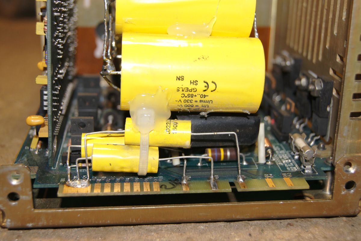

Id like to see the HVPS.
I bet he didn't know about the 33uf 700vdc Clarity caps they could have used instead of a bunch daisy chained together.
Hope you get it going though. Still a great deal, glycol problems are a bitch!!!

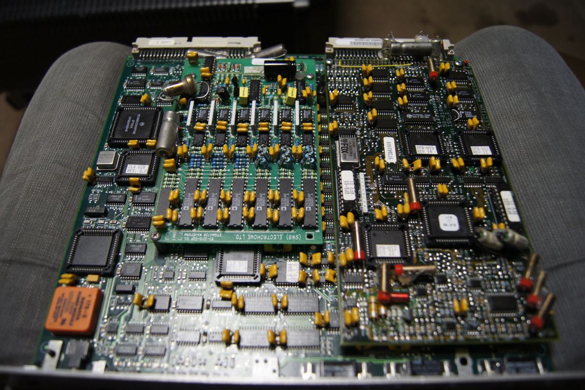

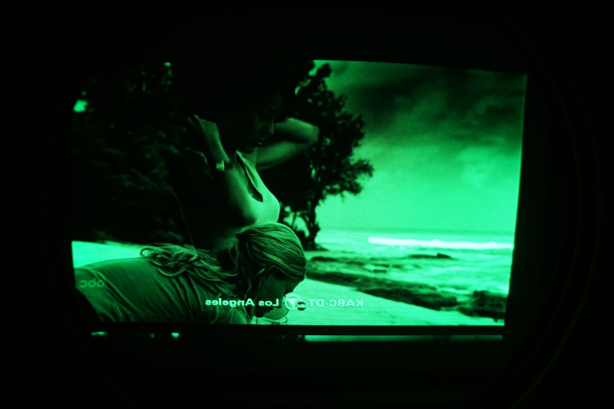

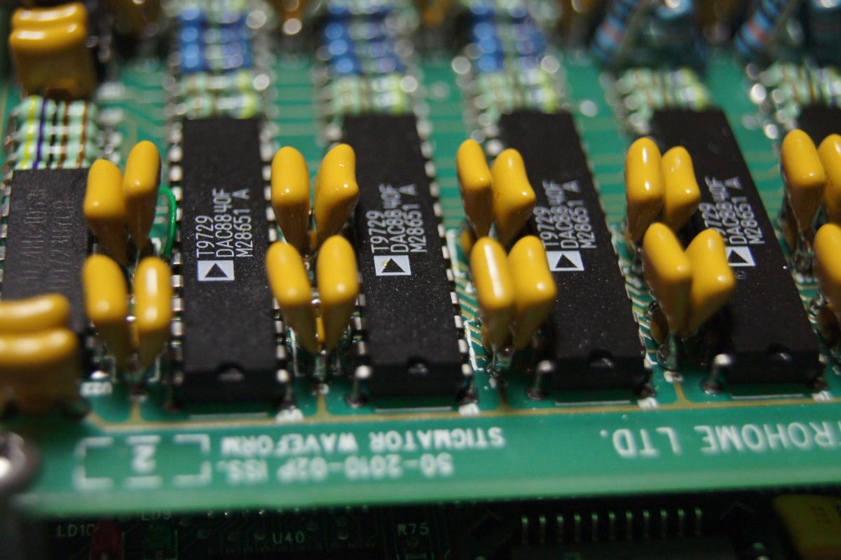

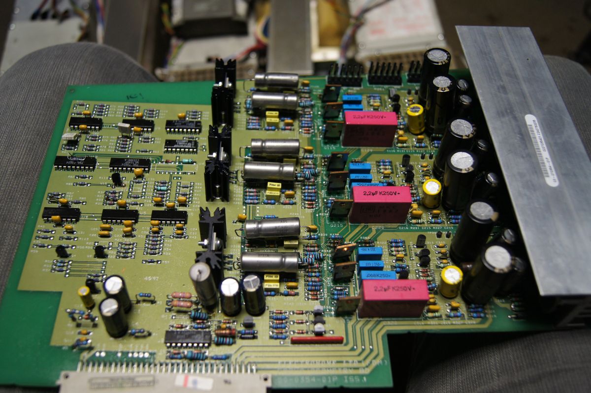

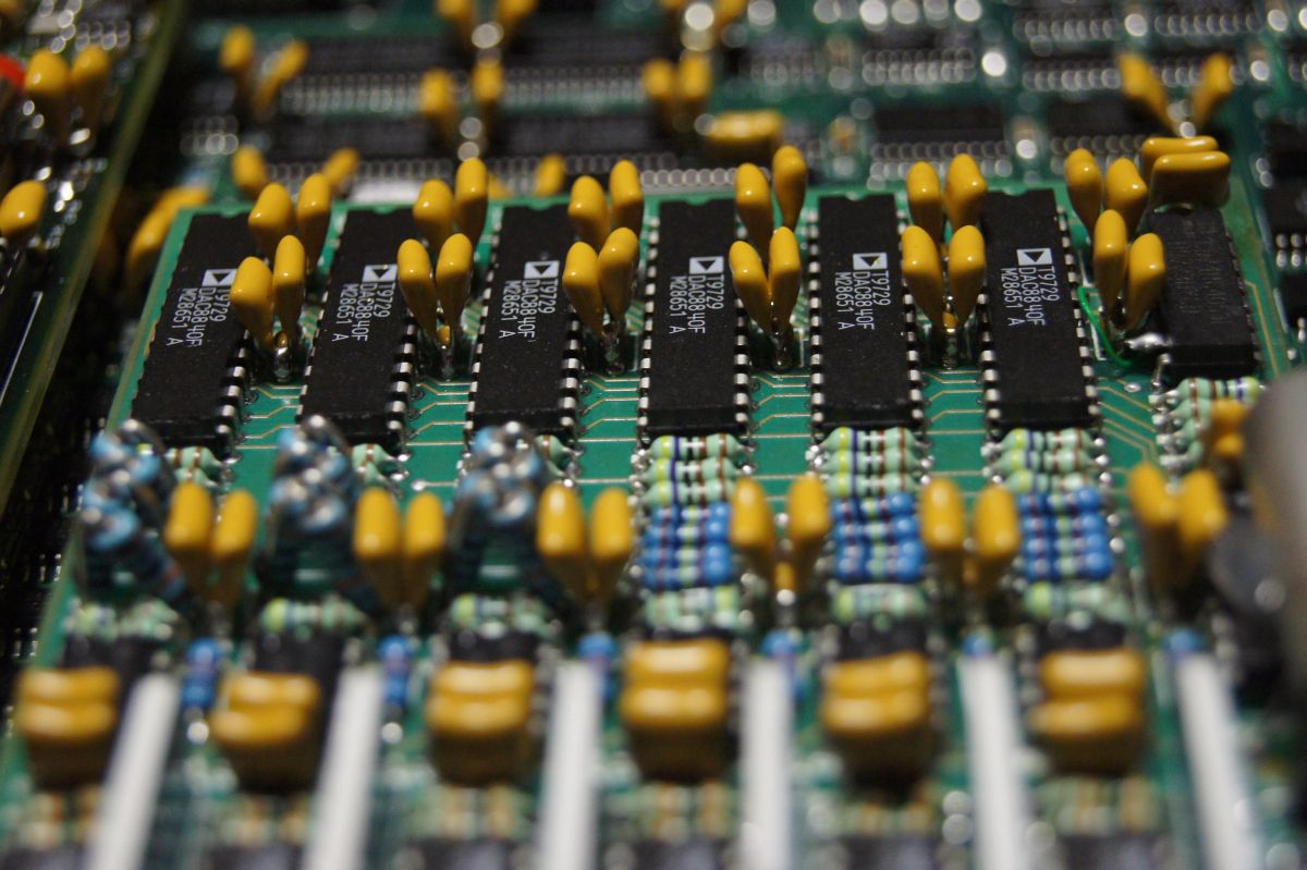

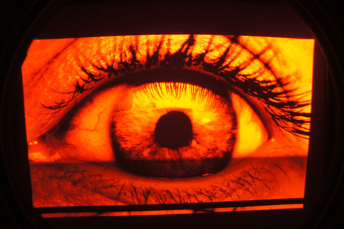

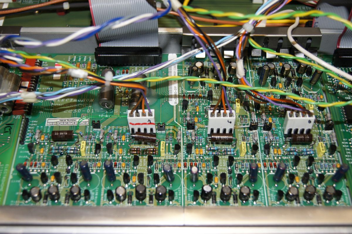

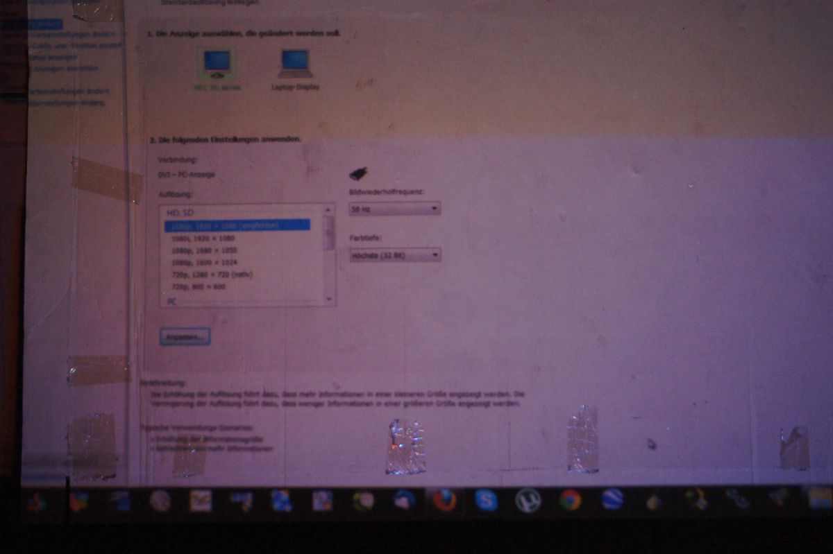

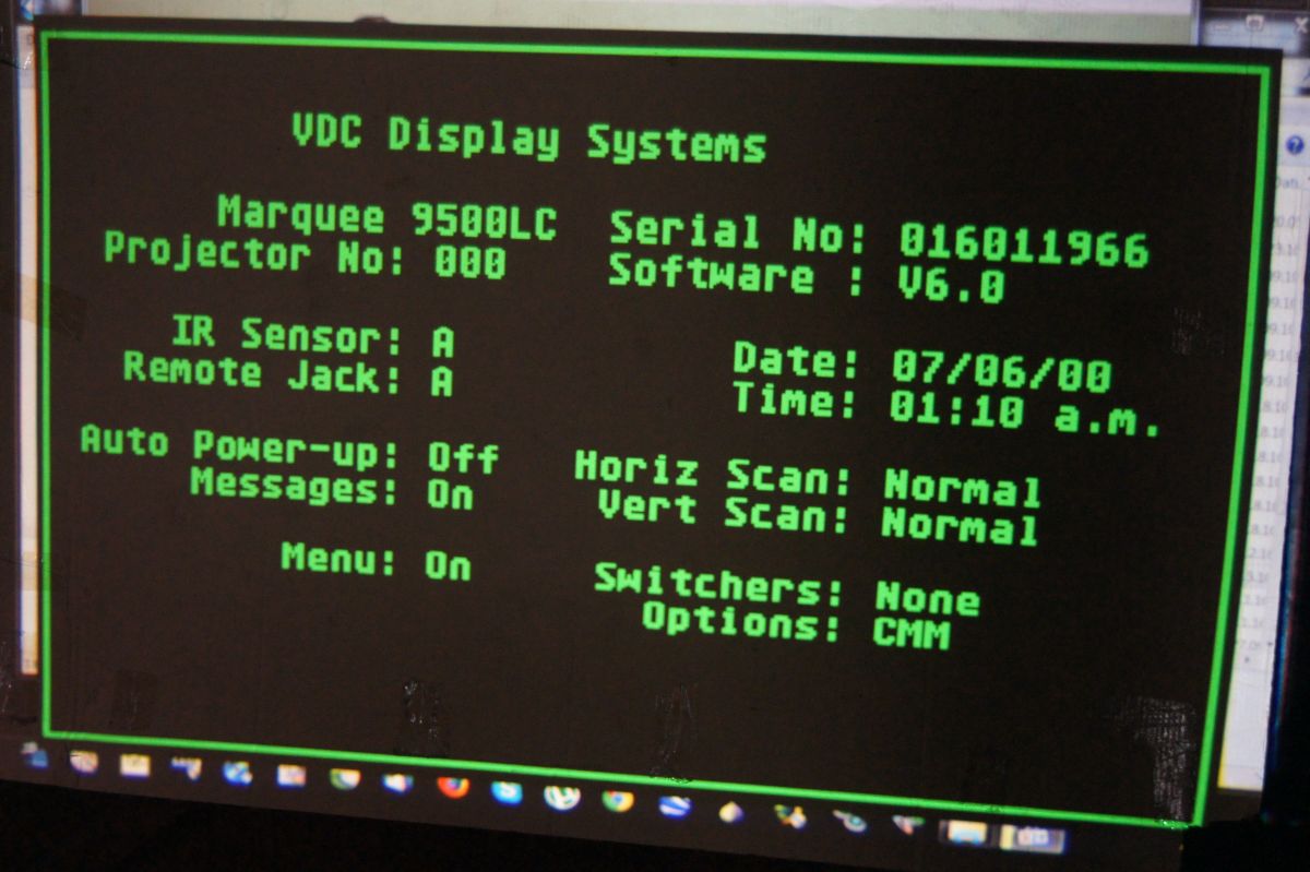

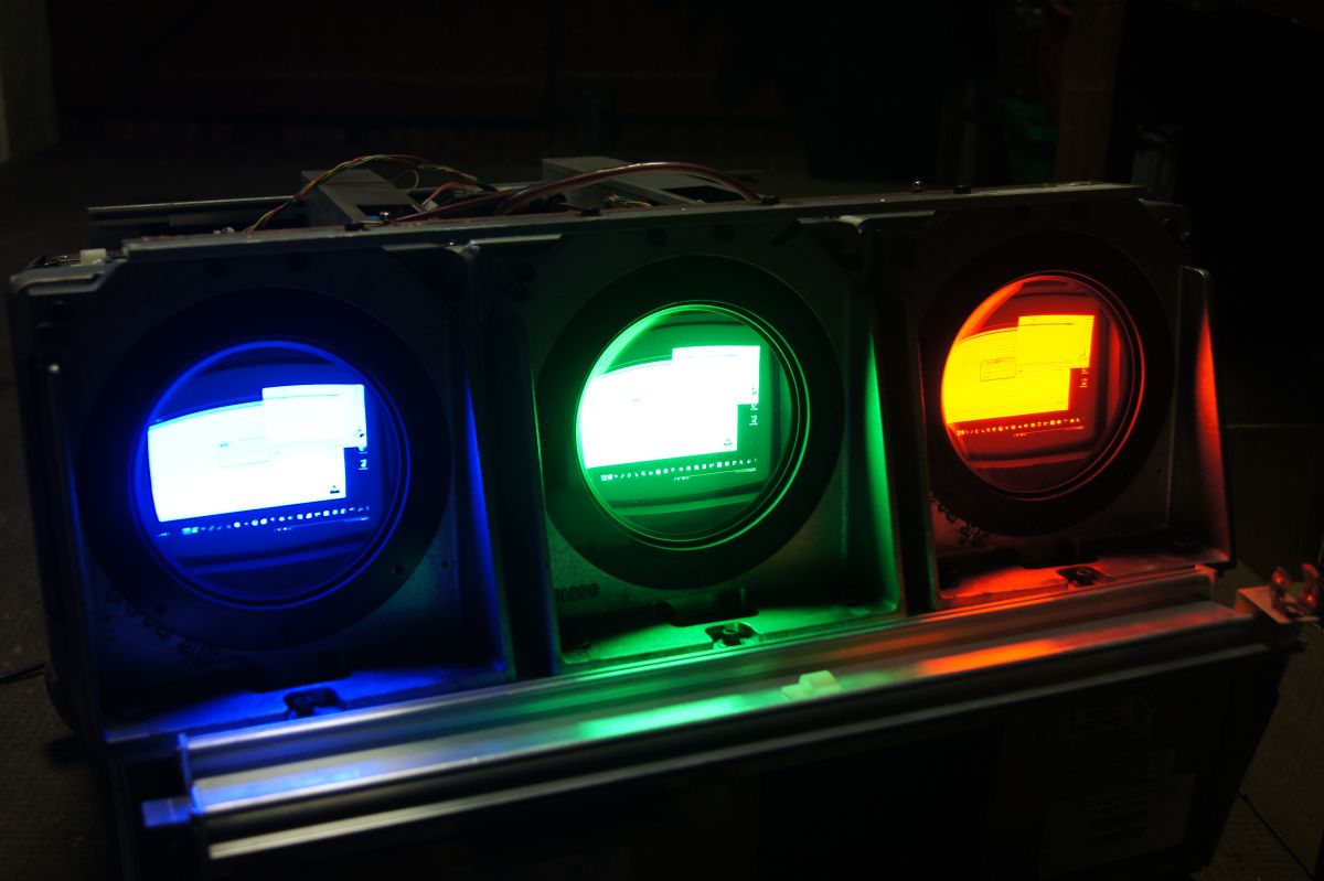

it's alive !
i cleaned the lenses yesterday evening and prepared everything to go back in.
this morning i put everything back together and fired it up... wohoo Thumbs Up
connected laptop via hdmi on 1080p 59hz and it displayed without a problem.
convergence is rock solid and i just did a 5minute job on it.
couldn't be bothered with scheimpflug, astig, focus, etc... but i looks pretty damn good already !
i didn't take the hvps out, but i will do soon for a picture.

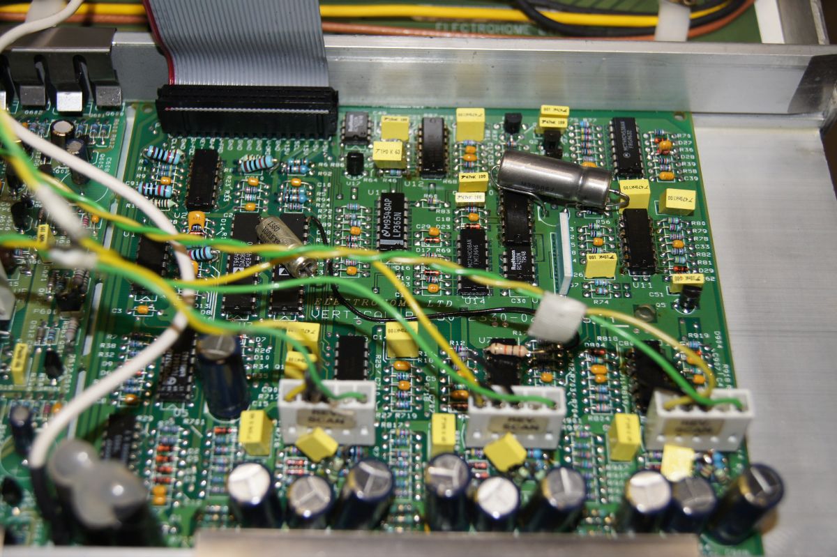

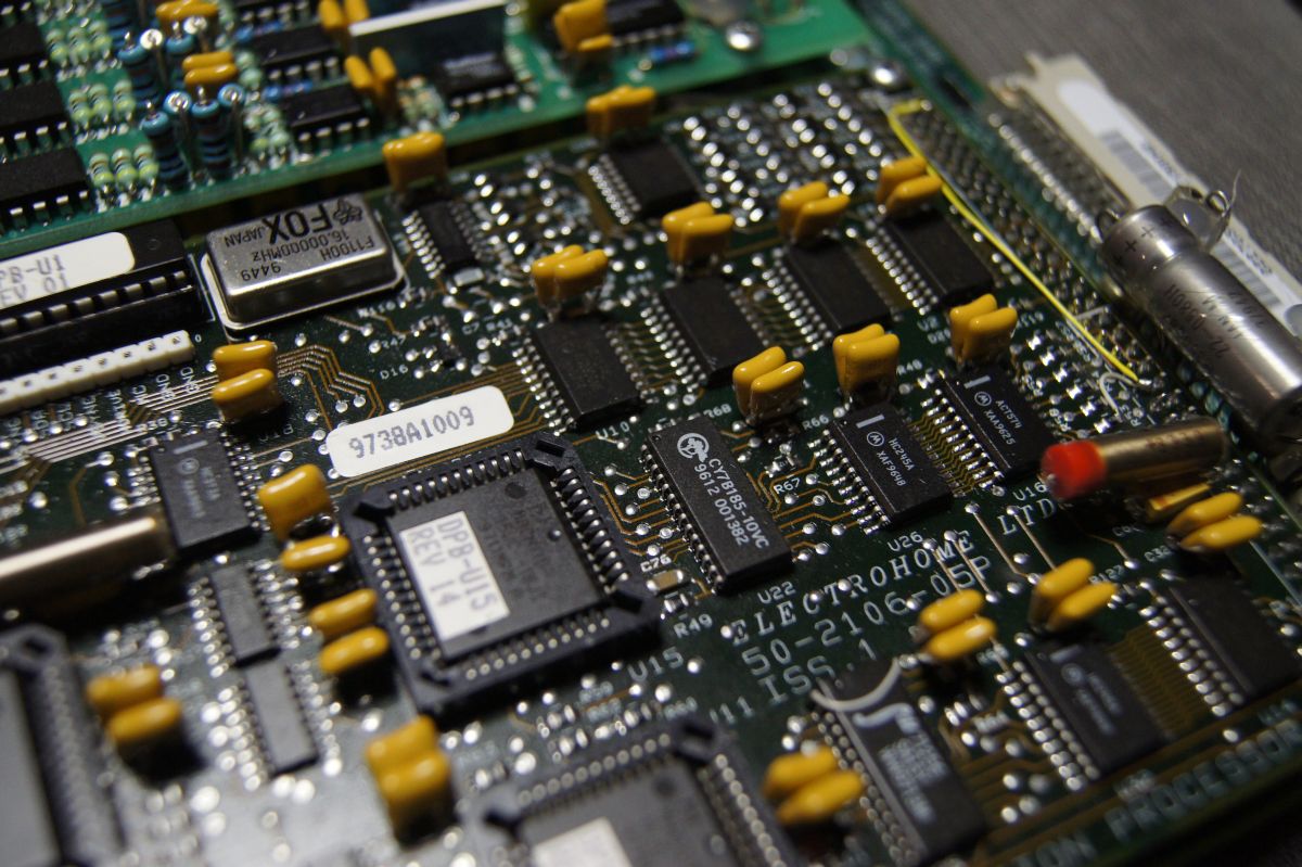

controllerboard aswell...i know you guys are craving for pictures of ugly mods Laughing

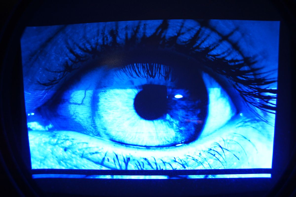

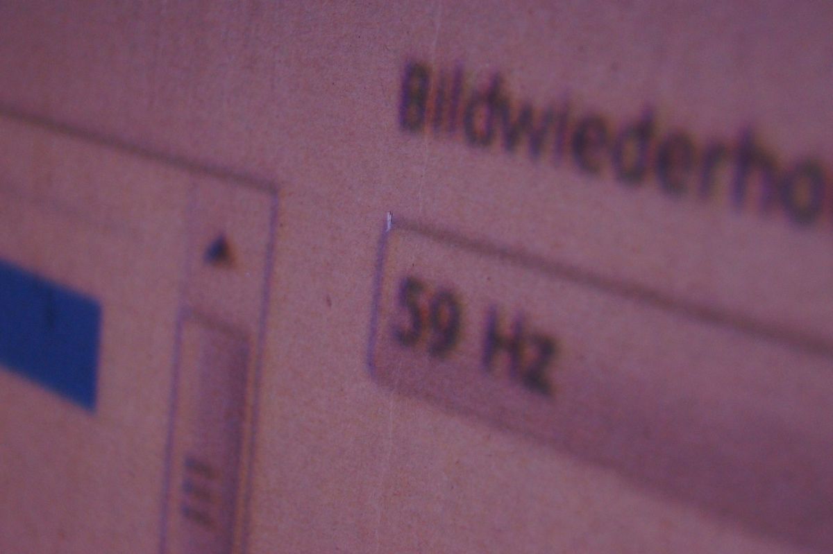

more pictures...
i fixed the phase later Wink
i am projectiong on a piece of brown cardboard, which is not even plain.
distance at about 2,50m image width about 2,00m

Posted: Tue Nov 27, 2012 3:50 pm    Post subject:
You did it.. Thumbs Up
Posted: Tue Nov 27, 2012 3:51 pm    Post subject:
All right she's up and Running!!!! Woo Hoo!! I think I am more excited than you are!!! Wink
But be careful with that tube that pushed out. I would still remove it from the housing, clean the old glycol out and
re pot it in place. Just adding more Silicon wont hold it for long.

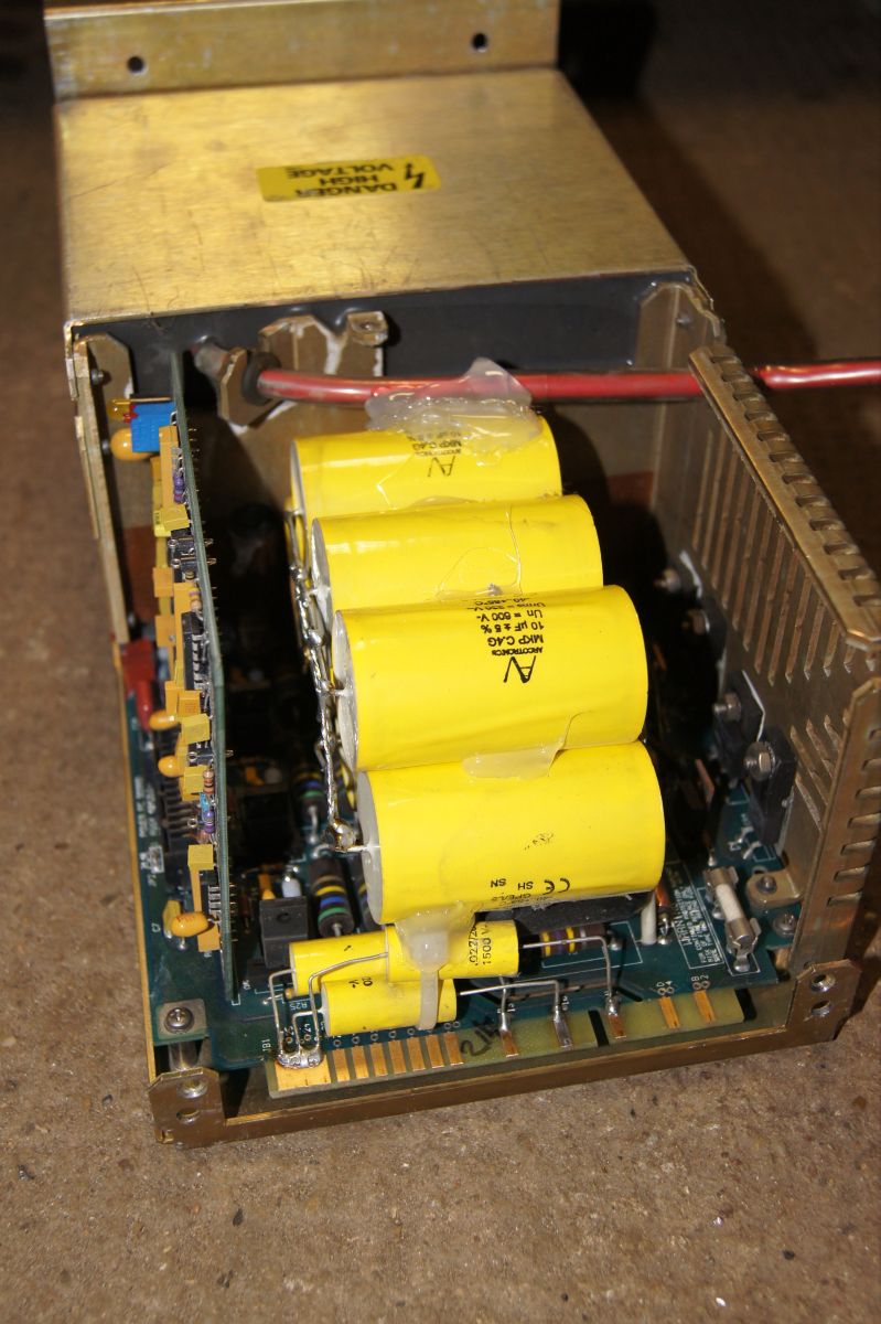

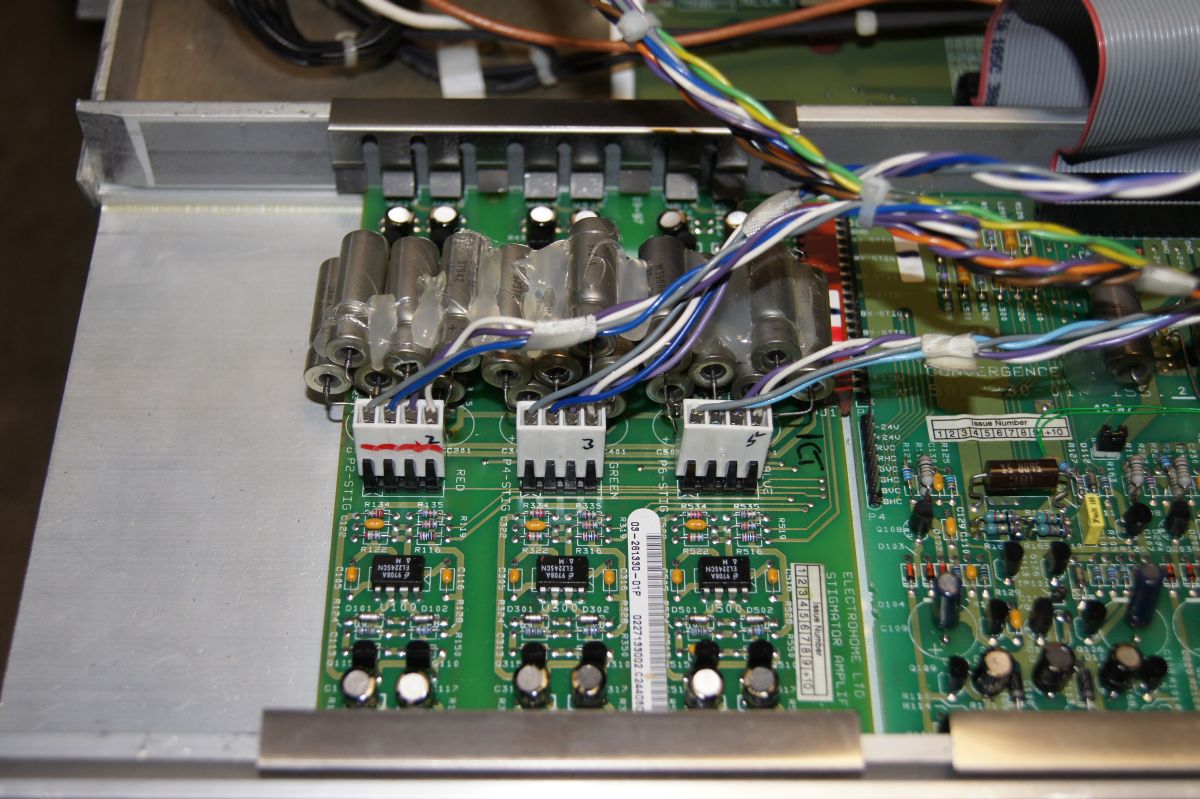

checked the filament voltage aswell: 6,35V Thumbs Up

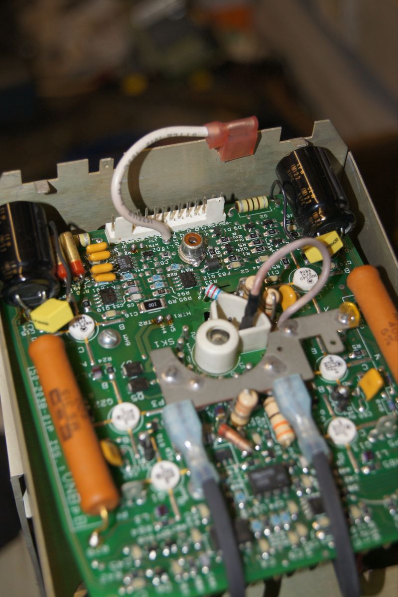

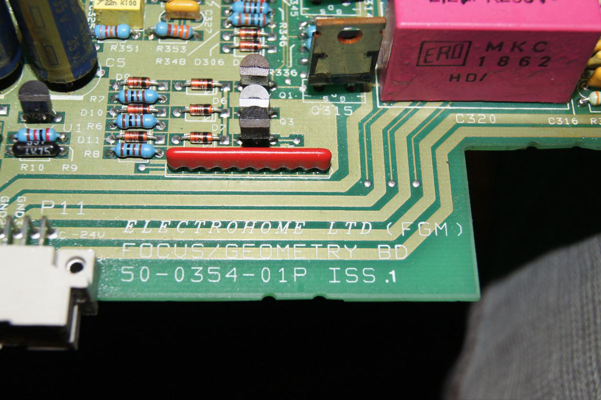

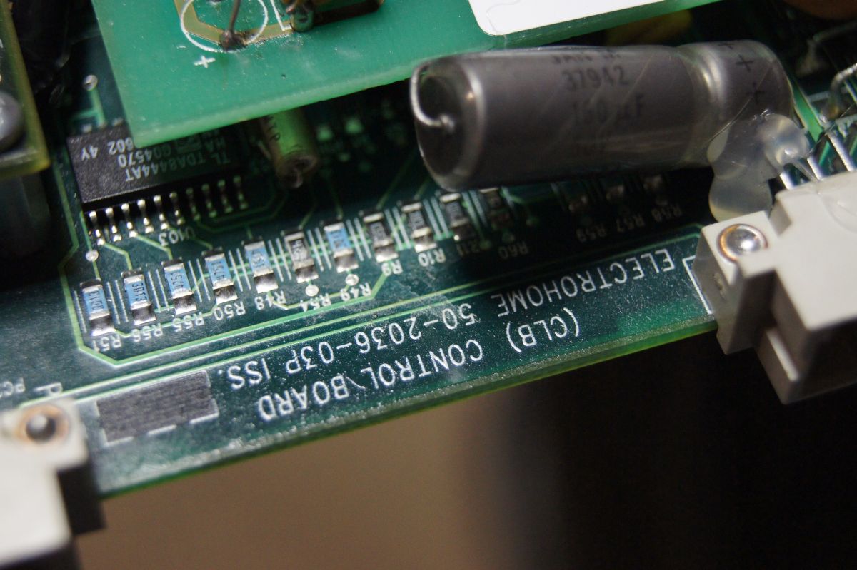

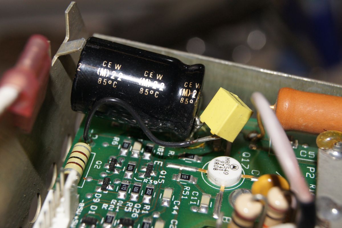

and more pictures for your pleasure Wink
controller board, power supply and the whole thing with case...

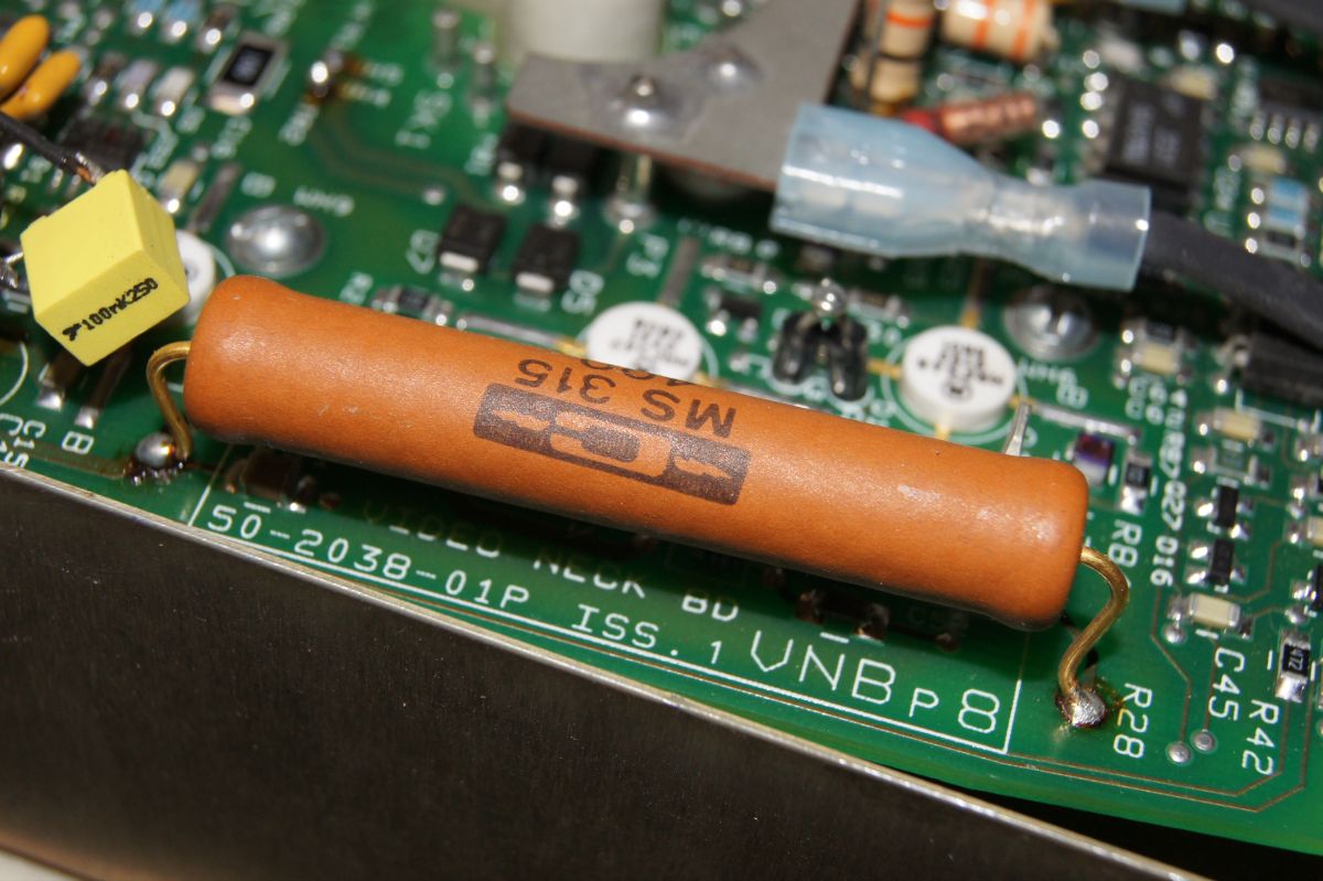

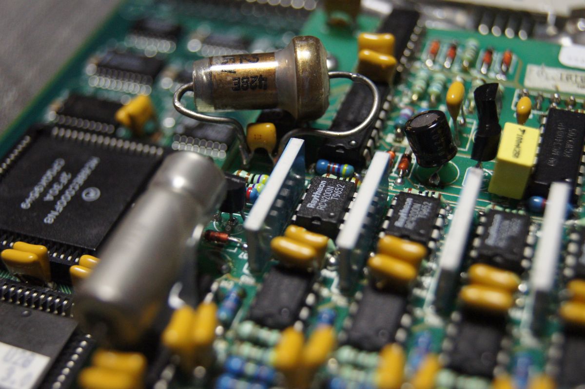

i wonder why whoever did all these mods, didn't replace the resistors !
FIGHTING STUPIDITY SINCE 1983
Posted: Tue Nov 27, 2012 7:39 pm    Post subject:

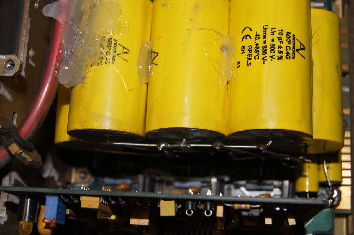

Looks like they followed Chris Stevens mod sheet. Those must be 1uf COG ceramic caps all over the place twisted together.
Can you take a picture of the soldered sides of those Film Caps in the HVPS. Looks like they might wired them wrong.
Motobias
Joined: 08 Jul 2008
Posts: 163
Location: Osnabrueck, Germany
Posted: Tue Nov 27, 2012 7:43 pm    Post subject:
looks like they are all in parrallel !
 Filesize:  164.13 KB
 Viewed:  6689 Time(s)
Posted: Tue Nov 27, 2012 8:20 pm    Post subject:
How many for each Rail? looks like they might not have enough voltage if in Parallel.

Posted: Tue Nov 27, 2012 9:35 pm    Post subject:
Motobias wrote:
not enough voltage ?!
Yes, having them in Parallel they increase the uf , so you add uf so 2 10uf caps equal one 20uf cap but the voltages get divided by the number of components. so if those are 600 volts then they are now 300 volts. The G2 section goes higher than 300volts. To increase voltage of multiple caps you put them in series, but then you halve the uf's.
The G2 section benefits from adding 20-40uf's. That looks like what they were trying to accomplish.
Posted: Tue Nov 27, 2012 9:45 pm    Post subject:
Excuse me, What? If you put capacitors parallel the capacitance will be added and the maximal voltage will be the lowest rating of all capacitors, if all caps the same, then no change.
10pcs. 1uF 600V caps in parallel equal to a 10uF 600V cap.
Motobias
Joined: 08 Jul 2008
Posts: 163
Posted: Tue Nov 27, 2012 9:48 pm    Post subject:
parallel caps:
capacity increases, voltage stays the same
series caps:
i wouldn't do that at all Very Happy
