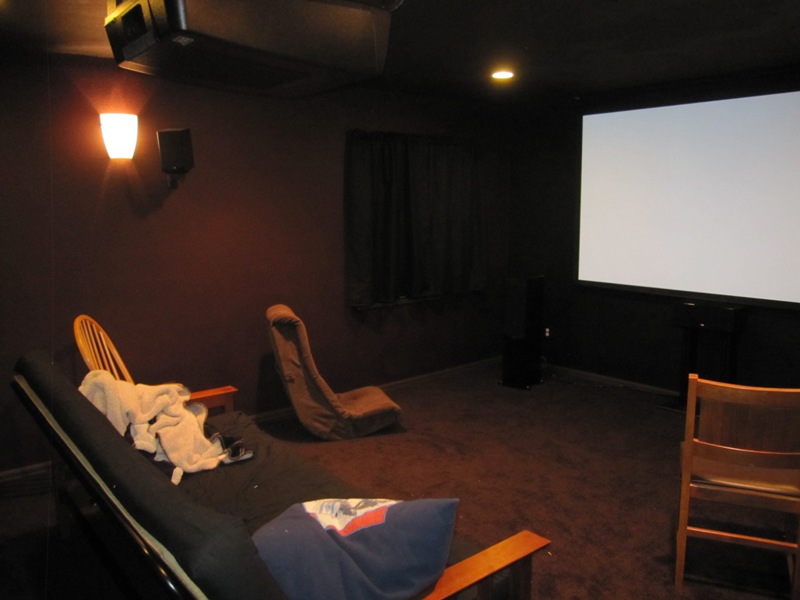

helped a friend set-up a 6PGX with Moome external MUX HD and it throws a fabulous 720P pic from blue ray.
the 9PGX would blow away your Barco 801 ES focus
