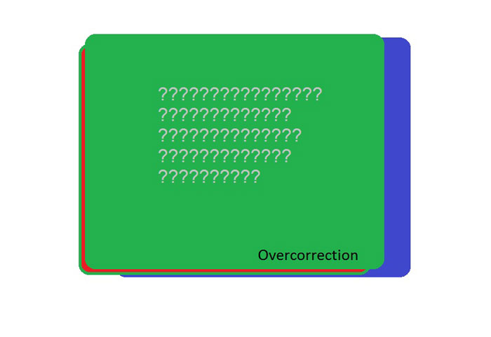

Posted: Sat Dec 01, 2012 5:31 pm    Post subject:
The Error 36 is usually not related to a defective tube I have read.
Today I connected the G70 to a DVD player via video. (A piece BNC connector)
The G70 had slightly longer a white light on all the tubes. (20 seconds) Smile
The first time I could see a font. .. Error 10 is displayed at the same time .. Confused
But it was not a normal menu on the tube.
Unfortunately I was not fast enough with the setting of optics ... The writing was on the wall blurred.
The writing consisted of 5-6 lines .. the writing was in the middle of the image.
I believe that the G70 would I confirm something or warned me about an error ... or it involved the warm-up ..?
The font is off by itself after 10 seconds.
For another 5 seconds was displayed in the bottom right image = .. overcorrection?
The G70 has got Error 36 and has shut down.
What is wrong if Overcorrection appears?
Summary:
First
DVD player is connected and turned on (before test at Barco 801)
DVD player connected to the G70
Second
G70 = switched on at the main switch 1 second after 88 no display
Third
G70 on the switch is turned on (Stand By button) = Error 10 and immediately light on all the tubes.
4th
I saw an unknown script.
5th
The writing is gone.
6th
I've seen a different font,,,,, Overcorrection,,,,,
7th The G70 has turned off with Error 36th
Greetings Sebastian
