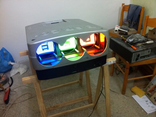

Posted: Thu Jan 10, 2013 2:35 pm    Post subject:
Well
I just bought two boards
Input board and focus board
First of all I swapped input board and something happened.
Now there aren't red lights on in deflection boards.
Now there aren't red lights on in the controller (except the led named "cycles" that pulse)
Now don't goes in stand by mode.
Now there isn't ticking from somewhere.
The diagnose green leds are all on
The diagnose red leds are all off
The orange led named "coinc" is on
The filaments are bright.
Unfortunately no light from tubes.
When power off the projector appear a quickly circular spot only from blue tube.
Domenico (Barco fan!)
Decibel
Joined: 31 May 2007
Posts: 904
Location: Roma - Italia
Posted: Fri Jan 11, 2013 10:59 am    Post subject:
Swapped focus board also.
Yeah Thumbs Up
Thanks to all
