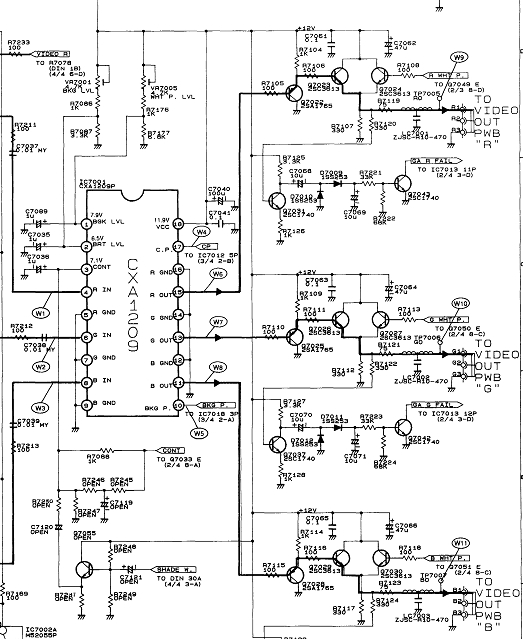

Turning back to the original goal of this thread...
While the above mentioned diode switching circuit is working as I expected it causes further problems. The diodes causing non linear distortions. Tried with different diodes in parctice my selected super fast germanium diodes did the job the best, but on my test circuit still caused distortions even with 480i PAL signal observed on an oscilloscope.
Then I looked at the XG's service manual and found that they cut off the blanking outout of the CXA1779P at the last last buffer stage with paralelling the output transistors drived by a 'blanking slice' signal, unfortunately the output transistor are also very hard to find and high quality parts (2SC3613, 2-3,5GHz transition freq, high current, high power)
And again comes an interesting part, I took a look at the older PG schematics and found that the PG plain's GAIN CTL (PWC-3715) has those parallelized transistors at the output, instead of PG plus's and xtra's.
The wise guys are saying the PG plain GAIN CTL is not compatible with the PG xtra's, however I compared closely the two schematics and found that the only difference is in this extra brightness control which was removed from PG xtra, everything else including pin assignment, used transistors are all the same on both board, that is why I want to buy a GAIN CTL board for experimenting, ironically the PG plain's GAIN CTL board could be the key ingredient for tuning up a PG xtra.
