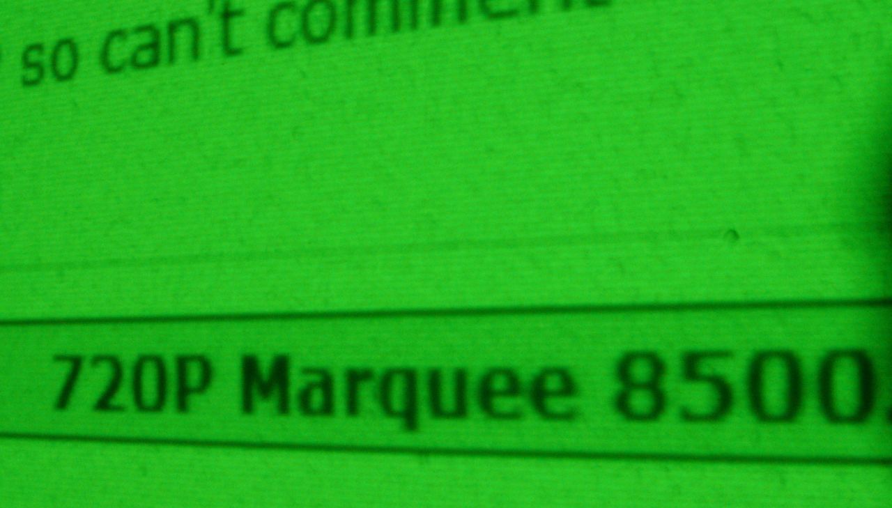

Posted: Sat Oct 13, 2012 6:11 pm    Post subject:
here's a pic of 720P on a 52 x 96" screen w a standard air coupled 8500 and HD-8 lenses. The gaps are about .7 mm tall, so the scan lines are thicker than the gaps between the lines. I was not able to capture the scan lines on 1080i, the camera was too slow, but I can definitely see them. IF you calculate that 1080i is drawing 540 lines per frame vs. 720, then the gaps would be about 25% larger on 1080i and it's bothersome as I do see them. That along with the flicker at 60hz doesn't work for me.
Of course 1080i 96hz would very likely be great, but I don't run a VP so can't comment
 Filesize:  94.66 KB
 Viewed:  2233 Time(s)
Posted: Sat Oct 13, 2012 9:28 pm    Post subject:
Redo your astig, but make the dots taller than they are now.

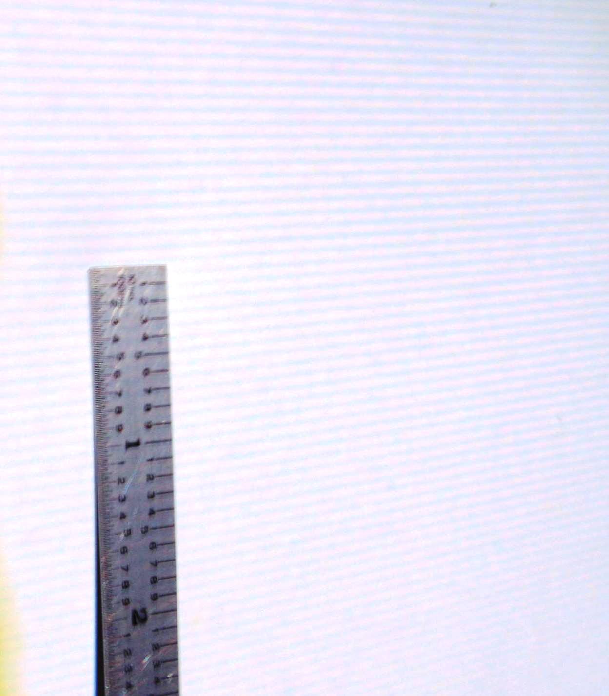

This is my screenshot at 720P-72Hz with my 6PG xtra with HD-6C ML lens. I sit at 1,6x screen width so I barely see the scanlines normally.
6PG xtra in 720p-72Hz with HD-6C ML lens
 Filesize:  81.17 KB
 Viewed:  2221 Time(s)
