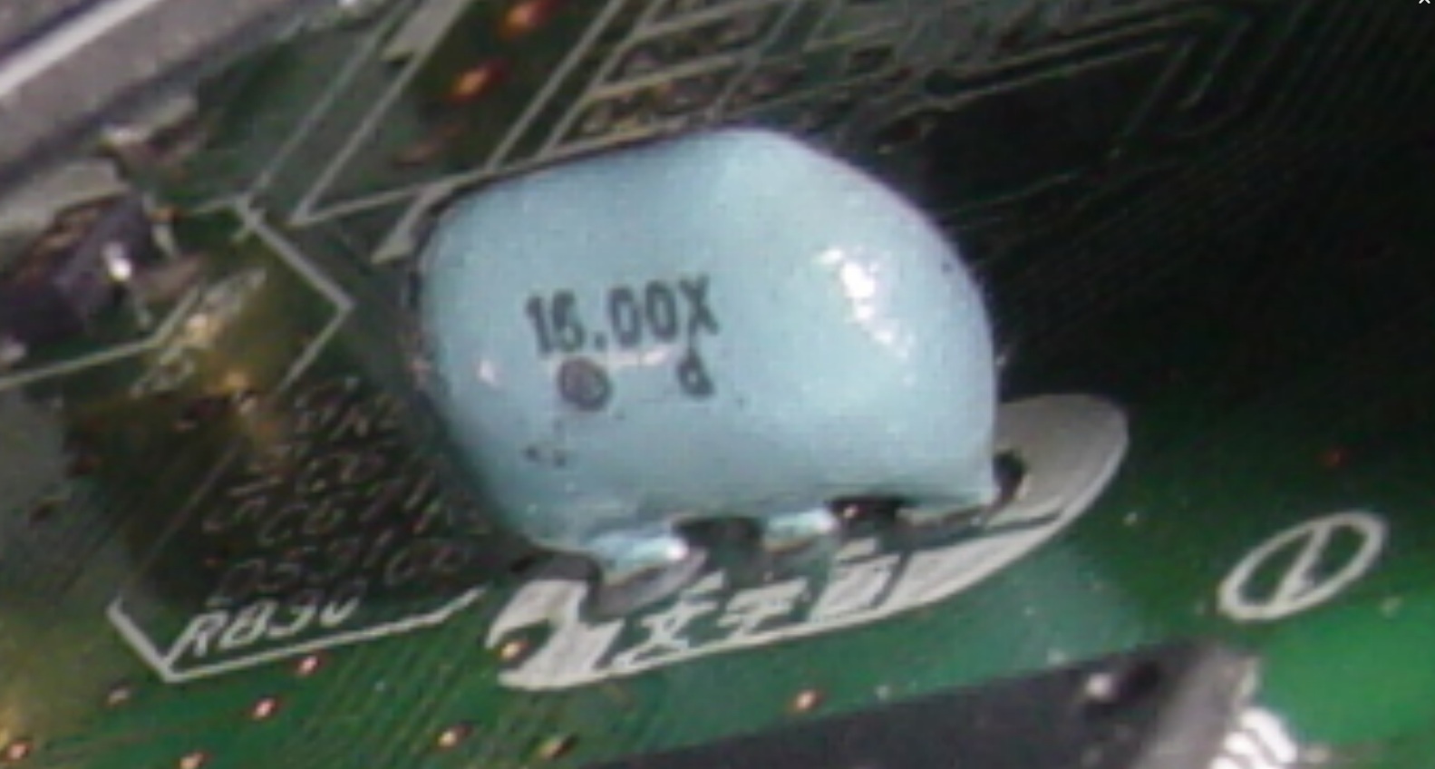

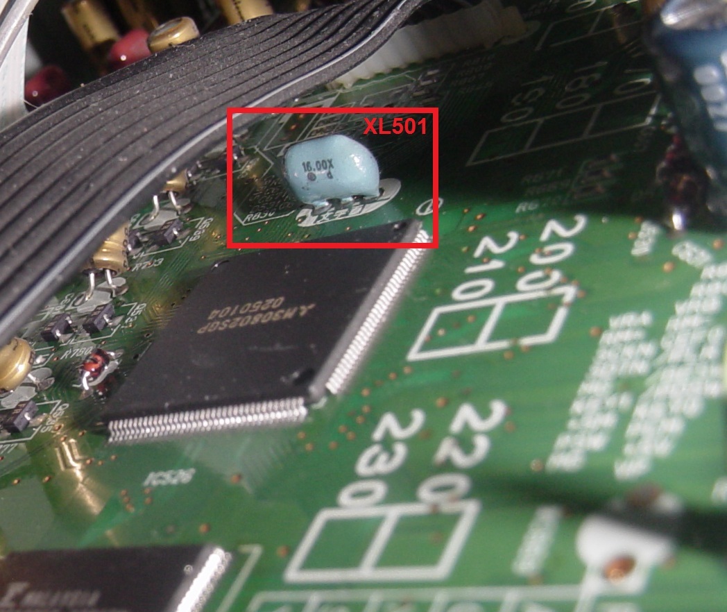

The crystal by part number is not available. So we need to order it by type, style/size and frequency. So I need you to snap a picture of it so I can see what style it is. I already know the frequency and type.

Posted: Tue Oct 16, 2012 2:49 am    Post subject:
Ok, I finally got a picture taken.
The picture is misleading - it actually says "16.00X".
Reference 2 pictures (wide and closeup).

Posted: Thu Oct 18, 2012 7:19 pm    Post subject:
This appears to be the one you need. I couldn't find a datasheet for the original but the only thing you would need to look at would be the size measurements. Other wise it should be correct.
