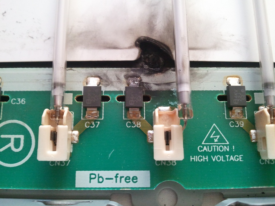

Ok I got into the light box and it's pretty obvious where the problem is. There is a nice burn under one of the bulbs. Any hints on removing the bulb without snapping off the little plastic clips?

Is it common for it to arc to the metal housing like that?
Posted: Fri Sep 21, 2012 12:01 am    Post subject:
It will usually arc to gnd when there is a bad lamp. I would also check that cap for short. You could also try swapping that lamp in another position and try to connect everything with the lamp box open and power it up and see if more then 1 lamp doesn't attempt to light before shutdown.

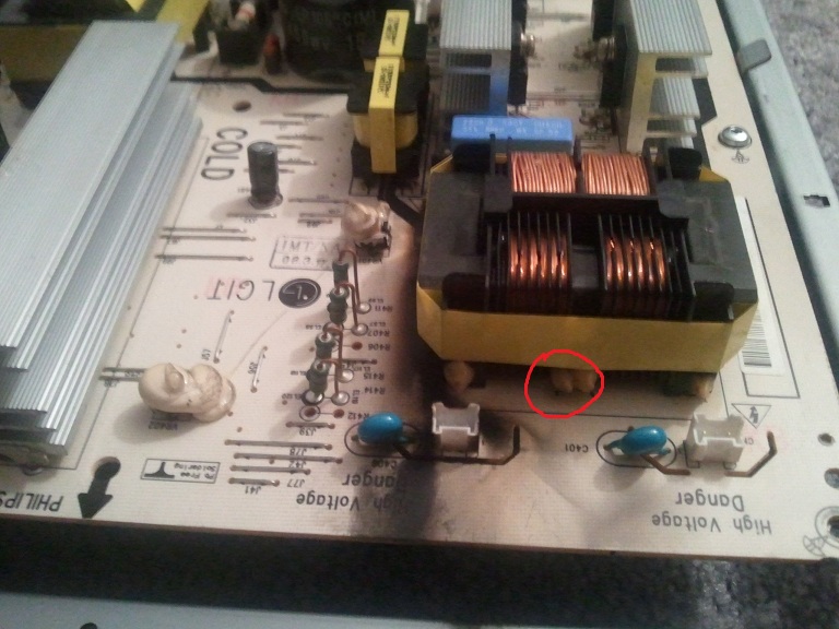

Ok I hooked it all back up and it looks like ALL of the lamps are trying to light up for a split second, even the one thought to be bad. However, I noticed a zap sound coming from the power supply when the lamps turn on. I dimmed the room lights and plugged the tv back in. Sure enough, I could see a spark around the area circled in red in the picture. This is the secondary side of the transformer correct?
 Filesize:  143.26 KB
 Viewed:  35 Time(s)
Posted: Sat Sep 22, 2012 12:23 am    Post subject:
Is that the replacement transformer from the other supply?

Posted: Sat Sep 22, 2012 1:13 am    Post subject:
Yes it is. Perhaps I bridged it with solder?
Posted: Sat Sep 22, 2012 3:02 pm    Post subject:
At this point you have so many things wrong it's hard to determine where to go. You definitely had arcing in multiple places. The burn hole in that board may have an open connection somewhere. I would probably push it aside until I had another tv with the same boards and test your current boards in it, so see what is good and what is bad. It could still be a bad lamp but it's still trying to light. Or look for a similar tv with a broken screen and just put your screen in it. Those screens interchange with a lot of different brands. Check that other one you have with the broken screen. It may interchange.

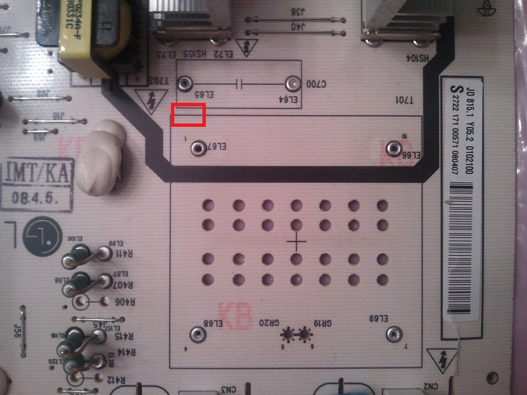

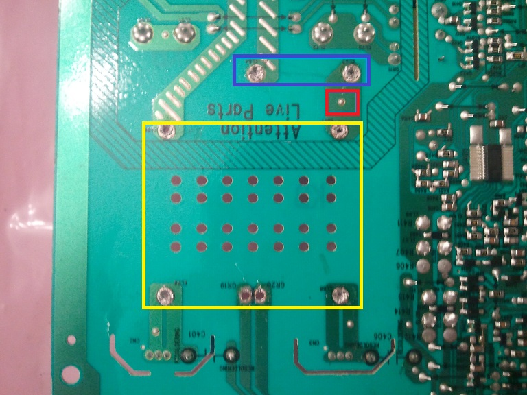

I ended up plugging the set directly into the doner set light box and get the same result. Lights try to come on for a split second and there is a spark on the same transformer.
Also, I took pictures when I soldered the relay and transformer to the board. There is one solder point, only on the bottom of the board, that seems to come from nowhere.
In the pictures, Blue box is relay, Red is the random solder point, and Yellow is transformer.
In the first pic, the red box indicates where the random solder point would be if it were on both sides.
