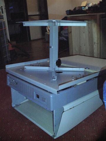

We're going to hang the bastard Twisted Evil
Fellow forum member Sisterofmercy convinced me and customized an old Barco-600 mount for me.
He's also working on my Sytem Control board to change some caps, which seems not so easy.
So uh, thank you, Sisterofmercy.

Posted: Tue Jun 18, 2013 6:11 pm    Post subject:
STOP!
There is not enough air gap for tha chassis fans, open a hole under the fans!
Posted: Tue Jun 18, 2013 6:13 pm    Post subject:
I totally agree, cut into the plate at least for the fans to blow through.
Just my $.02, I'd also take the metal cover off and leave it off, the one that covers the system boards. It hit me the other day that the boards hold in by themselves just fine, and the tiny holes in the cover really give no air movement. Take the cover off.
SisterOfMercy
Joined: 31 Oct 2007
Posts: 155
Location: Zwart Nazareth, The Netherlands
Posted: Tue Jun 18, 2013 6:21 pm    Post subject:
The plate is offset from the PJ by 30 mm. It has to be, because of the extra heatsinks that were added to the PJ once.
Of course I could make a few extra holes in the plate, no problem.
The kissing and the colour come crashing down
Posted: Tue Jun 18, 2013 6:26 pm    Post subject:
It looks much less on the picture, not that the 30mm is much, but in a typical floor mount setup probably there is even less space, extra holes surely would help to keep the machine cool though.

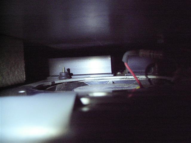

Posted: Tue Jun 18, 2013 6:31 pm    Post subject:
Yes indeed. the gap is actually larger than when the projector was sitting on its feet in a desktop-configuration.
You can see here that the gap just clears the heatsinks. That gap is indeed 30mm (= about 1.2 inch).

onkel fuchs' cheapskate cinema
NEC plain 9PG
Posted: Wed Jun 19, 2013 12:28 am    Post subject:
You have it attached the correct points? Not in the corners!!
I too would cut holes for the fans, and add some more fans to blow into that area where the focus and convergence boards are, cause that area gets effing hot.

Posted: Thu Jun 20, 2013 8:07 pm    Post subject:
What would be the problem with those points then? Twisted Evil
Posted: Thu Jun 20, 2013 8:11 pm    Post subject:
It turned out for a few times that the belly cranked and ruined the whole pj.
Posted: Thu Jun 20, 2013 11:53 pm    Post subject:
Those 4 corner points where the feet screw in are designed for holding the feet, not for hanging the machine.
The 4 holes about half way down on each side are for hanging.
DO NOT use the feet holes for hanging the machine. Youre asking for trouble if you do, and there is no reason to use them in the first place.

Posted: Fri Jun 21, 2013 9:51 am    Post subject:
Don't worry, it's already setup to use the ceiling mounting holes.
It's a shame, the thread of the feet is a nice size Smile

Posted: Fri Jun 21, 2013 9:54 am    Post subject:
No, we won't. Fortunately, it is possible to use the bolt holes halfway down.
It's a bit hard to see in the pic, but thanks for the heads up.

Posted: Fri Jun 21, 2013 10:16 am    Post subject:
Yeah mate they may look nice, but the chassis isn't designed for that as a hanging point!!
I made up some brackets for both my 9PG and my XG, ill take a pic and post it up soon.
Posted: Fri Jun 21, 2013 10:26 am    Post subject:
These are on the XG so i used them stock, the PG i cut them for the fans.
