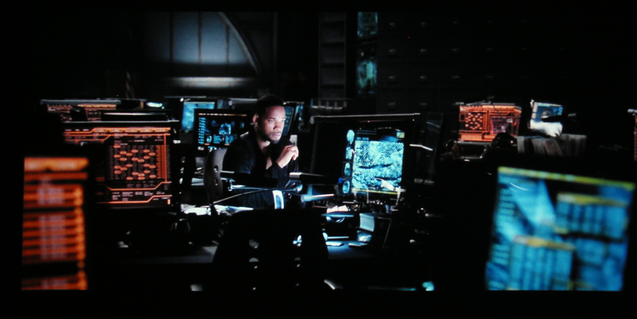

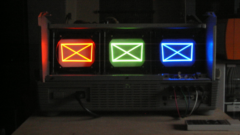

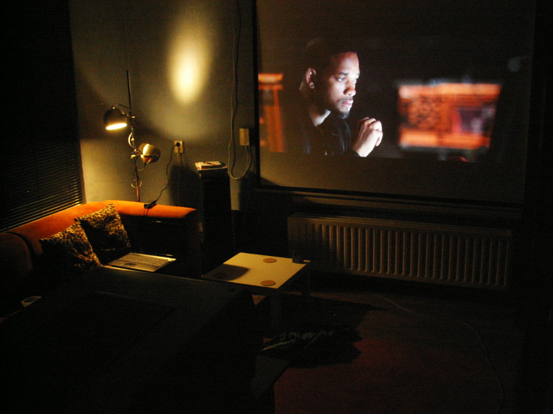

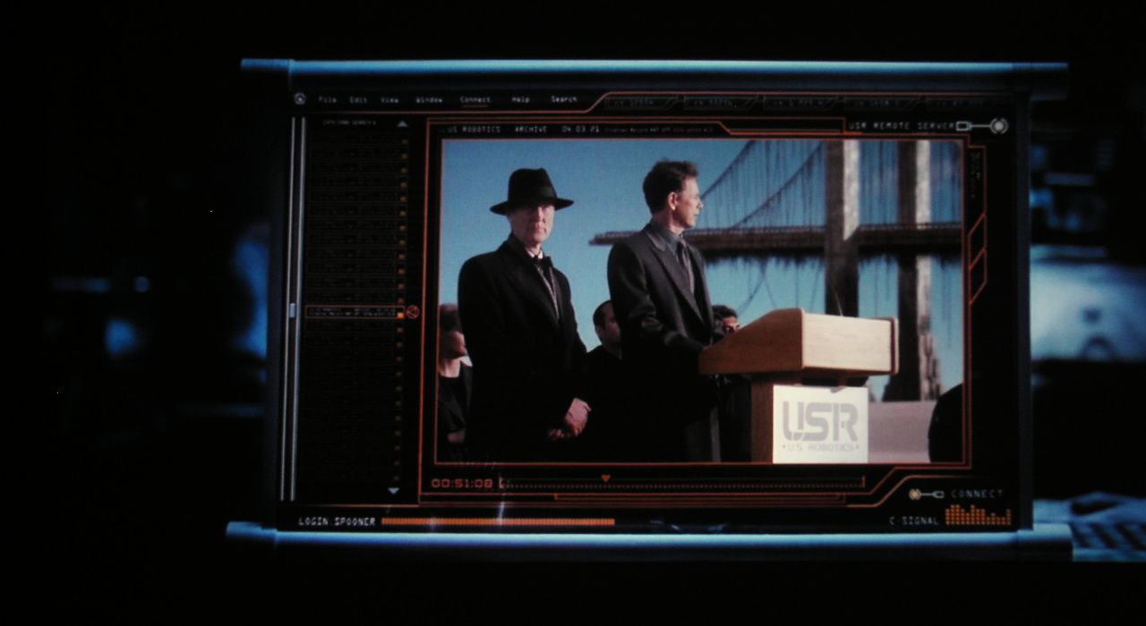

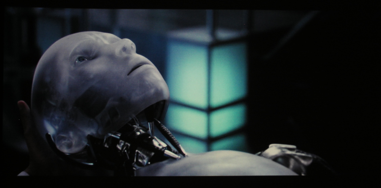

Posted: Thu Apr 11, 2013 8:48 pm    Post subject:
Okay, so I liked the extra width but not the LCD projector.
During christmas sale, I got me a 7' (2m) electric screen Very Happy
Projecting on the wall was nice to begin with, but I didn't really have any space to go any wider.
It was a good time to try and re-set CPC/Astig, and re-set the image on the centers of the tubes.
I think I understand the importance of the CPCs better now. It seems related to focus at higher light intensities, kinda determining the 'landing zone' of the higher intensity signals.
I don't like working so close to high-voltage, but it was worth it. Less pixel smear when turning up the contrast.
I've now set it up in 720p @ 72Hz. I've reduced the H-porch settings by about 100 pixels, so I can use about the maximum width the projector will allow on the tubes. I figured that the extra heat generated on the sides would be compensated with the lower height of the (widescreen) picture compared to 4:3.
I haven't finished point convergence yet, but I'm pretty happy with the results so far.

Hey, that looks pretty good! How is your syncing problem?
I have to adjust focus and astigmatism on my boss' 9PG, now it is soft like an ES machine, but it has been recently recapped and the whole unit has about 800hrs in it... I have a 6PG xtra and I really like it, but never saw a good PG plain in action, and am really curious about it.

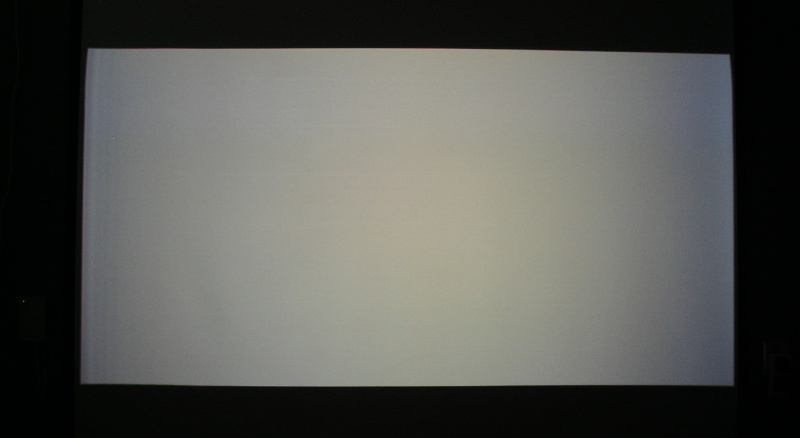

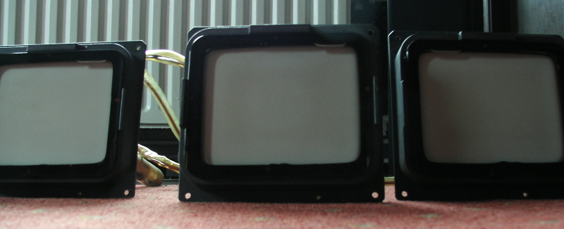

If you're wondering why I probably won't repair this projector, I've attached a picture of a 75%-white-projection.
The picture is more-or-less accurate, including the hotspot. It's just not worth it.
This is actually not so noticable in watching movies, so I'm happy with it as-is.
Maybe I'll move the projector back a little.

Bleed those tubes Onkel!!
Good thinking. I've contacted the previous owner about this, he has already done it a few years ago.
Do you think the bleeding should be repeated every so-many years?
Yes!! I had not done this to my NEC XG when I first purchased it, it was because of the pressure in the liquid chamber of the tube that cracked my green CRT, and the glycol leaked inside the tube (thankfully). I immediately shut the projector off, took the lens off, & sure enough, half the glycol was in the tube face & there was a nice internal crack on the phosphor face of the CRT.
So DO bleed those CRTs!! They will save you time & money. Its pretty straight forward to do, there is a topic on the site under advanced procedures on the top of the site.
Worth doing before it busts, especially if it leaks all over the circuit boards.

It's sad, you really loosing precious bandwidth with pushing the 720P in to the 64kHz range, there will be no drawback of squeezing the vertical height. You should really take the time to repair that board. Maybe your board only need readjustment, if you have an oscilloscope, and can handle it, I could help you what to measure and how.
Otherwise, guys are literally throwing away NEC PGs, so you can get better working DEF boards next to nothing.

I think my PG xtra is pretty sharp, with a careful setup the scanlines are just touching at 720P, an other thing that I've noticed the PG xtra has smoother menu control, adjustments are finer, and have more convergence options (independent focus on all edges, independent keystone on all edges, dynamic astigmatism...)

You should bleed if there is no bubbles and you dont know when it was last bled, a few years ago by previous owner doesnt mean anything if there is no bubbles.
In terms of sharpness, the 9PG i have is very sharp, on 1080i the middle is almost as sharp as my XG, however the edges are not. For 2 reasons, its not as sophisticated electronics wize ( although still more so than almost any other projector in its day ), and its got HD-6 lenses instead of HD-144s. If yours isnt ultra sharp, you need to work on the focus, which youre going to get a chance to do after you bleed.
When doing alignment, make sure all images are centered and line up in the center of the screen WITH THE LID SHUT!!! Dont use static to get them lined up, its really not that hard to do this right.
To get the lens focus perfect, display a white screen, totally defocus electronically with focus pots on DEF board, then use binoculars to see the screen and turn lens barrel til you see the phosphor grain snap into view. Do the outer the same way, and make sure youve got the flapping rings the right way up, there is a little arrow on them, hopefully youve got a full set of the right ones Wink
Set all focus settings to zero before doing astig, then before you do focus pots, turn off blue defocus, set center focus to -10 on all 3, focus with pot til razor sharp in the center group of Hs. Do the outers using the menus, but the center should stay on minus 10, cause that is where you set it before. Last thing you do is turn blue defocus back on.
I have not touched the convergence on my 9PG in over 12 months now and its pretty much right where i left it, no good reason it should move if you do this right Wink

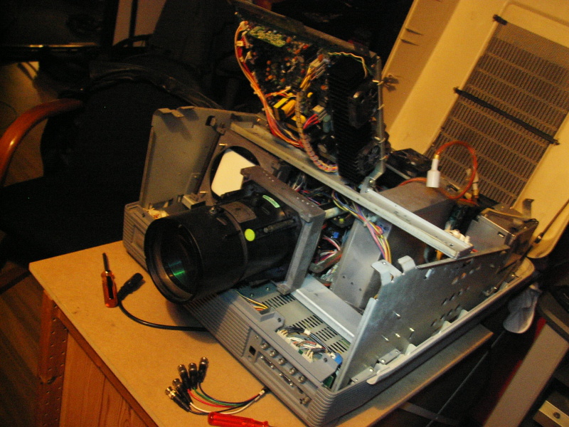

I really, really, hate you guys Exclamation
I'd rather have had the illusion that everything was just fine. Wink
There are indeed no bubbles in any of the tubes.
Thanks for the extensive how-to, Curt.
You've probably heard that before.

It felt more like a rite of passage, unscrewing tight phillips-screws at the end of a thin glass tube neck.
And again, almost stripping the tight red tube's bleed screws.
And buying a syringe without trying to look like a junkie Mr. Green
The bleeding was not spectacular, the glycol just slowly came out a bit.
I've found some new screws to put back in. Do I clean with alcohol or something like that?
