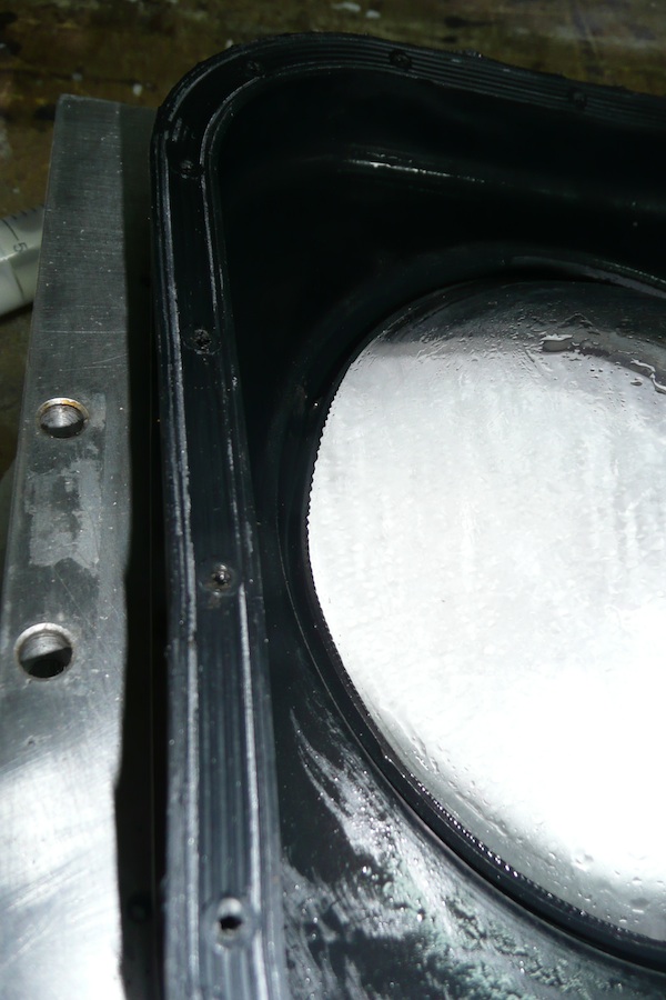

I managed to remove the bellow without damaging it. Also no rtv residue was left on the bellow. I guess I can try next time mounting it without the kit.

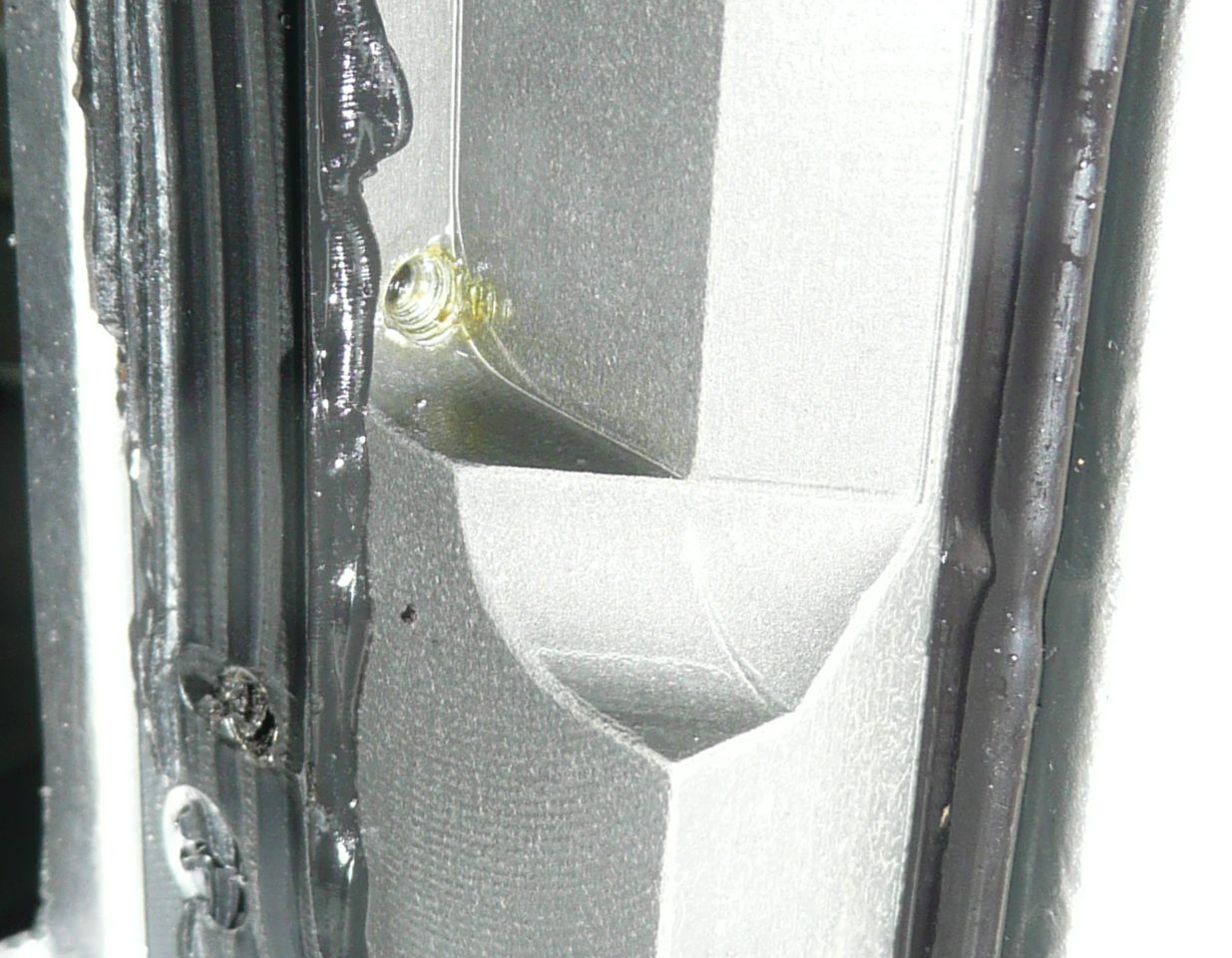

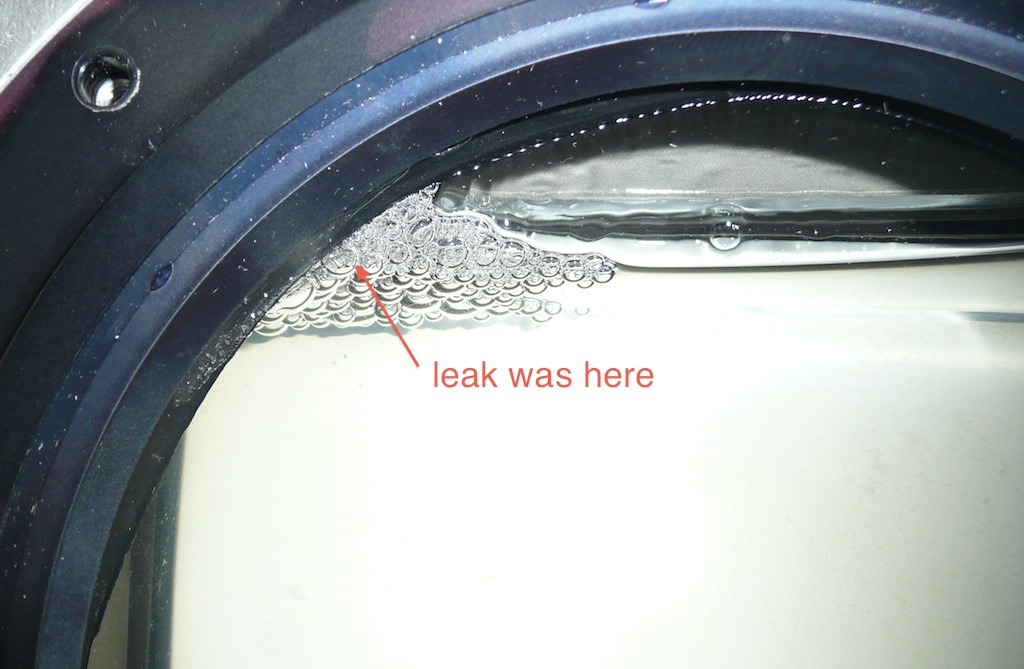

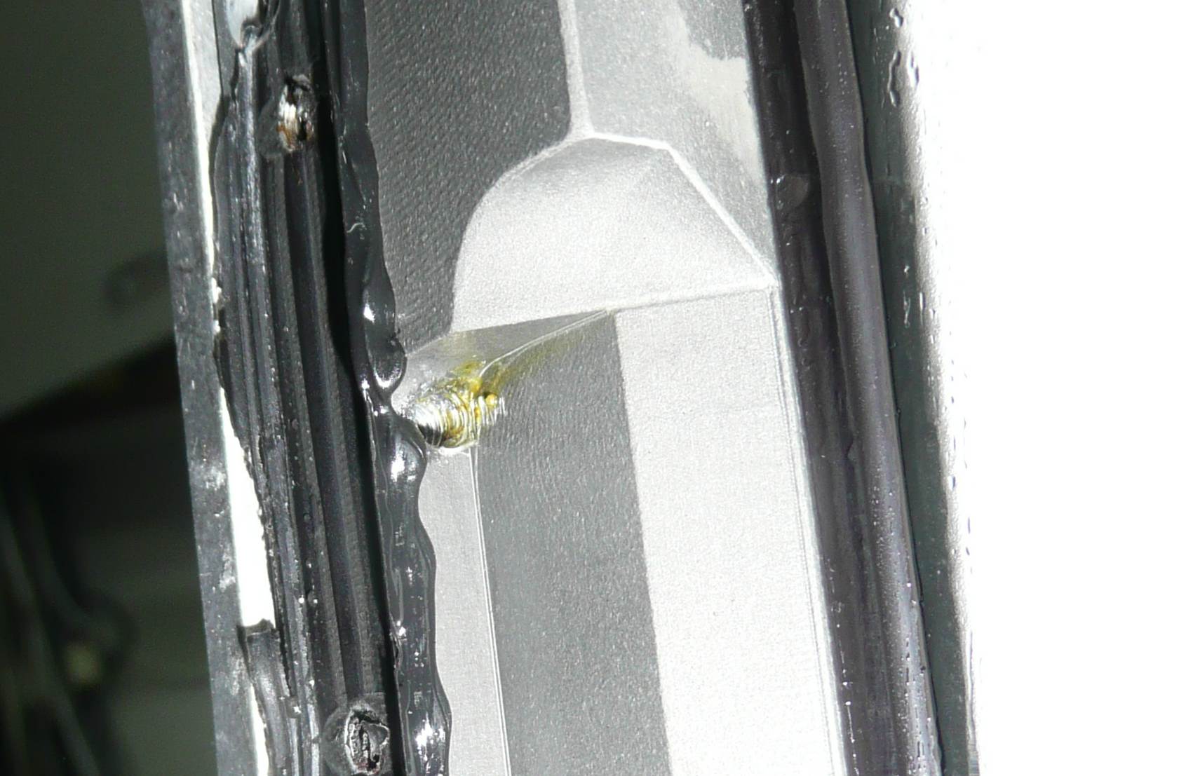

I've posted a few pictures so that you can easily see where the leak was.
I have also a close up of the fill holes.
Athanasios there's one picture with the bare bellow in the lens plate and you can see that the rubber is somewhat small compaired to the lensplate. Is this normal or is there something with the bellow? can I re-use it?
I'm going to paint the anodized aluminium but there is still some residu of sillicon on it and therefor the paint will never hold.
What would be the best solution to take that of?
I guess if i take longer (stainless steel) fill screws that stick out a little then there is minimal risk of the glycol touching the fill hole?
What about some kind of plastic screws?
Is ther any special epoxy paint that I should use?
A lot of questions but I want to do it right this time.
