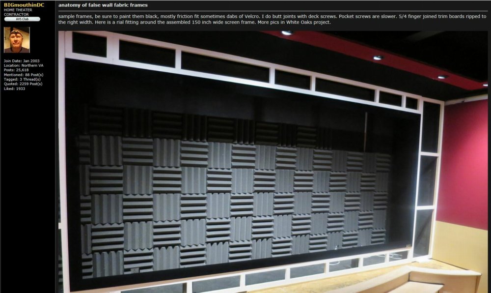

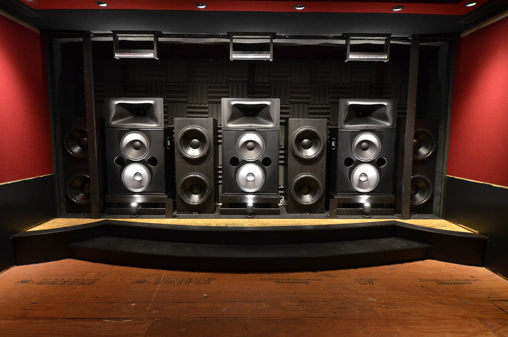

One nice thing about an AT screen wall, is it can be easily rebuilt, down the road.
Why would one need the screen to be hinged? BigmouthinDC on AVS did a really
minimalist front AT wall and hung the AT screen on three cleats, with a pair of lower
"bumper" posts. (killer thread "White Oaks Cinema build"). I think Big really moved
"the AT bar" with this new approach. Smile
The XD fabric is very nice. I've seen a RS65 on a 150" wide scope screen.
