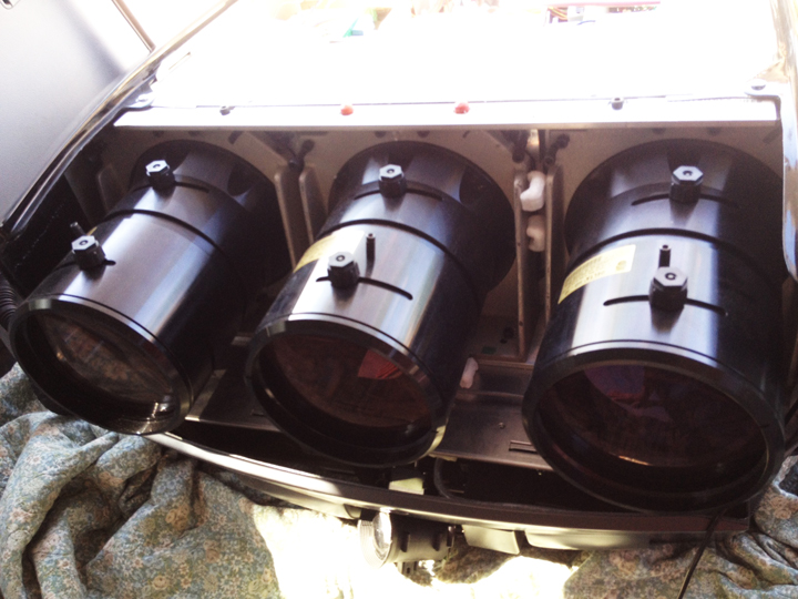

Here are all 3.
 Filesize:  280.38 KB
 Viewed:  9836 Time(s)
Posted: Mon Apr 23, 2012 12:53 am    Post subject:
The two PJ's are different Tube size's so you can not swap tubes or lenses. However every other board will switch over with the exception of possible the tube neck card or video amps as we call them VNB's ( video neck Board) .
These are very easy to work on and and also easy to trouble shoot. id keep them both for parts and try to get the 9 inch unit working.

First thing to try is to re seat all the boards in the PJ.
here is the layout fro the Marquee and clones. Curt used an 8500 not the 9500 fort he pics but they are the same PJ in essence.
http://www.curtpalme.com/ElectrohomeMarquee_Layout1.shtm
So now when firing up the 9500LC( 9 inch set) are there any error lights lit up on the Control board
in the rear of the PJ and look for any error lights up front with the lower power supply cover removed
on the Low Voltage Power supply(LVPS). it is locate on the bottom left front.
we'll go from there.

Oh, and since nobody's mentioned it... Since you're carting these things around in a van, the one with the metal lenses that you just picked up... Keep that bad boy out of the sun. If sunlight enters the lenses, it will damage the C-elements (lenses) attached to the tube mounts. They're a pain in the ass to replace. Just make sure you throw a blanket or something over the machine if it's anywhere sun might shine directly into the lenses.

Also I looked into the lenses with a flashlight as suggested and I see no burn or browning on the inside. Does that mean they should still light up?
From the pictures it is visible that the tubes do have some signs of wear. You can see that on the green tube especially where the center area is somewhat darker than the tube's edges. The wear itself won't be a problem as long as the new setup will produce an image on the tubes which stays inside the current area. Here's more information on this topic: http://www.curtpalme.com/TubeCondition_RatingChart.shtm
Using this chart I would rate Your tubes: Red -> 8, Green -> 7, Blue -> 7.
This type of wear shoudn't have anything to do with the tube's abillity to light up or not. Even badly worn tubes may still produce light. Unfortunately not the type of light which would be able to produce a high quality picture though...

OK, I'll start from scratch. Here's what I recommend:
Pull the lenses off both projectors. One bolt in each corner at the 2, 4, 8 and 10 oclock positions will take the lenses off. Post a pix of each set of tube faces. If you can see wear through the lenses, it will look worse with the lenses off. That's a starting point. Then, rather than jumping into messing with stuff at the chip level, let's see if we can't get the Vision 1 running.
Do not take any other screws out other than the ones that hold the lenses on.

Yeah, I'm pretty good a electronics tinkering but I don't think I want to go spraying Ito the unit at this point. I think for the time being I'll just worry about the one that works. Under the diagnostics on the non working unit I'm not getting any errors. It only flashes under "C" when any button on the remote is pushed. Same as the working unit. Neither flash any errors.
Posted: Tue Apr 24, 2012 10:55 pm    Post subject:
jsepps wrote:
Yeah, I'm pretty good a electronics tinkering but I don't think I want to go spraying Ito the unit at this point. I think for the time being I'll just worry about the one that works. Under the diagnostics on the non working unit I'm not getting any errors..
flashing C just means the control module is receiving commands. IT's either going ot be oxidation on the Horizontal board and it's daughter board (easy fix) , or a bad high voltage supply, also easy fix (swap).
However leaving the Vision 1 alone for now and learning on the Vision 2 is a pretty dam good idea. I have a very simple setup doc. with pics that's a lot easier to follow than the factory manual.
