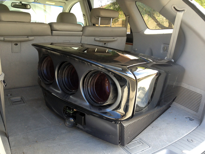

Hello all. I am new to the projector world quite by accident. I have acquired 2 real nice Vidikron CRT projectors and I believe the model is the Vision 2. They are beautiful and HUGE!! They remind me of a black Ferrari. I am not familiar these but do know they we $22,000 new. All I want to do is hook up a Playstation game system but the only inputs are the BNC RGB inputs. Can I just get 3 BNC to RCA adapters from Radio Shack and use my component cables?
Also I need to know how to flip the output so I can use them on the ground. As they are they are set up for ceiling mount. Since they weigh around 200lbs I don't see myself ever mounting them. How the heck do you use these things?
Thanks!

Hello
Component is not RGB; you need a device in between called a transcoder.
For floor use you need to move some plugs around, explained here: http://www.etechvideo.com/techtip3.htm

Forget the transcoder and get the HDMI card
http://www.curtpalme.com/VIM-FULLHD.shtm
Those are nice 8 inch units, but to make them even better get the HD 145 lenses and adaptors.

Aren't we discussing nuances when he wants/needs basics? Before you proceed, you might look into the tubes with a flashlight (gentle) to see if you can make out the condition of the CRT tubes' face. If they are completely and totally brown, gameplay is about all you might do - just get a transcoder as Nashou indicated. If they are nice, you might invest in a card like Nashou66 suggested and do much more than gameplay.
Regarding getting started, I'll presume you've read the primer and setup guides linked at the top of the forum and weren't too daunted by everything...don't worry, folks on here can help guide you through hiccups. Plug them in, see if they run, feed them a signal from an old PC/laptop using a cable with VGA by 5 BNC connector, and do a super crude setup -- you'll likely be surprised at how fast you can get a decent image. I could send you a cable for cost of shipping. Then, IF you decide to do more than gameplay AND want to spend a little time and money, read-up on here about some of the modifications others mentioned - the HDMI video input module, upgrade lenses/adapter kit, mods to electronics, etc. and decide how far you want to go.
People on this forum are fantastic -- welcome and ask away!
BTW, if these PJs will be sitting in the car outside until a buddy can help lug them around, you should gently cover the lenses with something that won't let any light through -- I've heard people say the lenses can act like magnifying lenses and burn themselves up (some of partial-plastic lens materials). One step better (and save you considerable weight for moving) would be to simply remove the lenses -- 12 screws (need a long driver) should do it, I'm guessing. As an added bonus, doing so will let you inspect the tube faces much more clearly as well. Just be super careful not to scratch the lens surfaces that are closest to the tubes.
I agree -- post location and someone may well be close enough to come help you play!
