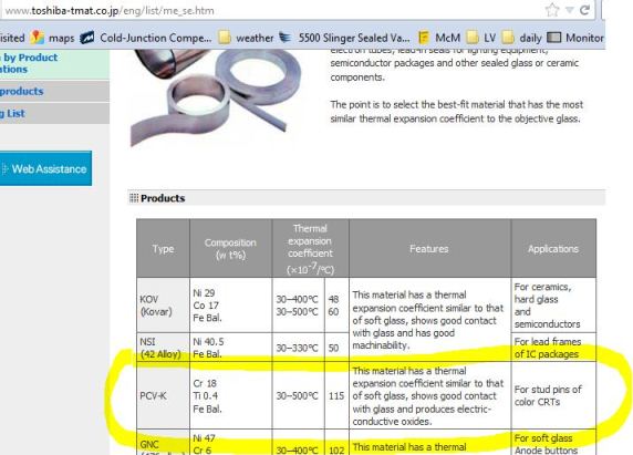

Posted: Mon Apr 02, 2012 10:10 pm    Post subject:
Something akin to kovar is being used. Possibly the material has been demagnetized as well. The image shows is a chromium, titanium, iron material Toshiba sells they call PCV-K.
Matt
pcv-k from toshiba...
 Filesize:  48.66 KB
 Viewed:  9216 Time(s)
Posted: Mon Apr 02, 2012 11:04 pm    Post subject:
Interesting again. Titanium is not magnetic, but that's a very small amount. Chromium I'm not sure and probably more of an anti-corrosive, but the high iron content is magnetic. Of course you can't deny it says used for crt pins.
Not sure why you say demagnetized.
I like your findings though.
Posted: Mon Apr 02, 2012 11:10 pm    Post subject:
Of course this mixture kinda sounds like a type of stainless steel which would be non magnetic......but I think only if some nickel is added, which I dont see there.
