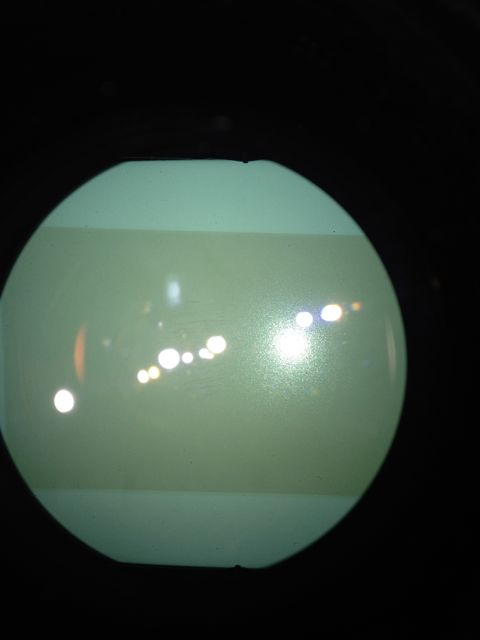

Ok, I just didn't want the thread to be worthless to Crabb...so in a possible forum first, here is one member posting pics of another member's new G90. Ok, so I only have the images of his IC421 and green tube's burn-in from the seller. Wink
I saw the burn-in and thought for-sure it'd need a new green tube soon, if not right away. That said, could Jeff live with it for a while until he can find one at his quality/price threshhold? That is, can he just drive the green tube real hard (for ever-shortening lifetime) and still get a decent image? I get the sense that some folks can stand pretty toasty tubes and others can't...is respectable color calibration still physically possible once they get this burnt?
Of course, he still has the mama bear of the G5/7/90 family in the meantime.

Posted: Wed Mar 28, 2012 5:28 am    Post subject:
Thats a pretty bad burn. Whites will have a significant purple hue. My 650hr G90 had much less burn, prob 9/10 but it was clear to see with my critical eye. I decided to get a new tube from VDC and have them install the correct green C-element (believe it was an additional $100). Its good to be able to achieve a proper green calibration but its not essential. The picture will look good even with the Sony OEM part.

Posted: Wed Mar 28, 2012 7:26 am    Post subject:
After 650hrs and burn in on a 9" tube??? Last year a friend of mine bought a raunchy marquee 9000, and I refurbished it, the counter said it had about 6000hrs in it, and during bellow replacement I could examine the bare tubes and it had NO wisible raster wear, all I could see is one shade difference in the color of the phosphor between green and the others but this was meant for the whole crt face.

Sony were notorious for setting the gain too high from the factory to boost output. The pic is plenty bright but if left at those settings will cause burn on the green very quickly. Since I wanted a pristine image decided to get a new green tube. The cost to have VDC install the new green into the LC housing, incl the darker C-element was about $1700, but that was about 6 years ago.
Posted: Wed Mar 28, 2012 1:03 pm    Post subject:
Mine has supposedly around 3500 hours on it and the tubes have been replaced once. Even then the green tube probably needs to be replaced again.
Posted: Wed Mar 28, 2012 2:18 pm    Post subject:
Guys, I just got in an 9000 hour G90. Roasted tubes throughout. Literally a 2-3 on the tube scale. Sold it to a customer that already has NOS tubes, so he wanted to buy burned tube sets. To make sure everything was 100%, I ran it for 48 hours, expecting a complete crap picture. To my surprise the image was still watchable. Yes, there was 20% more brightness outside of the wear area, but cutting back on the red gains and drives and boosting the greens gave it a far more watchable pix than I ever expected.
My recommendation with anyone getting a new-to-them set: Run the set completely as is for at least 100 hours. Get to learn how the set works, how it sets up, and check for any anomalies with it. ONce you're certain that the chassis is fine, then change the tube(s). I've never been fond of spending a bunch of money on extras when you're not sure that the chassis works 100%. Same with buying a used car. Make sure the drivetrain and electrical is fine before dropping a new engine in it.
