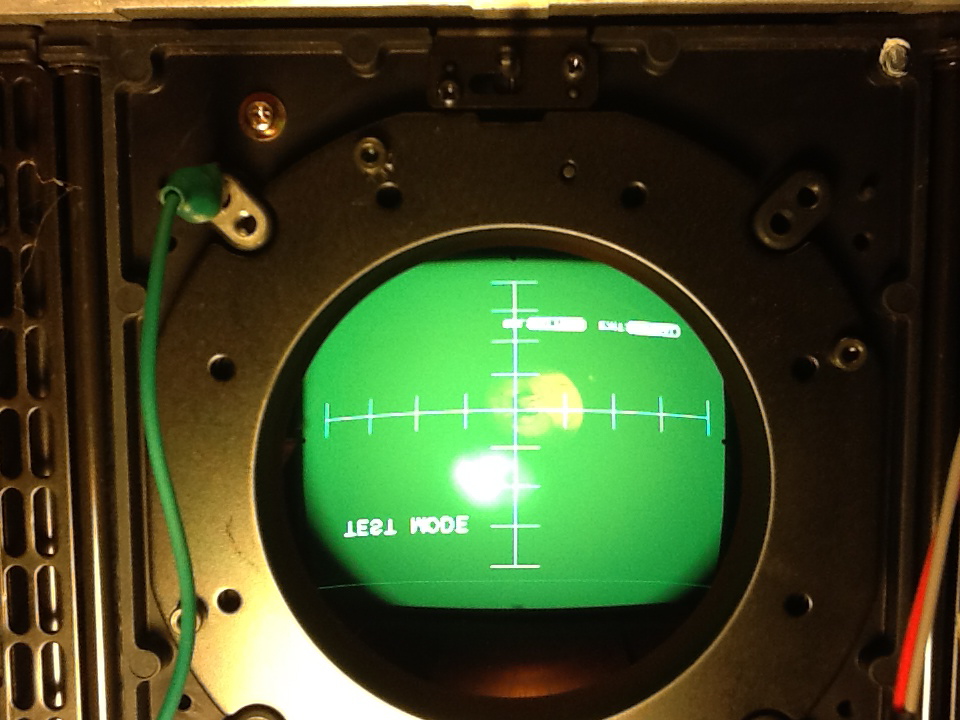

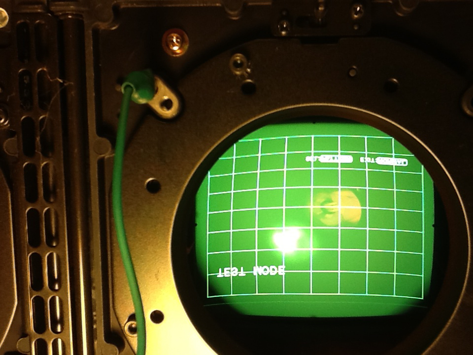

Hi Craigr
Been playing all day Smile
I've returned all to 128 using P2.
Took the lenses off.
Maxed out both V and H .
Below are pics of the Crosshair and Crosshatch pattern.
After I took the lenses off and was trying to center the Crosshatch on the green I noticed four little tabs.
I hope you can see the little tabs @ 12, 3, 6 and 9 o'clock.
Can I presume these tabs indicate the true V and H center of the CRT ?
1) If true, then when I center the Crosshatch on the tube face I will no longer be at 128 H - Is that ok?
2) in the Crosshair it is obvious that the H is too far north, in relation to the tabs @ 9 and 3 o'clock, even at 128.
It is also obvious on the top and bottom cross in relation to the tube's edge.
Although it is hard to see from the pic, the H is also a little skewed in relation to the tabs @ 9 and 3 o'clock.
- originally I did the DY angle adjustment on the blue and Red to match the Greens H.
But now I think I need to true up the green's H to the tabs @ 9 and 3 o'clock and redo R and B.
3) If that makes sense, then after that, I will center the crosshatch of all the tubes
and then rotate the R and B to match the periphery of the Green crosshatch.
I'm probably over thinking this but I'd rather get it right, right now, before my wife says "enough is enough" Wink
Thanks for all your help !
Greatly appreciated !!!
P.S. I definitely want to "squeeze out every last bit of performance" as this PJ is practically new
and I want to eventually play with 1080p.
Right now, with my setup, 1080p is definitely not possible.

AFryia
Posts: 965
Posted: Tue Feb 28, 2012 11:49 pm    Post subject:
No I don't think so. They may be close but it varies. It depends how the tubes were fit to the 'C' element.
Use the edge method to find true center.
bachiano
Posts: 163
Posted: Wed Feb 29, 2012 12:07 am    Post subject:
Hi Afryia.
I did a little more work this afternoon using the edge method and indeed the tabs are close but not perfectly centered.
The H skew on the green however, is a little off, I think.
It's a little lower on the left than on the right?
What do you think?
Can you see it in the pics?
I'm getting close Smile
Yes, those are center.
Yes, that is normal on a G70.
Since you know how to do DY coil adjustment that is what you should do. I like to zero out EVERYTHING when I do DY coils. This includes zone, pincushion, keystone, and especially skew.
Hit the screen with a laser level and then rotate the DY coil on green to match the laser. Then rotate red and blue to match green. Don't worry about vertical, just concentrate on horizontal.
The projector case will obviously have to be open while you rotate the DY. So be sure to close the case after green and make sure it is still on the level. This is double true for the blue and red DYs.
Yes, if you want to use the center weighted technique. As I explained, you will get better performance if you use the left and right side edges of the image instead of the center.
You're not over thinking this. It's complicated the first time you do it and getting it correct has a huge impact on the final image quality.
and I want to eventually play with 1080p. Right now, with my setup, 1080p is definitely not possible.
Than use the side weighted technique! 1080p should look very good on an optimized G70.
