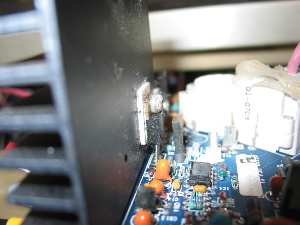

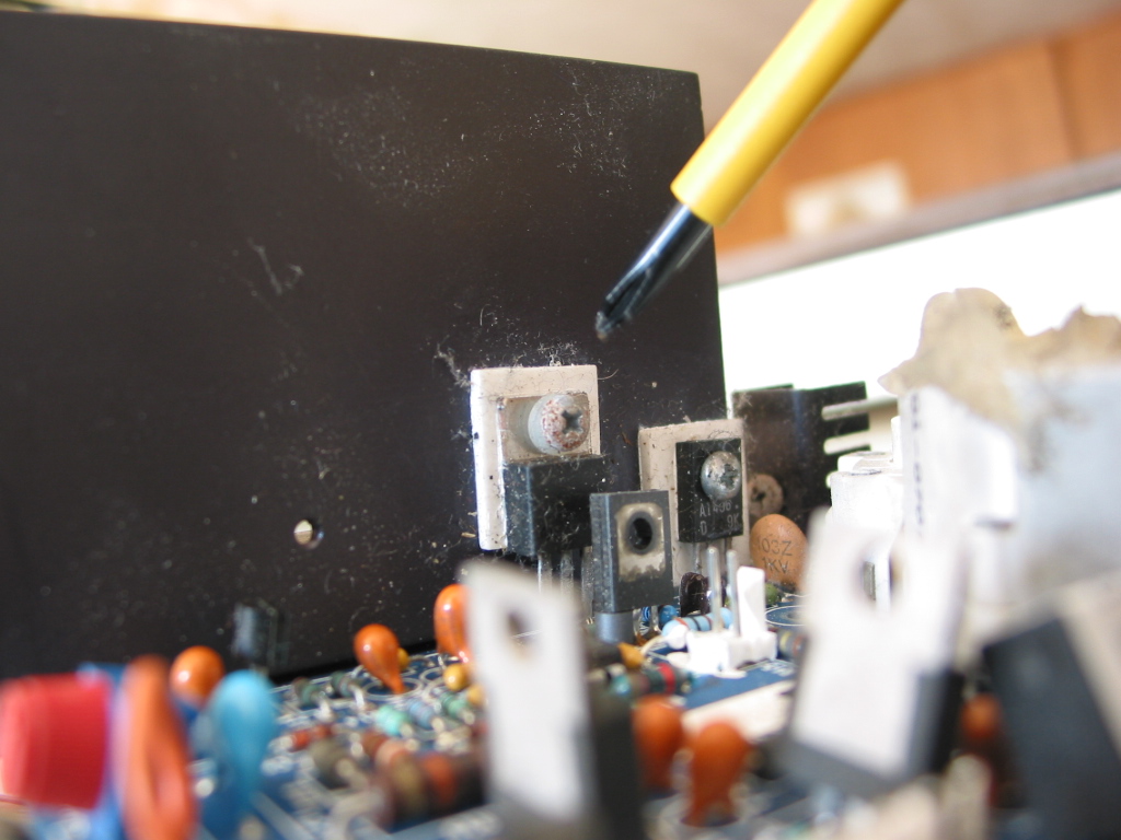

I have the 4000 neck cards out for swapping. I noticed one of the heat sink screws wasn't tightened down. I'll post a pic. I'm just wondering if this wouuld cause problems? Probably.
Pic to follow
Posted: Sat Feb 10, 2007 9:32 pm    Post subject:
Ok First here's the pic of the heat sink
The bigger of the two

A screw loose

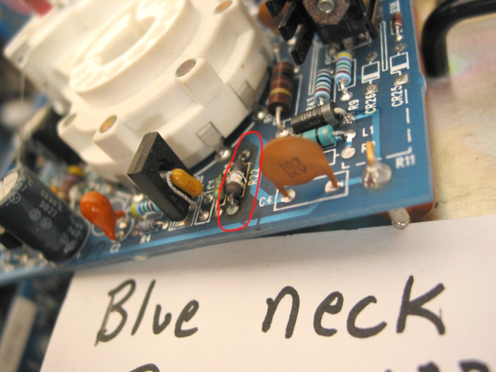

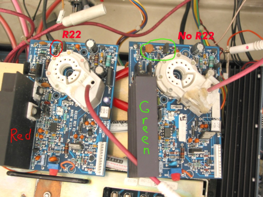

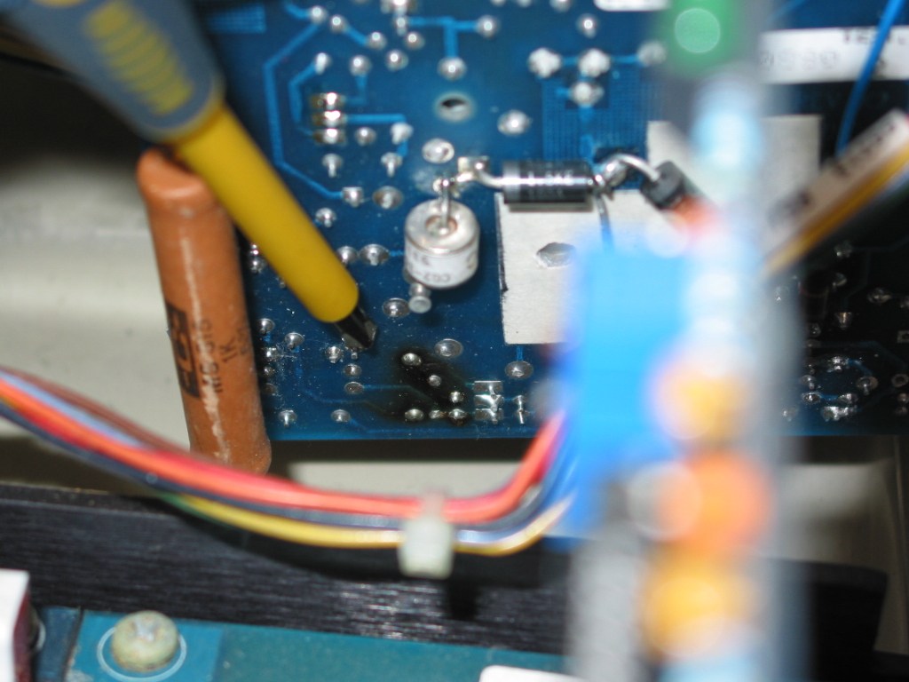

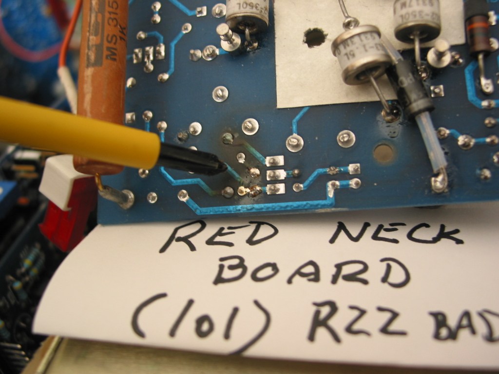

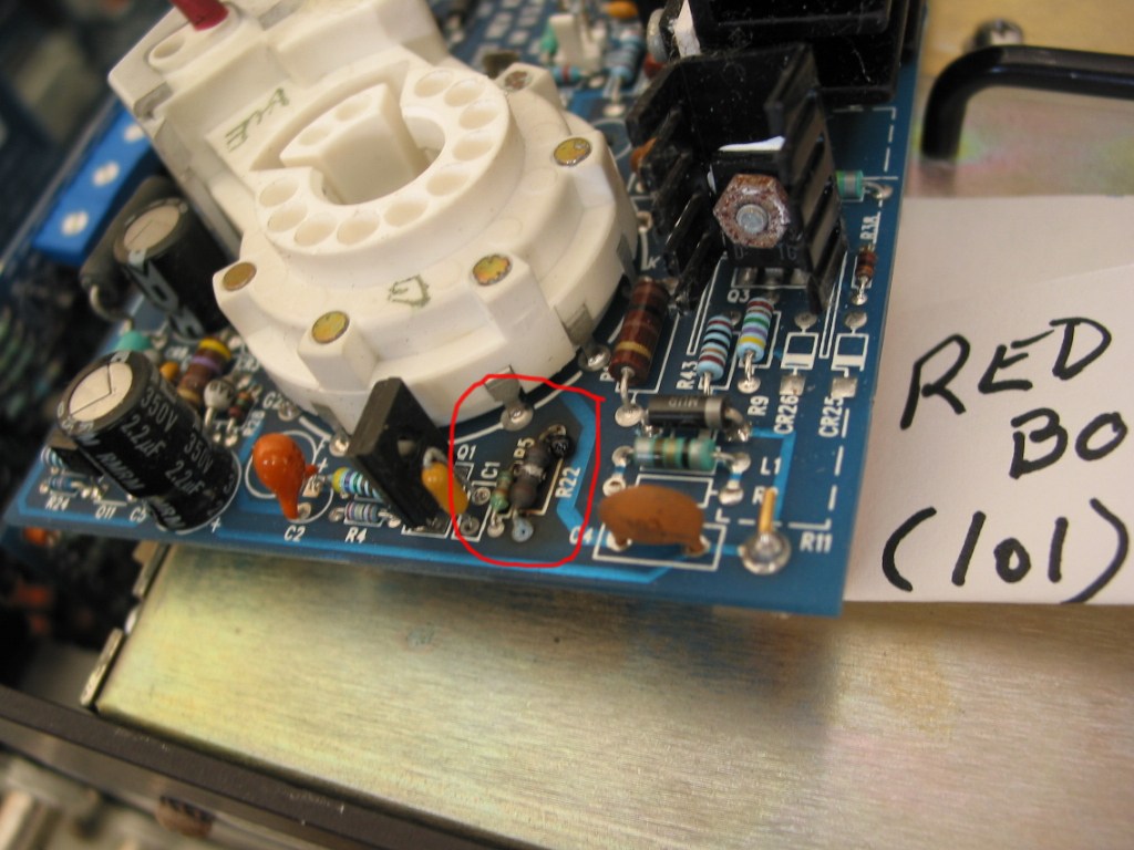

But I found a bigger problem. Two of the neck boards are of the same design. The Red and the Blue. They both have resistor R22 blown. The Green board is different. No R22 that I can see.
R22 blown on Red neck card LOL
 Filesize:  143.28 KB
 Viewed:  8233 Time(s)
Back side of red

Also R22 blown on Blue neck card

Similar burns on back of neck board
 Filesize:  112.84 KB
Different styles of neck board
 Filesize:  189.67 KB
 Viewed:  8234 Time(s)

Posted: Sat Feb 10, 2007 10:23 pm    Post subject:
The boards in my 4200 look like the ones with the R22,your red and blue.
I do love my AmPro's
Posted: Sat Feb 10, 2007 10:24 pm    Post subject:
Hmmm so I wonder which ones were the origional 4000 model neck board?

R22 fries when there is a cathode to heater short inside the tube. A major problem with Sony tubes. Later revision cards have a fix that consists of a diode and resistor put in series with the cathode. Most of the shorts were intermittant and would only happen for a few seconds then clear out and the tube would work ok. I'm pretty sure that the only thing blown on the CRT card was R22 and could be fixed by replacing.
Scott
