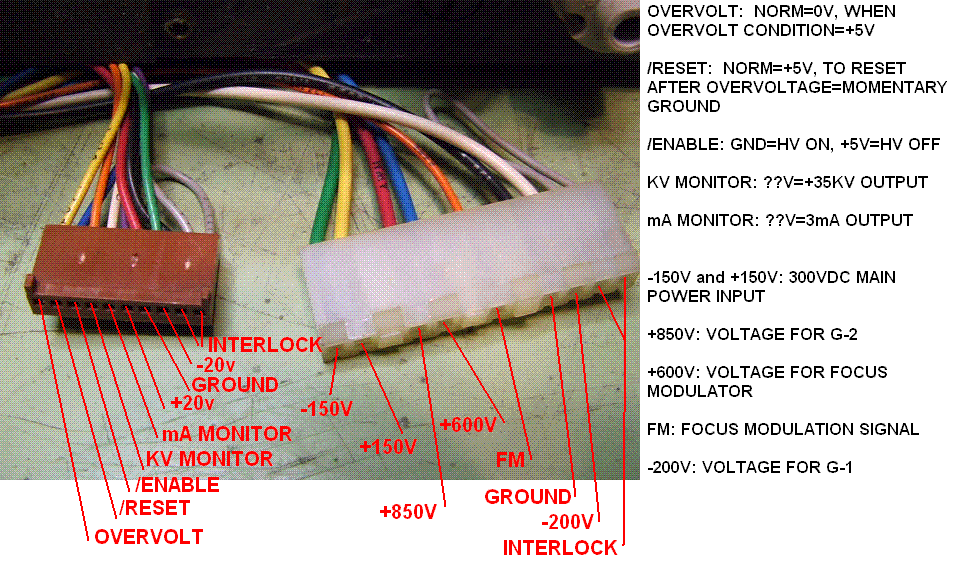

Posted: Sun Sep 14, 2008 5:48 pm    Post subject:
Check the /ENABLE to see if the CPU is trying to turn on the supply. If +5V it is not trying, if it is near 0V then the CPU is trying to turn it on.
If it is being told to turn on but no output check OVERVOLT to see if it is in a overvoltage condition. 0V would be normal, +5V indicates the supply has shut down.
Scott

Posted: Thu Sep 18, 2008 4:30 am    Post subject:
Scott
I'll have a whack at this next week. Having a crazy week here.

It was dip switch 3 on the CPU card.
When I fliped switch 4 the display on the remote asked for a password. Hmmm does the Ampro have a super secret menu we don't know about?
I didn't connect a source, I have the PJ off in a corner just now but the HV came up and the test patterns look fine. I even tried firing it up half an hour later ( which is when it died last time ) and it fired right up.
