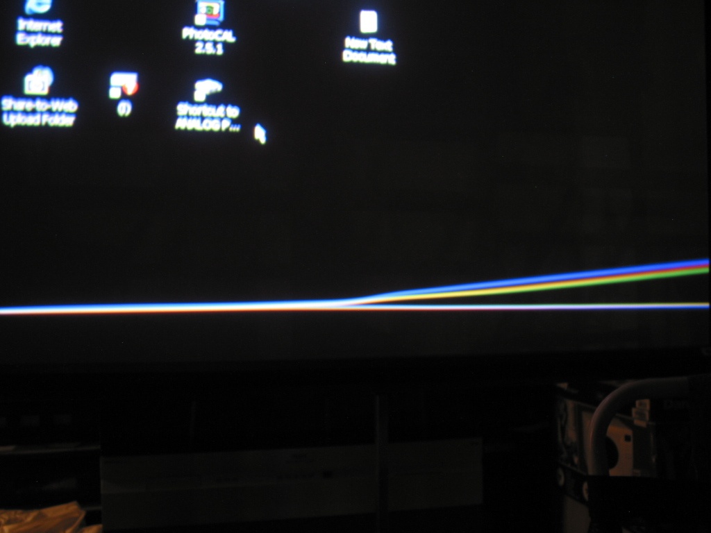

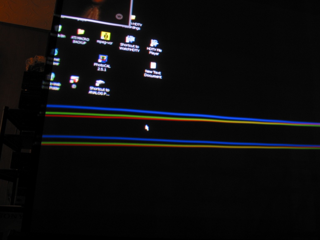

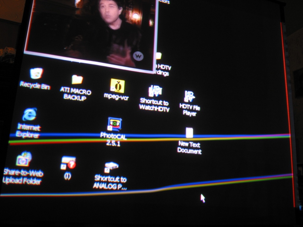

Onto the new problems:
Running off the HTPC with a new breakout cable. The beams are going crazy. Also I'm getting a dark horizontal line across the middle of the screen.
I'm thinking RGB input card maybe??
Here's a dark horizontal line I'm getting as well.
 Filesize:  116.33 KB
 Viewed:  8978 Time(s)
1280x 1024
 Filesize:  123.21 KB
 Viewed:  8979 Time(s)
1024 x 768 close up bottom right of the screen
 Filesize:  129.42 KB
800 x 600
 Filesize:  164.32 KB

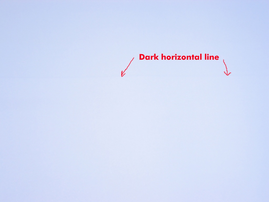

Posted: Sun Dec 10, 2006 7:56 am    Post subject:
Ok here's a better example of the dark line I'm getting.
Full white screen with dark horizontal line.
 Filesize:  100.07 KB
 Viewed:  8984 Time(s)

Posted: Sun Dec 10, 2006 6:09 pm    Post subject:
Any ideas on the dark line guys?
Try turning off the registration. 55 code.
Does the line move when you adjust vertical phase?
Any effect when top and/or bottom blanking is moved toward the middle of picture?
Scott

Posted: Wed Dec 13, 2006 2:28 am    Post subject:
Scott
Ok hitting 55 code makes the dark line go away.
No effect with any of the other controls. Vertical phase nothing, blanking top/bottom nothing.
Help.
