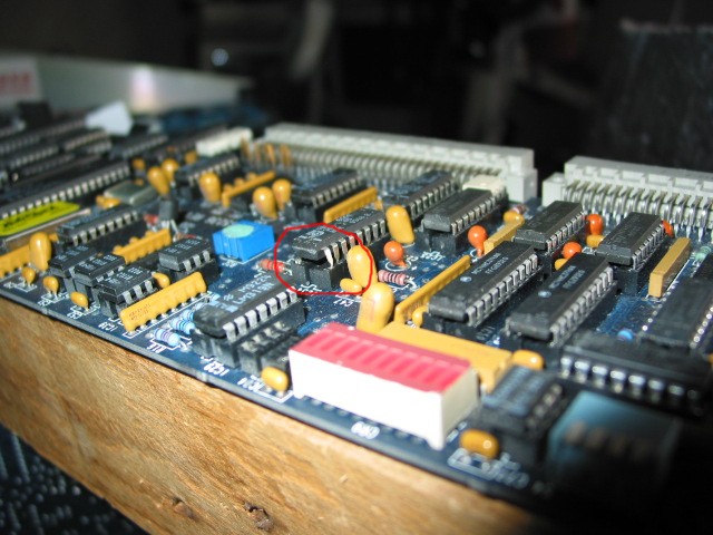

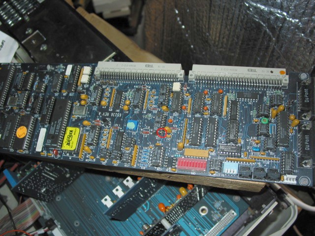

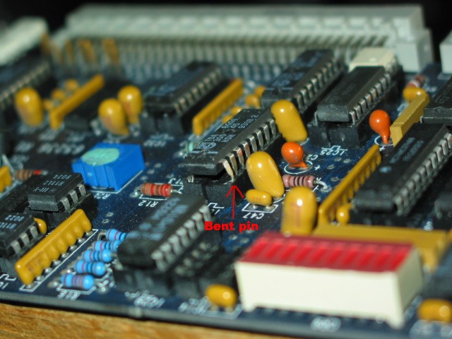

New fun, I farted around with the HV power supply last night. I got it back in, powered the projector up and got....no RGB or Quad decoder inputs recognized. WTF? Then I noticed this on the CPU board:
What kinda wierd and wonderfull stuff will this cause?

Posted: Fri Jan 18, 2008 4:24 pm    Post subject:
Just talked to Curt. I'm off to Sayel electronics to pic up an IC extractor tool.
Posted: Sun Jan 20, 2008 10:41 am    Post subject:
Bought the IC extractor tool. ($2.50) and a bunch of other stuff I probably didn't need ( electronics stores what can you do? )
I put the IC back in and it has been running stable for 8 hours or so. Cool. Thumbs Up

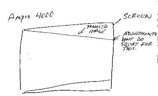

I have a geometry error that none of the adjustments seem to want to fix. See my high quality drawing below for details.

Posted: Tue Feb 26, 2008 11:39 pm    Post subject:
First check that the projector is not off to the right of center. You shouldn't have much of the distortion that you are showing. (That's if Master Top and Bottom Key are at 50% and projector is perpendicular to the screen). To access the controls press KEY button, then DYN. Press the button that selects top edge functions for Master Top Key and the bottom edge button for Master Bot Key.
Scott
