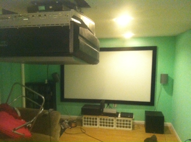

So while were on this topic of rooms, screens, and such. What would you guys recommend for this room. Be nice now, there's a WAF to consider. Something that would work with the maple floors but still be Videophile friendly. I know the White ceiling is a disaster but what would you do within the constraints of this space Color wise? I'm thinking a really Dark Blue on the walls would work well with the Gold floors. Then a Black ceiling and screen wall would be perfect but what color other than Black would you recommend on the ceiling if the ole lady really digs her heels in??

Man. What kind of jackass paints his room this way?!

Drags, what you can do there to help out with with light reflection is to add a curtain going across the entire room about 3 feet in front of the scree. with a valance that runs across the top just low enough to not interfere with the Image. Now on that part of the ceiling you paint it with a Black flat paint or get some flat black velveteen type cloth. Also you can paint the hidden part of the walls black too. When the curtains are closed it hides the screen, speakers, sub etc. If that Support Pole is close enough you can make that the point where the curtain begins, to me it looks about 3-4 feet from the screen wall. You could even make a riser on the floor in that area and cover it with Darkblue, black or Maroon carpet. Just a 6 inch riser would be cool and easy to build so it can be removed later and not hurt the hardwood. Use foundation foam under the frameing.

easy now, we're all here to learn and explore new things. Errr, ok that sounded weird and creepy Laughing
Drags, what you can do there to help out with with light reflection is to add a curtain going across the entire room about 3 feet in front of the scree. with a valance that runs across the top just low enough to not interfere with the Image.Athanasios
Nash I think your on to something.
H) Honey, I'm painting the home theatre room black and blue
W) Like hell you are
H) Ok then, I'm going to need you to sew me Black curtains to these exact dimensions. Mr. Green When your done with that bust out the carpet-makers loom for the floor

One more thing, I'm guessing a pro-calibration in that room as it is now would be a waste of money no?
I can just see the guy walk in, big frown crosses his face, followed by a lecture/scolding on proper color temperature and contrast ratio capability of a system which the room is a big part of, etc. Followed by a grumbling "I can't believe i'm being paid to do this" attitude Laughing
