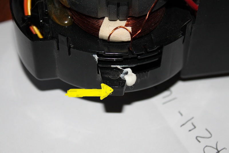

What I thought was switch is some adjustment. But would not move by just bumping it.
What does happen when you go into the 'kelvin' setting?[quote]
No change
Curt

Whatever that switch is, don't touch it! Disconnecting any yoke winding will instantly spot burn the tube if the set is on.

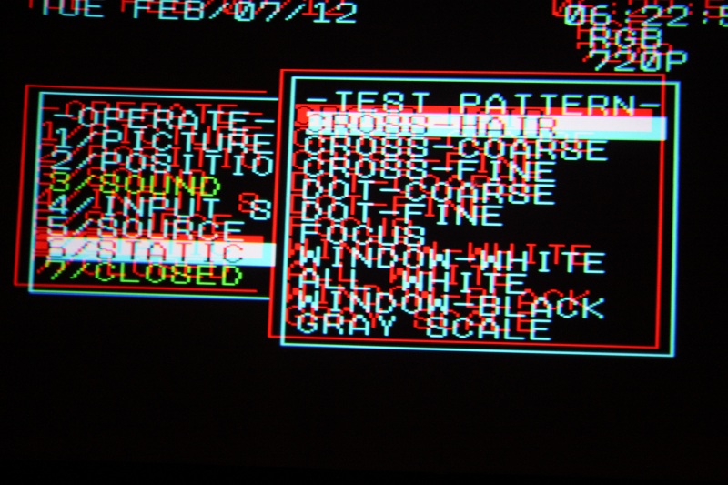

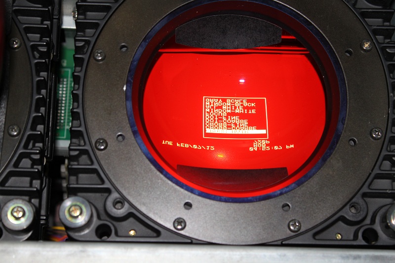

That is a pic of a spare yoke. I adjusted the red off center to show you the menu screen. When I go to any test pattern the blue and green are bright red is dim. I'm tring to give you as much info as I can so can send me what you think I may need to fix this. I will pm you with the board numbers.
The projected image on the screen
 Filesize:  168.15 KB
