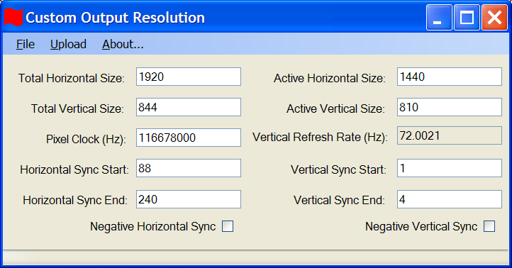

1440x810 is 16:9
I run this because it is exactly 3/4 the res of standard 1920x1080 and I figure that would be an easy clean conversion for the proc.
 Filesize:  31.03 KB
 Viewed:  12033 Time(s)

Posted: Thu Apr 05, 2012 2:11 pm    Post subject:
The HDM ringing is an artifact in the PJ resulting from running higher resolutions like 1080p; the beam doesn’t have the time to settle. By adjusting the porch settings, it’s possible to increase the overall size of the raster while keeping the viewable image the same size. This effectively shifts the ringing out of the viewable image.
The ringing was not an issue with DVD’s scaled to a resolution like 1440 x 960p. I ended up letting the BD player output 1080i/1080p for DVD. When using a SD DVD player into the Lumagen the image looked way too soft; regardless of resolution.
