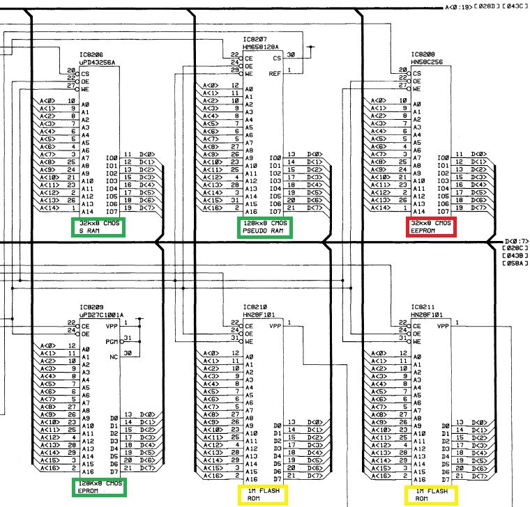

Thanks to gjaky I was able to take a look into the schematics and made my personal analysis of the problem. The following is based on my experience with digital circuits only and none of the solutions presented has been verified yet (I just don't have a NEC PG to test with)! I might be thinking wrong in any area and if so I'd like to participate in any further advanced knowledge anyone has.
1.) Who's the culprit?
When You look at the system board's schematic You might see that there's a main CPU (IC8201, µPD70325L), a slave CPU (IC8232, µPD50H), lots of memory devices and lots of interface circuitry. What we have to look at is the memory bank of the main CPU. Below is an edited excerpt of the schematic showing it:
NEC combined different types of memory devices according to functional and possibly budgetary requirements:
- One Static RAM, one Pseudo Static RAM and an EPROM (marked in green)
- Two Flash ROMs (marked in yellow)
- One EEPROM (marked in red)
I don't think that the RAMs or the EPROM can cause the symtoms as the are designed to loose memory at Power Off (RAM) or will retain it any circumstance (EPROM). Corrupt data in the latter would be a permanant problem. Further I don't think that the Flash ROMs can be held liable as those seem to be the location of the firmware and are only reprogrammed using an external connection. To me the most likely device containing the settings is the EEPROM!

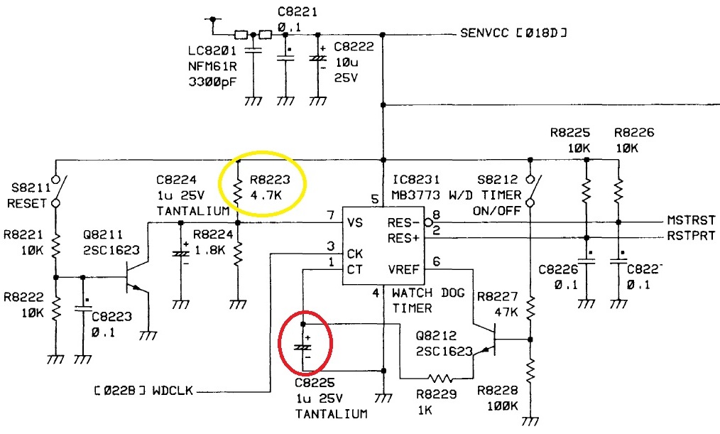

First a picture of the schematic section:
If the CPU starts messing around with address and data lines before the EEPROM is ready this could result in corrupted data too. The CPU won't start any activity as long as its Reset line is active (low). The system board has a special circuit for a defined Power-On-Reset (IC8231, MB3773). According to its data sheet the duration of the pulse is determined by the capacitor connected to its pin 1 (C8225, 1µF tantalium). Increasing its value will enlarge it and will therefore keep the CPU on hold for a longer time (linear increase). I'd try other values up to 2.2µF if available using the same type of capacitor.
c.) Raising the Power-Good trigger level
The same device (IC8231, MB3773) also does supply voltage monitoring. It will keep the Reset lines active as long as the supply voltage hasn't reached a specific level. According to the data sheet this level is determined by the voltage on pin 7 and this level is set with two resistors (R8223, 4K7 and R8224, 1K8). With the current resistors this level should be somewhere around 4.3V. For the fault scenario this might be too low. I'd try replacing R8223 with an 1% 5K6 resistor. This should lift the trigger level to about 4.5V and might be safer. Caution: Higher values for R8223 could raise the level above normal supply voltage! The CPU would be held in Reset forever!!!

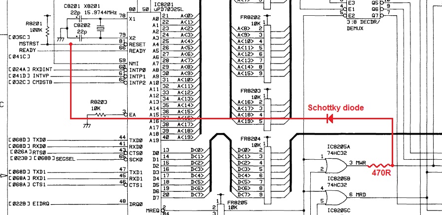

d.) Enabling Data Protection on the EEPROM
Right now it's only the CPU managing the control lines of the EEPROM. If the CPU is operating in an undefined state those lines may be fluctuating uncontrollaby too. Gladly, the EEPROM designers have forseen this! Another look at the data sheet reveals a Data Protection mechanism on page 18:
The EEPROM should be kept in unprogrammable state during VCC on/off by using CPU RESET signal.
To realize the unprogrammable state, the input level of control pins must be held as shown in the table below:
-> The table shows that either CE or WE should be high or OE should be low
My idea consists in rerouting the Reset signal so that the Data Protection stays active as long as the CPU receives a Reset signal. Please see my modification in the picture below:
The Reset signal is taken from the CPU's input (this is coming from IC8231, MB3773) and is connected to the output of IC8205A (74HC32, quad OR gate) via a diode that should have a low voltage drop; therefore I would recommend using a schottky diode or something similar. The diode seems to be reversed because we're dealing with an inverted logic: Draning away the voltage makes the line active. The diode is a must because otherwise any activation of the OE line by the CPU would trigger a reset. In order to protect IC8205A's output from being damaged it has to be buffered with an additional resistor (470ohm). So even if IC8205A's output is high (5V) the OE line can be pulled low (0V) by IC8231 without damaging either circuit's output. It could be possible that the resistor's value is too high. I wouldn't go below 250ohm because the current flow would raise above 20mA which is the current limit of both devices.
