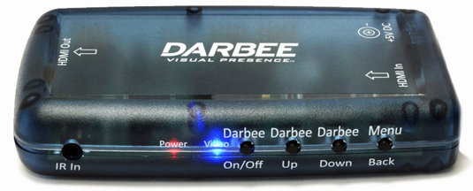

I just got one. I connected it between my receiver and the TV. Black screen and no audio with intermittent (a second or two) bursts of sound. Vendor says use longer cable. This, if true, would be a violation of the HDMI standard.
Connected the Darbee directly to the cable from the cable box rather than the output of the receiver, and the output (same cable as before) from the Darbee to the TV. Works just fine. There is more to the problem than just the cable length from the Darbee to the TV.
I am suspecting failure to properly provide the bi-directional signals on the HDMI cable. If it really is sensitive to the cable length from the source; significant internal problems. Standard simply does not support that behavior.
Also: sloppy/loose power plug connection. Stupid useless (and very bright) LED on power supply. Short PS cable. Silly warranty.

Not necessarily. Could simply be that the receiver/Darbee combination is causing an issue with the short cable, while neither the Darbee or receiver would on their own.
No. If this is your suspicion, you don't have much experience with HDMI and a wide variety of equipment. I've seen HDMI handshake issues in half a dozen different systems in the last year alone - some of it very new, expensive, and very high-end gear. It isn't the Darbee that has significant internal problems; it's HDMI in general. It isn't the Darbee that can have issues with short cables; it's HDMI in general.
You mentioned "the HDMI standard". Standards are nice, but there is currently no independent testing and verification body to actually confirm compliance and interoperability with a variety of equipment. A standard is dubious at best without any independent testing or verification. The HDMI "standard" may as well be called a design or specification.
If you've been around more than a room or two of equipment with more than a couple of sources, HDMI will rear its ugly head. Do some googling. It's very common.

KAL - Yes the email addresses are different. Many vendors take my email from a payment source (i.e., generally PayPal) rather than what I want them to have. And PayPal could never understand why anyone should do that. I thought I clicked to order from this site. It was certainly my intent. When I first tried the box and it failed I just took the email address from my receipt from PayPal. It was Lumagen. I can't PM you my address because I have less than 5 posts.
Anyway - connections.
Sources are a Comcast HD cable box and a DVR player. Neither go directly to the TV. They go into a Dennon AVR 2809CI. Today the TV is a Vizeo Plasma. Sometime tomorrow it will become a Panasonic Plasma.
Cable CBox to Rec 3'
Cable Rec to TV 9'
While testing Darbee, I used both the 9' and a 6' from the Darbee to TV. Kept the 3' to the CBox. I also tried the 6' TV to Darbee.
Neither cable worked from Darbee to TV. Black screen with fractional second bursts of sound (and maybe some video - I could not see well) at maybe 1 second intervals.
Going directly from the CBox to the Darbee with the 3' already in use worked just fine.

I would also try simplifying just to check. Try without the AVR just to see what happens. Use the longest cables you have.
alternety
Joined: 26 Nov 2006
Posts: 12
Location: NW Washington
Posted: Thu Jan 31, 2013 3:56 am    Post subject:
I did. With any combination of cables (including the 3'), cable box to Darbee to TV worked with no problem.
