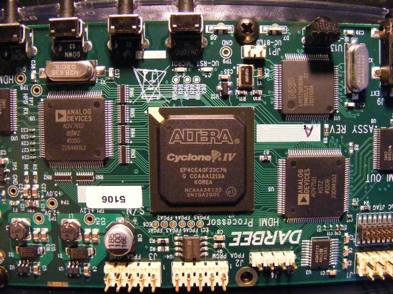

I Guess Im Hopen/reading into Craig post as in Seeing A Darblet could mean playing with one Laughing
From what I see under the hood The Darblet uses a design based upon the Altera Cyclone-IV FPGA
(field programmable gate arrays)
Its the Latest edition from the Cyclone FPGA Family simlar to whats used in the Radiance series VPs(cyclone
II)
Heres A closup pic (Super Macro) of the Darblets internals..
Cheers..
They have to use a chip with a lot of horsepower for their algorithm. Even with a dedicated GPU, reprogramming it at the firmware level only gets you to 1080i. (Which is an option they offer.) For 1080p you need the FPGA.
Thanks! That's interesting. I see they're using an LPC1756 as a control processor (32-bit ARM micro from NXP, in the Cortex-M3 family), which I've spent a fair amount of time programming.
Although it isnt field upgradeable & must be sent back to Darbee vision unfortunatly..
Sad, but true. I don't think they anticipated finding bugs or problems so quickly, and would only need to eventually do updates for feature adds or performance tweaks. So they didn't build anything in for field updates. They need direct access to the JTAG pins to reload at least the FPGA code, though the MCU has numerous comm channels it can be programmed over (if they had provided an interface to any of them).
II)
Cheers..
That chip I'm not familiar with, but I have been working on similar circuits where the chip is "Flashed" right in the circuit using one of several windows software programs and a serial connector to the board. That board seems to also show a very similar program connector.
This is from the manual of one of the software's that I mentioned.
NXP Semiconductors produce a range of Microcontrollers that feature both on-chip Flash
memory and the ability to be reprogrammed using In-System Programming technology
Flash Magic is Windows software from the Embedded Systems Academy that allows easy
access to all the ISP features provided by the devices. These features include:
· Erasing the Flash memory (individual blocks or the whole device)
· Programming the Flash memory
· Modifying the Boot Vector and Status Byte
· Reading Flash memory
· Performing a blank check on a section of Flash memory
· Reading the signature bytes
· Reading and writing the security bits
· Direct load of a new baud rate (high speed communications)
· Sending commands to place device in Bootloader mode
This method of programming requires an interface board that connects to the PC using RS232. It then has a five wire mini connector that attaches to programmed board. the five wires are:
Ground
Send
Receive
Reset
B+

This stuff can be made with a simple plugin on PC (plugin for Media Player HT for example).
Since it would requiere a HTPC/PC, they decided to make into a simple device.
However it has a *HUGE* fail design = NO upgradeability!
Those Analog Devices are just receiver & transmitter.
Lupin3
Joined: 29 Nov 2008
Posts: 24
Posted: Fri Jul 20, 2012 4:19 pm    Post subject:
ADV7612 (US$ 6.77):
http://www.analog.com/en/audiovideo-products/analoghdmidvi-interfaces/adv7612/products/product.html
ADV7511 (US$ 8.02):
http://www.analog.com/en/audiovideo-products/analoghdmidvi-interfaces/adv7511/products/product.html
ALTERA Cyclone IV EP4CE40F23C7N (US$ 82.96): < super expensive!
http://www.altera.com/devices/fpga/cyclone-iv/cyiv-index.jsp
NXP LPC1756FBD80 (US$ 7.90):
http://www.nxp.com/products/microcontrollers/cortex_m3/lpc1700/LPC1756FBD80.html
The rest are just resistors, capacitors, a IR sensor, clocks, switchers and PCB itself: estimative $50
Grand total: $155.65
Profit: $100 (at least), not bad.
But selling a plugin for $50, they would profit MUCH MORE.
