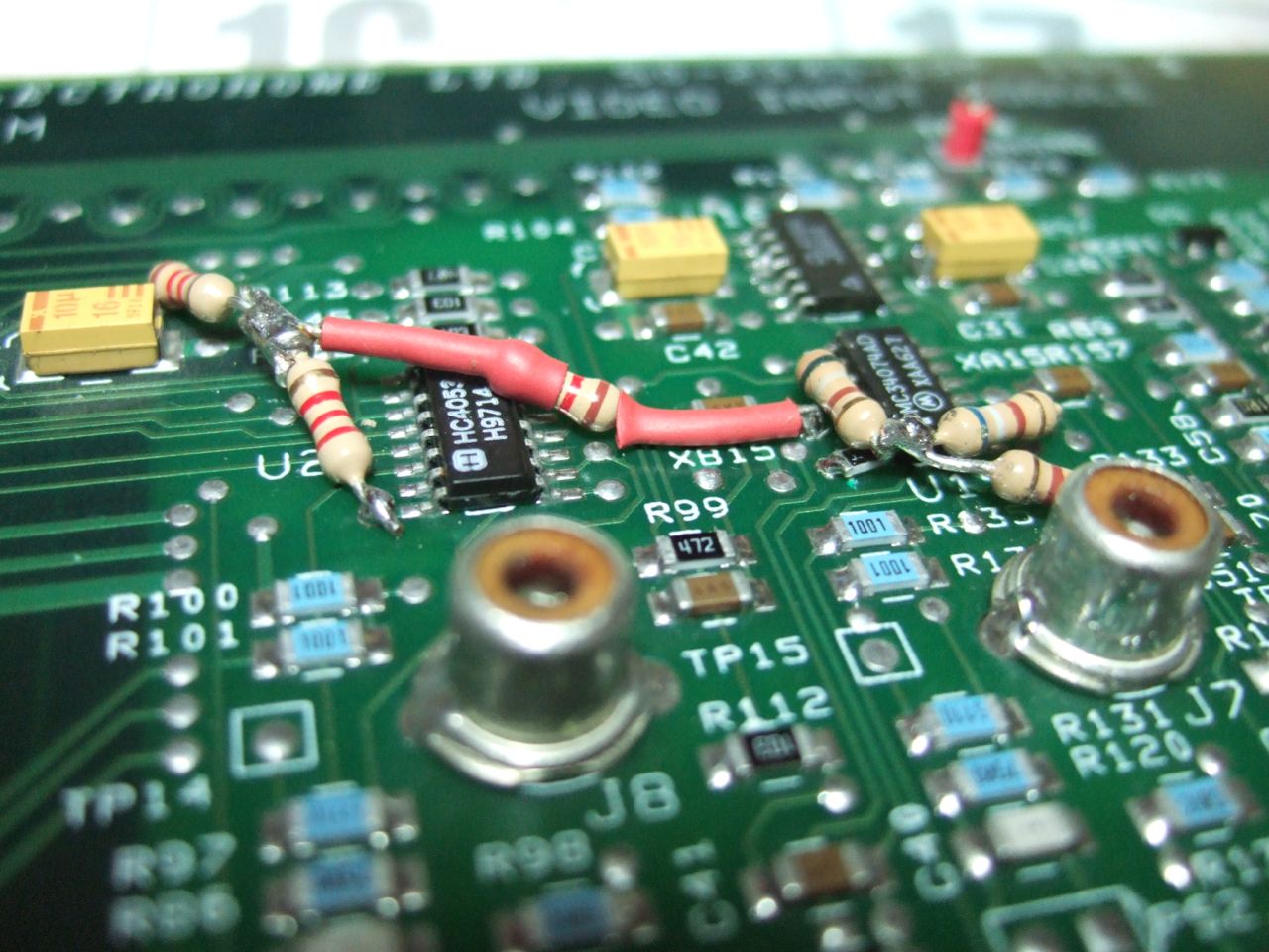

barclay66 wrote:
The Yellow wire is the 2.5 volt volume reference I assume.
Exactly. It's the output of the D/A converter.
And the top of R5 is the VDD correct?
Nope. VDD (+5V) is at the bottom of R1 (pin 16 of the HC4053). R5 is one of the three 680K resistors (see schematic).
Regards,
barclay66
Oops yeah I meant R1 but i still got the wrong end. So the top of R1 and bottom of R2 are connected along with R3 but are they connected to the board at that junction? It looks as iff there is a solder through point under that spot.

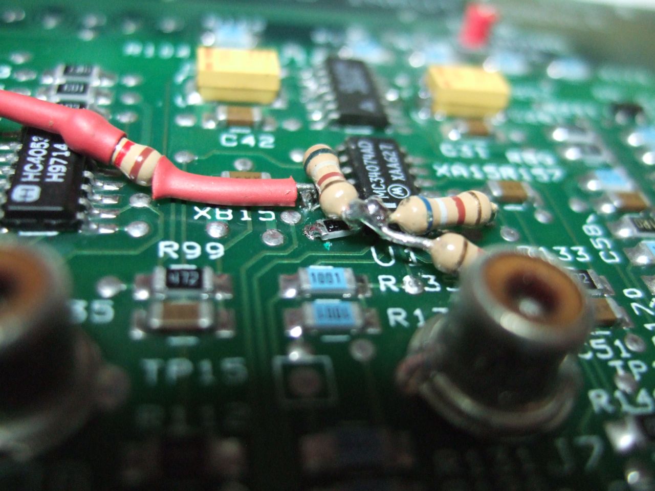

Posted: Tue May 07, 2013 4:04 pm    Post subject:
The connection between R1/R2/R3 isn't connected to anything else. It isn't touching the board...
Posted: Tue May 07, 2013 4:15 pm    Post subject:
Thanks. If I use large resitors I might have to put some isolation under that point.
I will also cut the ground point under the board for pin 12 and then run the 2.5 volt line on the under side, its three very thin pints to the ground, It will keep the top a bit cleaner looking .
A smd resistor from 13 to 14 will also work by cutting the trace to 13 and adding the SMD from pin 13 to the through solder point, Unless I have a 403 size resistor it would fit right between pins. I think all mine are 1206 and 803 size.
Posted: Fri May 10, 2013 3:49 am    Post subject:
Ok I tried the mod with not exact resistor values. I got the adjustment to work but the line remained and it also would crush the top white IRE patterns on the internal pattern.
So I ask are the values that specific? on the 1.1K the ones I used measured 1.175k and the 680ohm where about 640.
the 2,2 was closer and the 3.3k I used a SMD chip resitor that was perfect value.

Posted: Fri May 10, 2013 5:45 am    Post subject:
R5/R6/R7 are 680K (680 Kiloohms), not 680 ohms.
If the other resistors are off You might get a different adjustment range and/or the neutral setting isnt't at 50% volume as intended.

Posted: Fri May 10, 2013 3:58 pm    Post subject:
Regards,
barclay66
OH Crap!!!! I read the post wrong !!!
Doh!!!!!
Embarassed
Posted: Sat May 11, 2013 2:03 am    Post subject:
Radio Shack did not have the right value so Digikey to the rescue. I ordered 1% metal film 1/4 waters to do the job right.
I'll still use the 3.3k SMD 805 size. That worked out nice as I just cut the trace of pin 14 and then put the resistor from the pin to the through solder point that pin 13 also goes to.
Lets see how it goes once I get other resistors in in.
