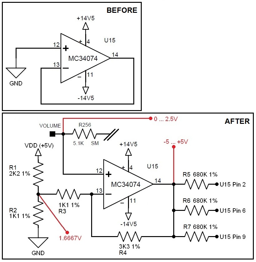

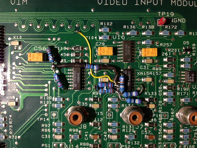

Posted: Tue May 07, 2013 9:46 am    Post subject: VIM Mod
I made it!
The mod only needs seven resistors and is controllable via the volume control on the remote (setting is saved per predefined channel in the channel list). Please see the attached schematic and the picture of my result. I know, it's not a beauty, but I was interested in its functionality first.
The mod takes advantage of the unused OP-Amp inside U15 and delivers its controllable voltages to U15 (what a coincidence!). As the D/A converter for the volume voltage (U10, delivers 0 ... 2.5V) is nearby, everything can be built around U15. Make sure to cut the traces at pins 12/13/14 first!
The OP-Amp is used as a voltage level shifter. R1/R2 determine the bias and R4 determines the gain. Using a OP-Amp calculator I determined that with a gain of 4 and the bias voltage of 1.6667V I could "convert" the input voltage of 0 ... 2.5V to the desired -5 ... +5V.
Of course the calculator assumes an ideal OP-Amp and the result was more like -3.9 ... +3.9V. Playing around carefully with the values of the above mentioned resistors should make the full swing possible (if necessary).
A look at the board picture reveals that I didn't have a 3K3 resistor at hand. Therefore You can see 2K2 and 1K1 in series.

Posted: Tue May 07, 2013 10:55 am    Post subject:
GREAT JOB..Thumbs Up
..and using that fourth OP amp in U15 was pure genius.
Posted: Tue May 07, 2013 12:59 pm    Post subject:
Cool, Jorge. I'll have to try it. I have tons of SMD resistors I might be able to use with some fly wires etc.
The Yellow wire is the 2.5 volt volume reference I assume.
And the top of R5 is the VDD correct?
Posted: Tue May 07, 2013 2:21 pm    Post subject:
That looks nice.. Thumbs Up

Posted: Tue May 07, 2013 2:51 pm    Post subject:
Exactly. It's the output of the D/A converter.
Nope. VDD (+5V) is at the bottom of R1 (pin 16 of the HC4053). R5 is one of the three 680K resistors (see schematic).

Thank You!
I knew I would be needing an OP-Amp for the voltage shift. So I first looked at the last page of the schematics where the unused components are and this was the best solution. I could have chosen for an unused OP-Amp of a CLC415, but hey, this isn't a design where we need bandwith Wink
