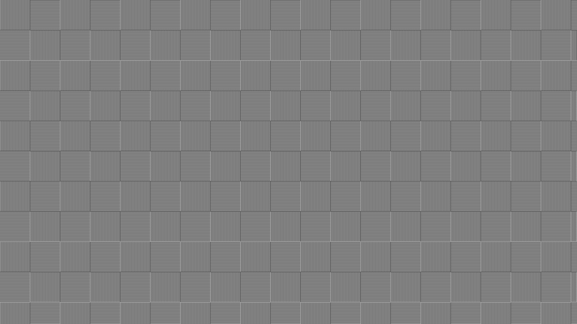

here is a testpattern in case you didn`t have this already, i used for tweaking astig.
with this pattern you can instantly see what the horizontal and vertical 1on 1off lines do.
Thank you. I got the E-mail they look great!
