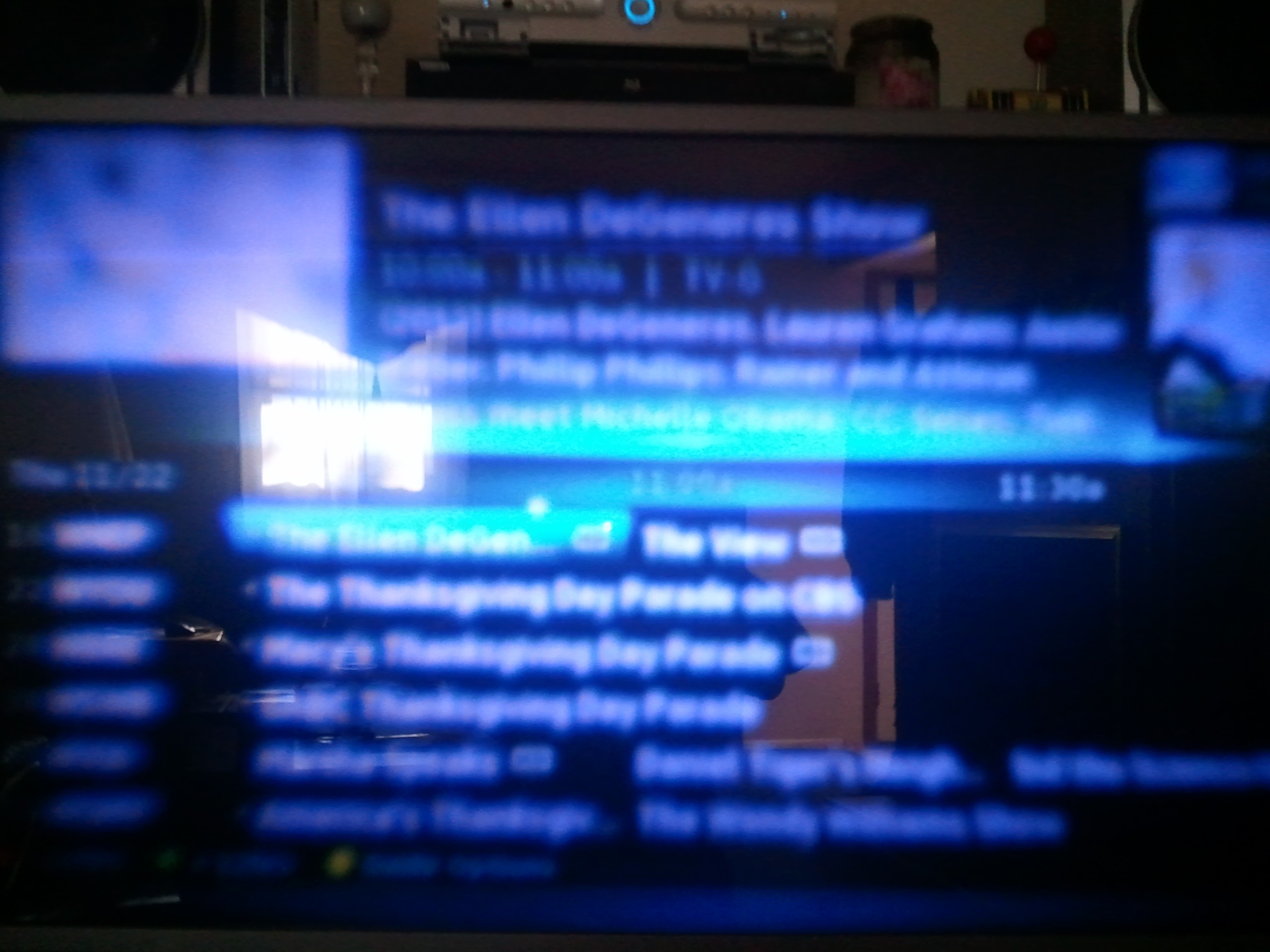

I have the same focus problem. I bought the TV over a year ago and it worked fine up until a few months ago. I thought it may be dust or something with the mirrors/lenses. Anyway I have been trying to focus it for a few months different ways not knowing anything about this TV or it's issues. Also I wanted to mention that I don't have the green grid to adjust only the white, red, and blue but no green. My focus problem is mostly on the other edges and corners not the middle. I can hardly read my guide because of the blur. Anyway anything I should check besides what's mentioned in this post?

Post a picture of the white test pattern. I'm guessing you have convergence, not focus issues.

Posted: Sat Nov 24, 2012 1:53 pm    Post subject:
I don't know if the pictures will post but I'm trying.
 Filename:  WP_001450.jpg

Posted: Sat Nov 24, 2012 1:57 pm    Post subject:
This is the one I wanted to post.

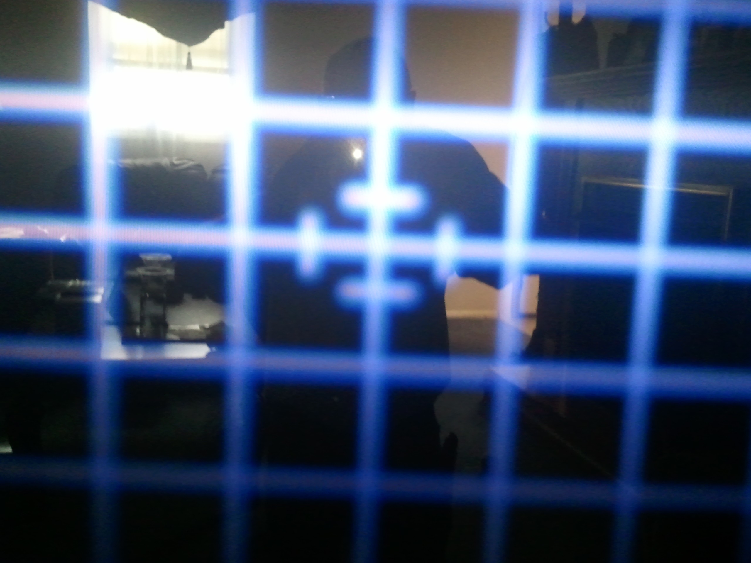

Posted: Sat Nov 24, 2012 2:10 pm    Post subject:
It didn't fit. Let me try another one. Does this one help.
 Filename:  WP_001449.jpg
 Filesize:  451.18 KB
 Downloaded:  7 Time(s)
Posted: Sat Nov 24, 2012 3:32 pm    Post subject:
OK, definitely a focus issue over a convergence issue. A lot of people get those two confused.
Somewhere in the set should be a focus adjustment block. Usually there are 6 controls on it. Three are for master brightness, and three are for focus. There should be a relatively thick wire from each CRT tube socket running to the focus block.
Adjust each focus control on each tube for best focus.
Careful though, there's 5000 volts sitting behind those controls. Use rubber gloves if you're not used to doing this.
The control block may be accessible via the front of the set, under the speaker cover usually, or by taking off the back. Usually you need to pop off the front.
