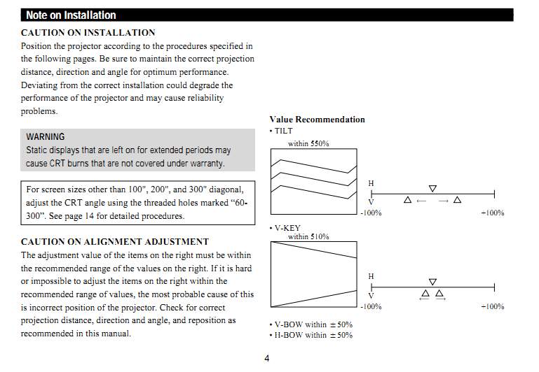

Posted: Wed Feb 08, 2012 7:03 am    Post subject:
Actually you CAN do it, but on what price?
Note from NEC PG manual
 Filesize:  52.76 KB
 Viewed:  3506 Time(s)
Posted: Wed Feb 08, 2012 5:33 pm    Post subject:
That remind's me of the guy that tried putting his Ampro in the corner of the room and tried to project it onto the screen. Didn't work so well.
While you CAN off set a projector I find it's easier not to. Any time you max a setting to correct for the offset you are putting more stress on the electronics.
Posted: Wed Feb 08, 2012 5:54 pm    Post subject:
this price. Rather expensive IMO
Without trying to make fun of one of my customers, here’s what can happen when you install a CRT projector about 20% too far back from the recommended screen distance. You get insanely premature tube wear as shown below. The raster was not centered, the image is far too high on the tube face which can cause convergence instability over time, and the wear shown should happen towards the end of the tube life, not two years after the set was installed.
Remember to read the throw distance charts in the manuals, most of them are darn accurate!

That isnt from offset so much as it is from plain bad raster setup or bright part of the image way under size.
