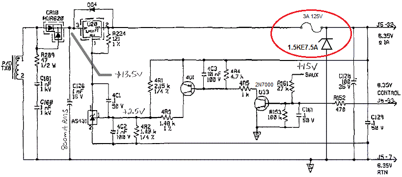

For those with "Filament Voltage Paranoia" on their Marquees:
You might want to add the two parts highlighted in the modified schematic.
If the regulator IC shortens between input and output or if the regulator circuit fails and the output voltage raises above normal, the suppressor diode will draw a large current and the fuse will blow, thus protecting the tubes.
The fuse value may need to be adapted to the real current draw of the three filaments. As for now it's just a suggested value.
The suppressor diode value may too be changed to 6.8V. I chose 7.5V because the diodes with the suffix "A" have a tolerance of 5% and 6.8V-0.34V=6.46V seemed to me being too close to the operating value of 6.35V...

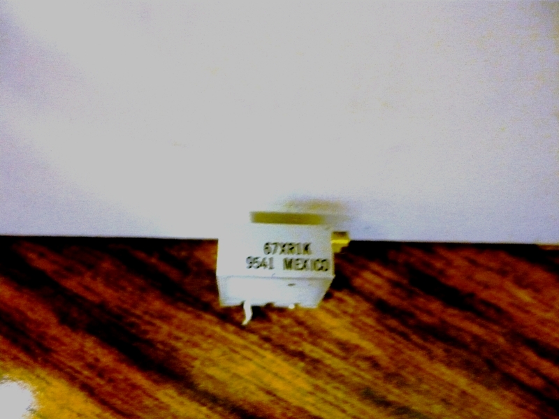

the only machines with burned out tubes had one of these installed. The ones with the blue pot were all fine

Posted: Fri Nov 18, 2011 9:30 pm    Post subject:
draganm wrote:
tse wrote:
How such a simple thing got so screwed up in the Marquee is a mystery to me.
Scott
I don't know if that's true. I think Greg Eisemann said the opposite, and I'm pretty sure I've had both gray and blue pots be bad. I always change them regardless.
