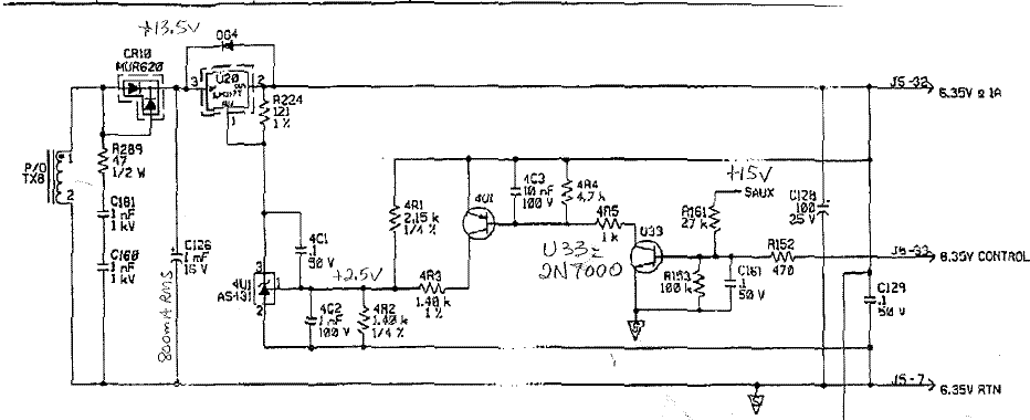

It looks like the later Maquee LVPS didn't use a pot to set the filament voltage. The regulator has about 13.5V applied so worst case regulator short could put that much on the CRT heater. That couldn't be good.
Scott
I could think of a couple reasons why its bad and I may have had one some years back. But I want to check my notes to see if my issue was from this circuit. I'll be back there in a week. I know the problem part was on a horz board but was not a horz issue.
That Marquee image is the one I was referring to in my earlier post.

The filament rail is floating coming out of the LVPS. It then connects to the horizontal winding of the deflection yokes. The DC voltage applied to the h winding goes from about 20V to over 200V over the sweep range 15-105kHz. That means the filaments in the CRTs can be referenced 20 to 200V above ground. The CRT spec allows the cathode to be something like 300V more positive than the filaments but 0V negative relative to the filaments. That can be violated at the highest sweep rates. One (of many) good reasons not to run an Ampro above 80 or 90kHz.
Scott
Wow, didn't see that until looking at the horz out diagram. Also, a short failure of CR1 on the horz power board and the horz winding is tied directly to the filament supply......and heater.... Shocked
