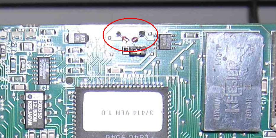

That CPU board also has the +/_ 25v error fix on it.
It has a what? its annoying when you guys can see all these things and I am just seeing a CPU board lol! I guess the other little stickers mean certain have there own versions and updates which mean something.

Posted: Thu Sep 29, 2011 1:32 am    Post subject: eh
its a what Chip? what does it have that its so confused?

Posted: Thu Sep 29, 2011 7:25 am    Post subject:
Ok, I am not an AmPro guy but looking closely at the first picture I see a broken diode, I don't think it is a factory tweak... correct me if I'm wrong
broken diode?

Posted: Thu Sep 29, 2011 2:57 pm    Post subject:
Its hard to tell from the flash on that image if it actually broken. If you look at the solder joints and the direction of the leeds it would indicate it was installed like that.
Regardless, that is a zener diode from the battery to the controller chip. If it is broken then the CPU would loose its memory when unplugged.

The 81437 card is a CPU from a 4600E.

I came up with 4600i. Where did you get the E? Of course, whats the difference? Laughing

Posted: Thu Sep 29, 2011 8:06 pm    Post subject: eh
where are you guys gettings any of this lol! 4600e 4600i ?! I have read a lot of threads on AMpros and never come accross this. Its really interesting stuff, I am going to null the intensity settings Ron then get back to you. I wish I got the other cards now, the back of the cpu card does not seem to have 4 welded points?(the silver bits at the back of cards where I assume the fiode or whatever is welded) for the diode so I think the diode is broken, maybe Scott would know for sure.
