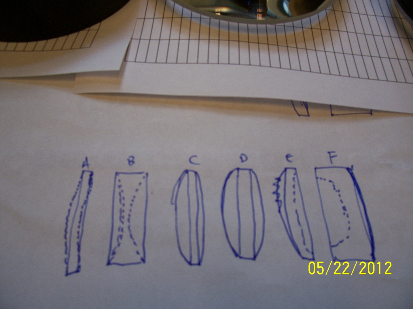

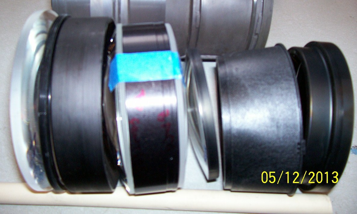

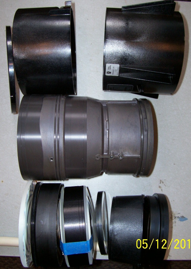

Two summers ago I had a little fun and tore apart a HD6C lens. I thought I'd posted pictures of these but didn't find it real quickly. Apologies if I'm re-posting. Here are a few of the pics, just for fun. About a half-dozen individual lenses of complex geometries going into one assembly -- crazy stuff. If someone liked optics, I'm sure some of the free ray tracing packages would let you reconstruct the light path for at least a single given wavelength, at least.
Matt
outside case at top, internal lens retainer/spacing tube, the lenses themselves, roughly in order/spacing as if installed
rough sketches of the crazy shapes these things are
lenses without spacers/body they go inside

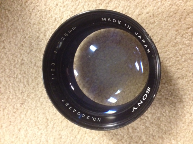

Greetings guys
I have one Sony projector lens and would like to know if you could help me find the right projector it came from?
