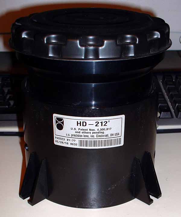

HD-212 from a Retro 708s, same mounting as HD6
(can't this thread be made a sticky Question )
