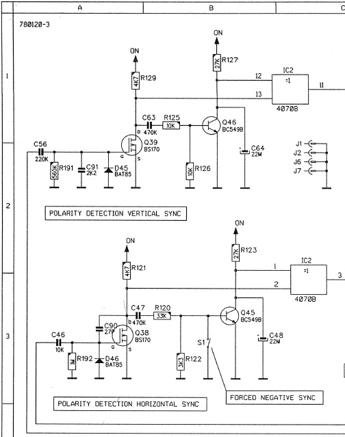

there is a sync processing circuit installed on the Barco. It is to be found on the second RGB input board (R7620155) which is the board that input 3 is connected to. Therefore it works for you on input 3 but not on inputs 4/5.
Please see the excerpt from the service manual below.
Initially I was using input 3 too. As I don't use any scaler (3 sources: BluRay Player set to 1080i / HD Cable Receiver set to 1080i / Computer set to 1280x1024, all connected to HDFury III through HDMI switcher) I experienced sync issues quite often. These were resolved entirely when I set the HDFury to forced negative sync and connected it to input 5 (RGBs). The picture quality improved quite a bit, especially sharpness was improved. I did a little analysis of the schematics and it seems that using inputs 4/5 you will have one video processing stage less within the video chain. So this is one stage less where bandwith and signal quality could be affected.
I then was able to remove the second RGB input board which would reduce the load on the SMPS (switch mode power supply) and let the projector run a little bit cooler...
