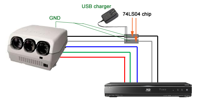

Tom.W wrote:
Here is a good initial setup article.
http://moesrealm.com/home-theater/guides/crt-projector-focus-mechanical-aim-basics/
Sync conversion circuit...
http://www.twobits.com/sync.html
Tom,
Is this correct? I'll be using usb charger to pull +5 volts.
I didn't include the HDFury anymore but it will be in the chain.
 Filesize:  62.59 KB
 Viewed:  9703 Time(s)

Tom,
The part of the Barco 808 will be played by a Sony D50 today Laughing

Posted: Thu Jul 21, 2011 4:13 pm    Post subject:
v1rtu0s1ty wrote:
Tom.W,
Did you see my question earlier?
If you are asking about the 5 volt USB power supply that should work just fine. I have both Kim's transcoder with gamma boost but I also have the Gamma X and I find the slider control far more handy then the small recessed slotted screw adjustment located at the rear which in my case is hard to get to.

Posted: Fri Jul 22, 2011 6:03 am    Post subject:
Tom.W wrote:
v1rtu0s1ty wrote:
Tom.W,
Yes, it was the usb power supply. I learned that it has 2 wires. Everything is cleared now! Smile

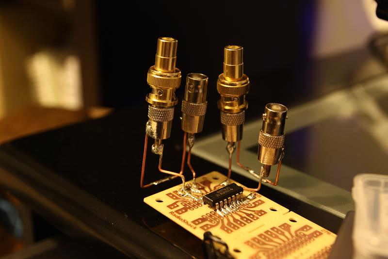

v1rtu0s1ty
Joined: 29 Oct 2007
Posts: 110
Posted: Tue Jul 26, 2011 7:43 am    Post subject:
Tom.W,
It worked!!!!!! Smile

Posted: Tue Jul 26, 2011 10:35 am    Post subject:
I'm unsure if it should be declared "Art" or "Technology".
Like Ash in the movie Alien said: " I admire its purity. A survivor... unclouded by conscience, remorse, or delusions of morality."
You might consider soldering a ceramic cap (0.1µF) across the power supply pins of the IC...
Regards,
barclay66

Posted: Tue Jul 26, 2011 1:23 pm    Post subject:
barclay66,
Ok, I will search about ceramic cap since I'm not familiar with it. I would like to redo it because the copper on the radioshack pc board detaches so easily. I need to find another board solution.
Thanks! Smile
barclay66
Joined: 27 Jun 2011
Posts: 1304
Posted: Tue Jul 26, 2011 2:44 pm    Post subject:
I think the PCB you're using is just fine. It's just that normally the components go on the other side so that their pins go through the drilled holes and are then soldered to the PCB's copper traces. If you do that to the connectors too you will get much more mechanical stability. I'd bend those wires flat onto the traces where they would be soldered on...
Regards,
barclay66
