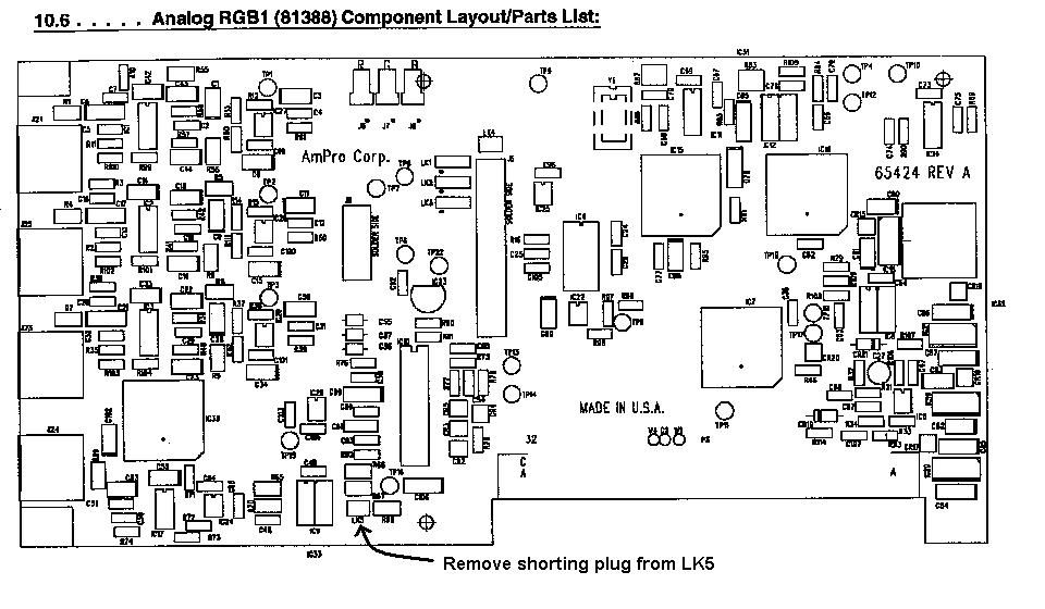

If I remember correctly Papalek says that Ampros need a stronger "hotter" signal, make sure your cable is good quality, as for the rolling I am sure Tse told me to remove a jumper but for the life of me I cannot remember it I will have a look, here you go, also check your battery you may set it up perfectly then find your battery needs replacing and there go your settings.
Scott stated:
“Many times vertical rolling can be fixed by removing the shorting plug from LK5 on the RGB bd. Attached is a .GIF showing the location of the plug. Hope this helps. If you pull the three video cables from the top of the bd make sure they are returned the same way they came off. There is a small dot designating one side.”
Good luck I am not the best person to be asking about all this but just trying to help out.
