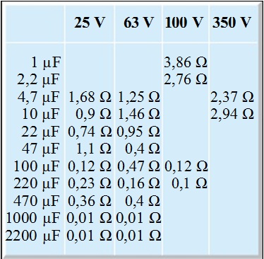

I think that measuring the ESR may not be an exact science. Depending on the meter type, the quality of the test leads and measurement methods the absolute values may vary. After all we're measuring in the range of miliohms. What can be determined (as you did) is an overall tendency and failure of single caps within a batch. What you can see in addition is that thicker caps provide less ESR than thin ones although they read the same capacitance/voltage specs.
In general I'd rather replace one more cap than waiting for its soon failure.
For your reference I've added an excerpt from my ESR meter's documentation which shows typical readings for different cap specs...
