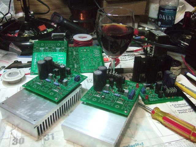

Well both radiance Supplies are done. With a little help from some red wine. Very Happy
EDIT: The latest build PS has been powering the Lumagen HDQ for an hour and 10 minutes and part of the heat sink right where the chip is mounted is at 50c. So far so good. The chip has a rating of 175c. So I hope this is ok. Well below the 80c I got on the other Heart sink after 30 minutes.

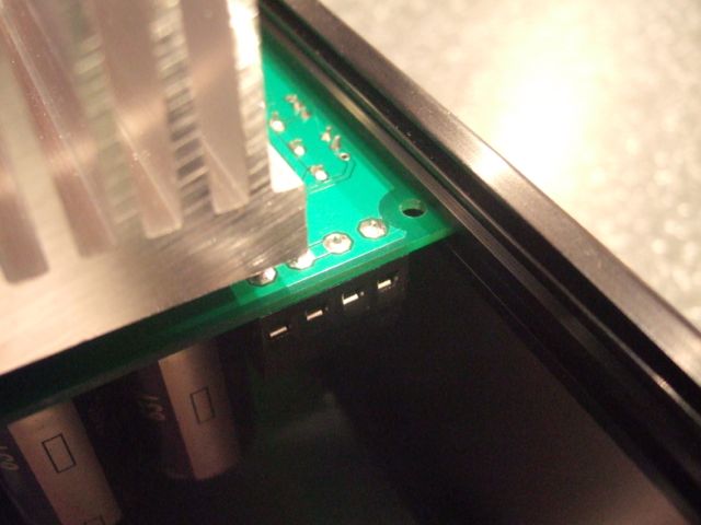

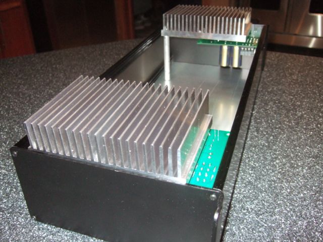

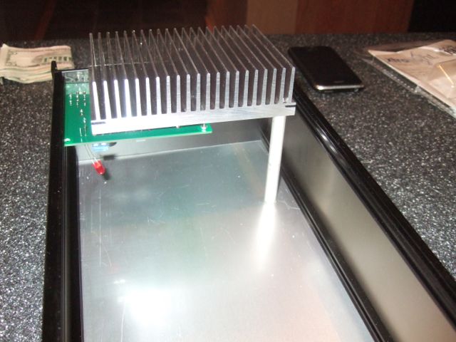

Ok here is how I plan to put these into the chassis. I want to drill two holes into the sides and into the heat sinks and mount one on each end of the chassis. The one end of the PCB board slides into the Slots of the corner members of the chaises. The other end of the heat sink will be also held up by a piece of aluminum Rod. I might actually get some more heat dissipation through the side of the chassis this way. The Transformer might fit under one of the boards but I think I might keep it in the middle to keep any Magnetic noise from the power supplies. There is not enough room to put a cover over the Xfrmr to shield it.
Then I will put the 12 volt power supplies for my TV ones in the middle. there should be enough room for the total of 4 PCB boards. those will have the On board heat sinks since they barely draw 1 amp.
I will have to cut the top to go around the heat sinks as it slides in at one end. You have to remove the ends to get the top off by sliding it out. So my plan is to mount the PS's except for the one on the end I need to remove to put the top on, and slide the top on and then put the side plate with the heat sink screwed to it with PS onto the chassis. then screw it down. Hopefully I wont have to open it up at all Wink
I think that should work and look nice. The heat sinks will come out the top so the heat will not affect the other PS's.
The wiring of the chassis will be another logistical issue I'll deal with after.
I am wondering if I should use metal cutting scissors or a metal saw for the top cuts. its thin Aluminum about 1mm thick. I will probably use some rubber gasket on the cut edges to butt up against the exposed heat sink. Or maybe try to cut slits on the ends of the heat sink that the top will touch so they actually slide into the heat sink. That will be a tough
work of precision to do tho.
But this is fun I have to say.
And who said for me to just use a PC power supply!?! Wink
Aluminum Support stand off
 Filesize:  53.05 KB
 Viewed:  15691 Time(s)
PCB in Chassis slot
 Filesize:  37.51 KB
One at each end
 Filesize:  63.08 KB

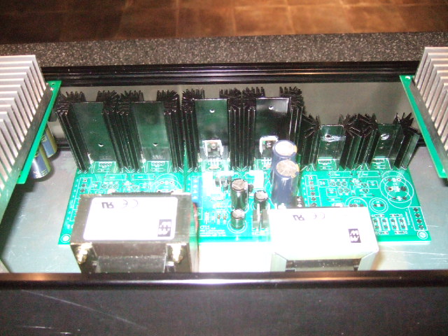

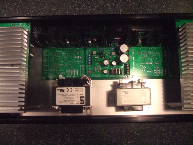

So I'm looking at layout options and I think I'm going to go this Route . My only concern is the Transformers and any magnetic fields they might produce placing metal near the plates seemed not to have any magnetism so I think Im ok. They absolutely have no Hum, These Harmonds are quiet .
So here are the temporary layout pics. All 5 power supplies.
I figure keeping the Transformers away from the mosfets( on the heat sinks) is the best way to go. And if there is noise I can easily flip the PCB's around.
 Filesize:  107.58 KB
 Viewed:  15668 Time(s)
 Filesize:  110.69 KB
 Filesize:  111.82 KB
Posted: Mon Mar 04, 2013 1:07 am    Post subject:
Why not put some copper sheets around the transformers to isolate and noise and shunt it to ground?
Posted: Mon Mar 04, 2013 1:14 am    Post subject:
I was thinking of something similar. I have some sheet metal and could build a wall around the Xfrmr's
and use the mount locations for the three PCB boards to secure it and then a few more screws from the front
panel.

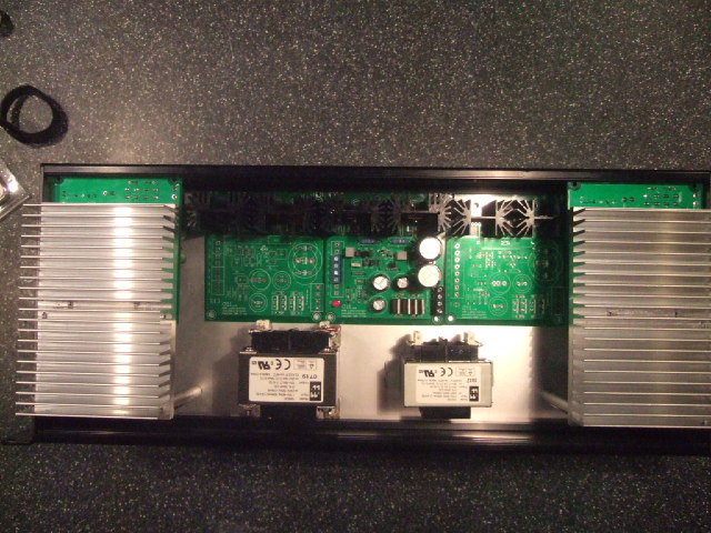

Posted: Fri Mar 15, 2013 3:41 am    Post subject:
Started to add the components. Cutting out the rectangular hole for the IEC plug/switch combo was a pain. I had to drill the entire perimeter of the template I made and then cut it out with a utility knife and file down the bumps.
But its coming along.
A few pics.
