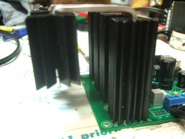

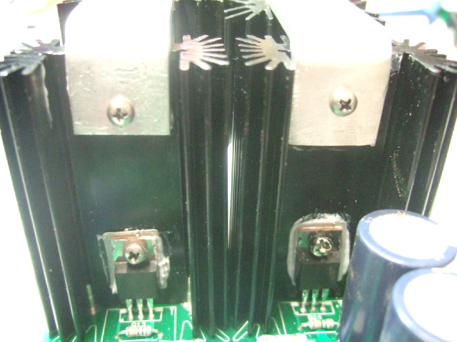

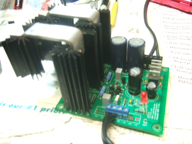

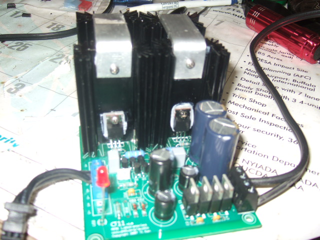

Posted: Tue Jan 29, 2013 5:24 pm    Post subject:
Here is one of the Sigma 11's I built so far. The on board heat sinks are not enough as they get really hot. A fan would help, but i decided to do some quick fabricating and add more heat dissipation. What I will do on the next one is go to a larger off board heat sink once I find one I think will fit in the chassis I plan to use.

Posted: Tue Jan 29, 2013 5:46 pm    Post subject:
I saw some on Ebay. But I might just cut up a Marquee rear heat sink and try that. I also have an older HDM i could use that as well. Cut the HDM sink in half for each Mosfett. I think its best to keep them separated with their own heat sink.

Posted: Tue Jan 29, 2013 6:25 pm    Post subject:
I'll check it out but I think I should have gone with a slightly smaller transformer secondary output.
FOr a 5 volt out it is suggested to use a 9 volt secondary. I got the Hammond 185E20, with a supposed 10v out.
Well mine measures 11.3. I have a slight high AC voltage here about 124-126. SO I bet a Hammond 185E16 would be better as it has a 8 volt out.
I ran the Power supply for an hour and it the heat sink sides are hot to the touch( the main board mounted sections).
It says the heat junction temp for that chip is high but Id rather have it run cooler. Might have to order the smaller Transformer.
Now I'll have this lying around!. Unless there is way I can lower its secondary output easily?
Posted: Wed Jan 30, 2013 10:56 pm    Post subject:
Well I bought an IR thermometer to test the heat off the IRLZ24 Mosfett
http://www.irf.com/product-info/datasheets/data/irlz24n.pdf
And heat sink. The Junction Temp says it can operate up to 175c !! Thats HOT.
I measured the heat sink just above the chip and the chip it self and the range was from 45c-75c
So I think I'm Good. On my next Board I'll measure temp with out
the added Aluminum Bridge to the other heat sink and see how it fares.
I'm Running an HDQ right now on this. Dont want to blow up a radiance!
Posted: Thu Jan 31, 2013 11:12 pm    Post subject:
Thinking this over and The Guys at AMB.org say its still too hot.
So I went to the site you linked Heatsink USA and ordere two of these.
http://www.heatsinkusa.com/5-375-wide-extruded-aluminum-heatsink/
Product Description
Extruded Aluminum Heatsink
Width: 5.375"
Fin Height: 1"
Base: .375"
C/W/3": approximately 1.15
Weight per Inch: .37
The C/W is for 3" of the heat sink. The original heat sink was 21k sqr mm's about.
this will have over 93k sqr mm's if my calculations are correct for 3.5" length of it.
I plan to mount the Mosfet's on the under side of the PCB and mount them to the heat sink that way.
I'll face the heat sink fin up and the board will be upside down in the Chassis on tall stand offs.
Here you can see the bottom mount method
Both mosfet's will be connected to the single heat sink but since the area is almost 4 times larger I should still get better
cooling.
What do you think?

Posted: Thu Jan 31, 2013 11:27 pm    Post subject:
I can't see a problem with mounting them in the manner you describe. You could always add a fan to blow across them should you still have an issue. I think it would be better actually then to mount vertically. The heat sink in my mind should cool more uniformly versus being mounted vertically. That is just my logic though and I have not tested or played with it other then knowing a car amplifier with fins gets way hotter mounted vertical then if mounted flat.

Posted: Thu Jan 31, 2013 11:33 pm    Post subject:
James
Right the fins will be facing up as in the diagram of the heat sink itself.
The bottom of the board will be mounted to the bottom of the heat sink.
The populated parts on the board will be facing down, and the mosfet's
wil be mounted on the underside of the PCB and then to thermally attached to
the bottom of the heat sink. I have to get an aluminum Grate now for the top
